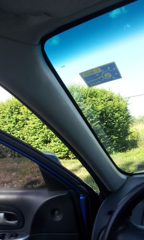

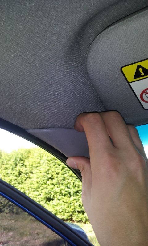

Here we have your garden variety A-pillar. Very common in nature, and very tame-able.

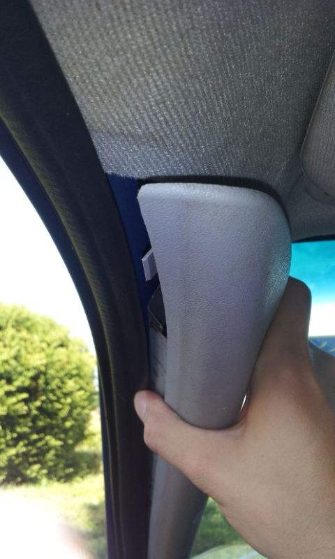

First, wedge your fingers underneath the top edge. Don't pull too hard, just get a good grip on it.
It's quite possible just doing that will pull the top wedge out, which is just fine. If not, pull gently but firmly towards the passenger-side A-pillar until it pops free.

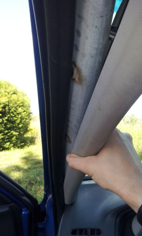

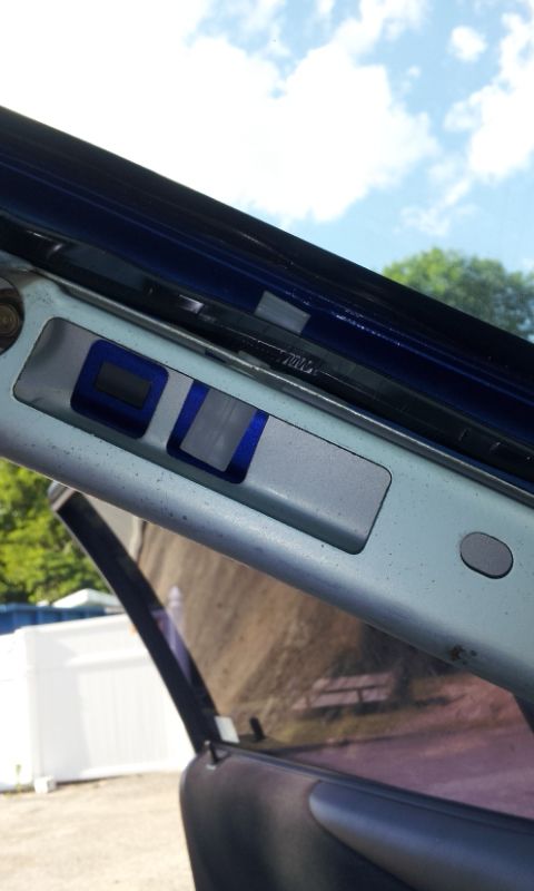

Make sure to get this little guy free of the rubber weatherstripping. You can see the metal piece that supports the A-pillar, but it doesn't actually snap into place in that piece of metal.
Once the top wedge pops free, work your way down the pillar, pulling to the passenger side, parallel to the windshield.
You might need to wiggle it a little but they should just pop free.

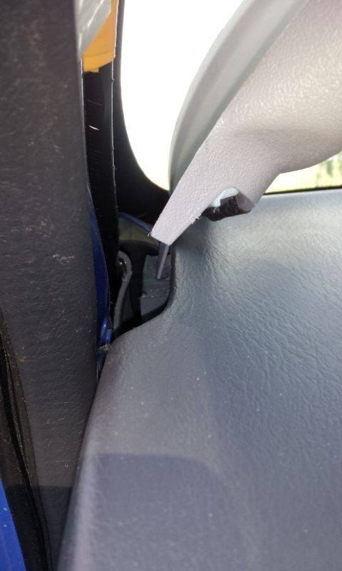

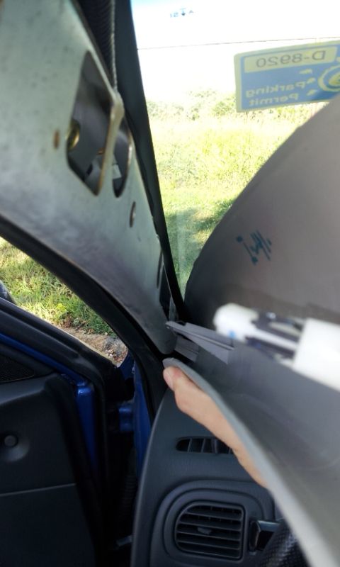

Don't forget about this plastic tab at the edge of the dashboard.

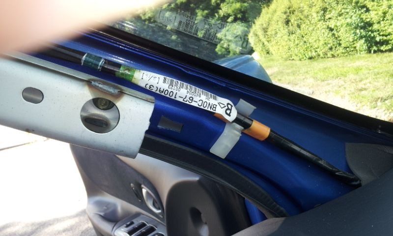

When you're reinstalling, look for these openings where the wedges should line up and pop right back into place - don't forget that plastic tab at the bottom end.
The square one mid-shot.

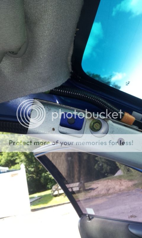

The square one, left-center. The steering wheel was getting in the way, I couldn't get a good shot.
And the round one mid-shot.
Here, here, and here.

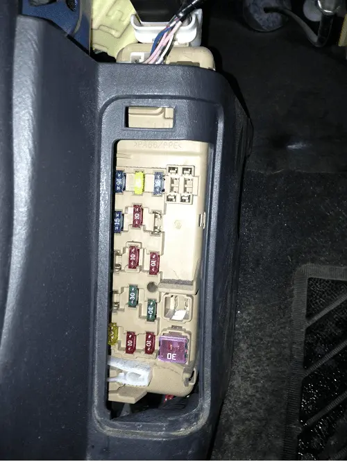

On a side note, since I don't know much about electrical stuff, I'm hoping one of you guys can help out. Like I said in my first post I'm installing a fake LED car alarm. I need to install it to a constant 12v power source (so when the car is turned off, the light blinks, when the car is on, the light turns off). I took a pic of my fusebox just under the dash if it helps. So in other words, where do I plug in my wires (constant 12v)?
