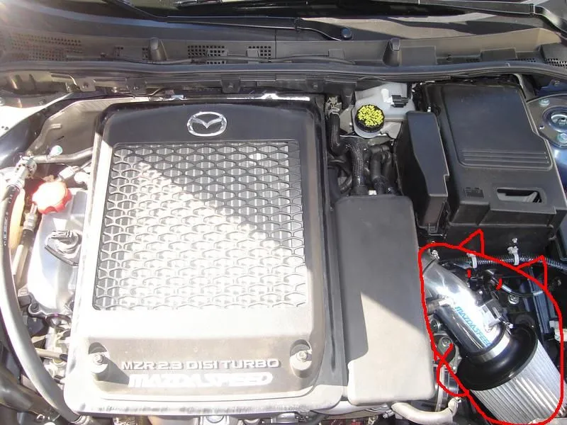

You should get this set up. Like me. It sounds awsome!!!!!! When driving down the streets people will turn their heads and look at your car like if someting were wrong with it.

LOL I love the face you made out of the circle. Forgive my n00bness - is that mounted differently than it should be?? Thats the MS CAI, right?
Its the MS CAI but without the lower pipe attached. I ran mine like that for a bit.
