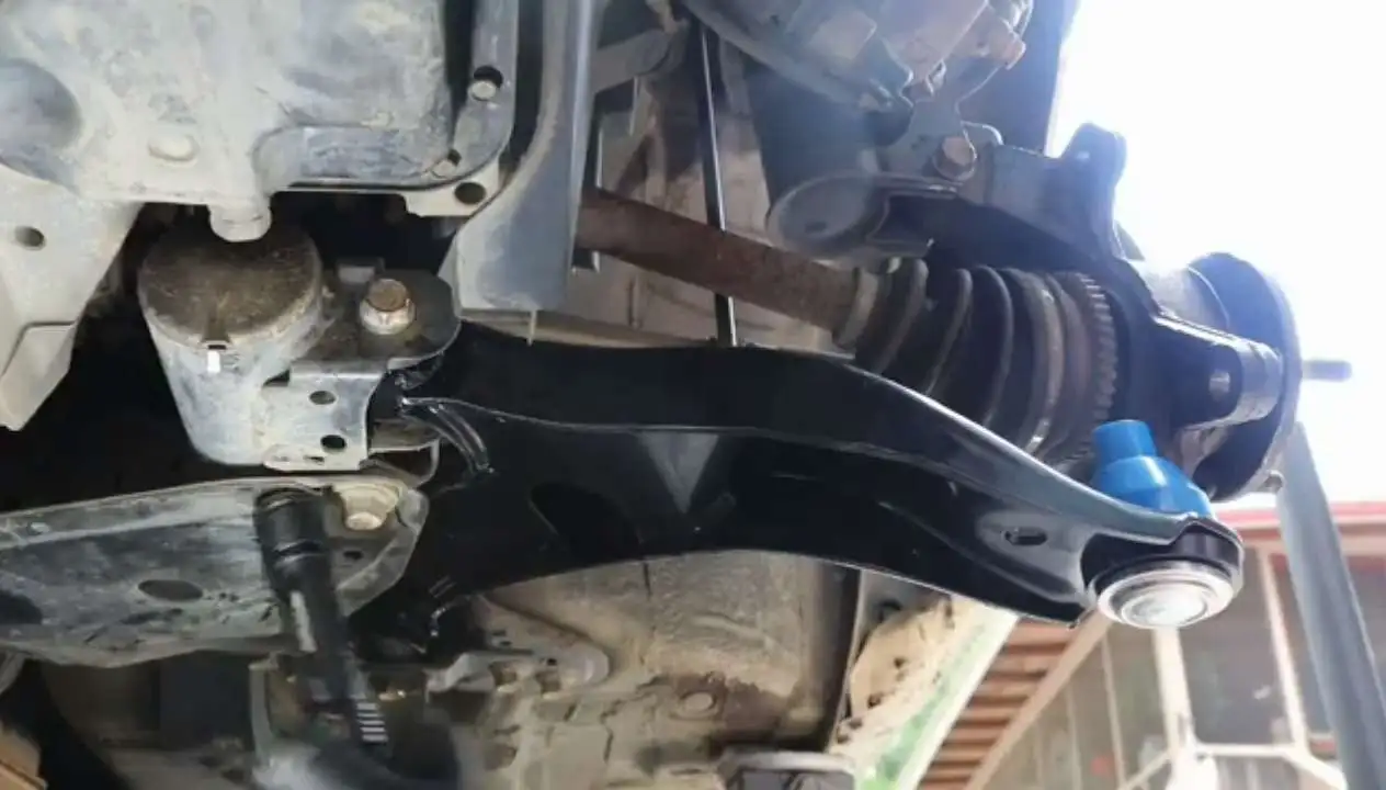

Removing your brake caliper allows you to raise the control arm to line up the bolt without compressing your suspension,..

As for control arms, I did them for the first time on my P5 and have now done them a second time. They aren't too bad. I think I needed a pickle fork for removing the ball joint where it was mounted to the knuckle, and I did compress the suspension with a floor jack to get everything to line up.
Yeah, so did I.
It wasn't until after that I watched that video that I realized that if you remove the brake caliper, you can raise the control arm without hitting anything, so you can line up that bolt.

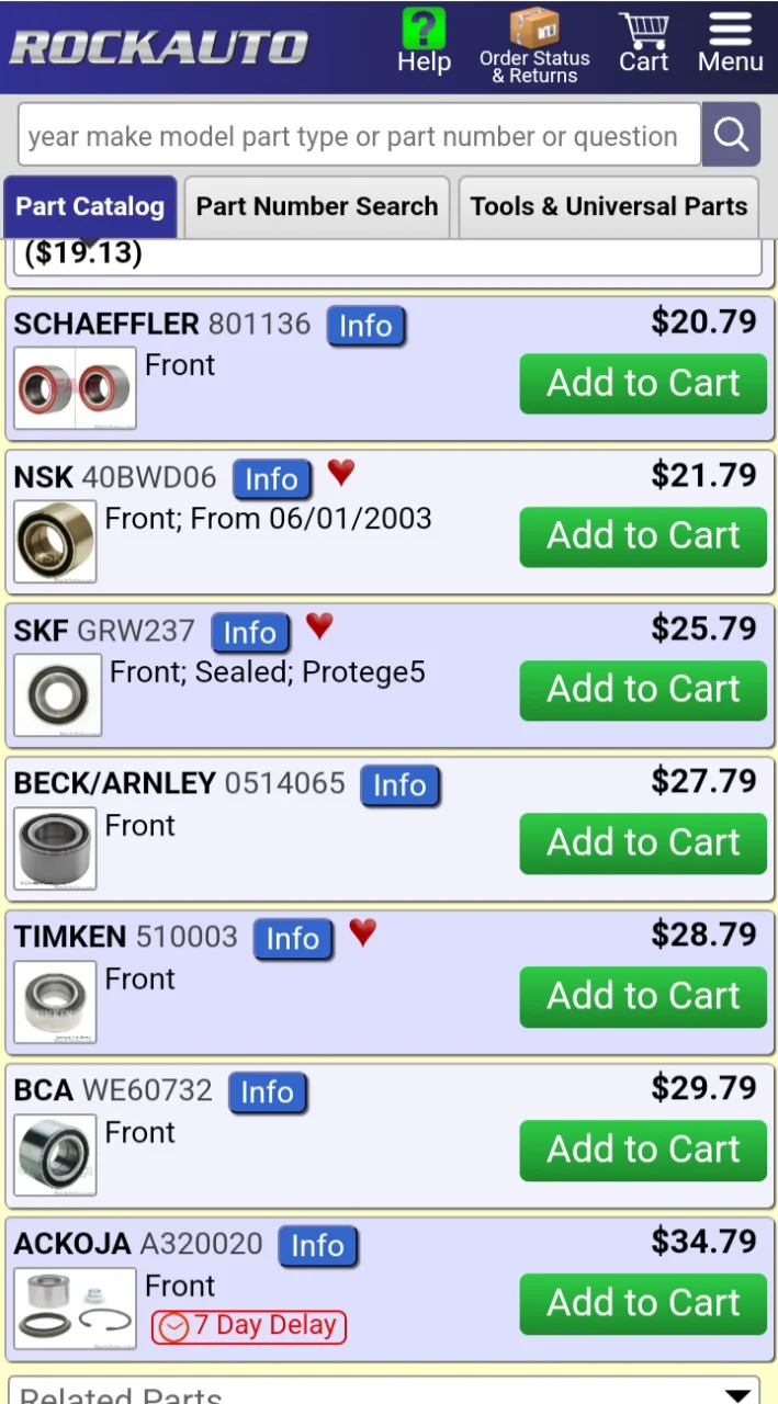

Make sure that you buy a quality wheel bearing that is properly sealed.
I know SKF is supposed to be good and maybe Timkin?
Check their links to make sure the seals are real.
SKF says "sealed" right in their ad,..

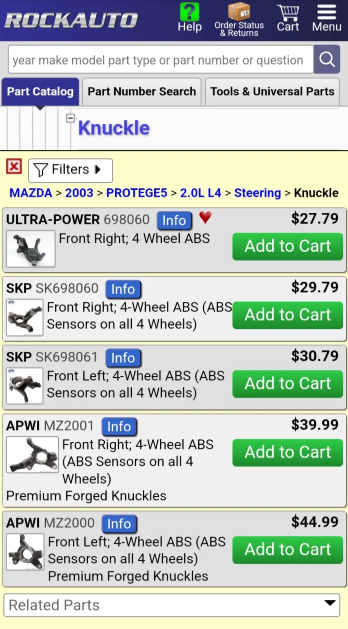

So... parts needed... If I don't want to press anything out
Wheel bearing (sealed)
Wheel Hub
Snap Ring
Knuckle
But... I have ABS on this car (yup a fancy model). Where is the ABS sensor? Is it inside the knuckle? If so... it may be more of a PITA to get out then the bearing out of the knuckle.

Yeah, if you replace the knuckle then everything should be really easy to replace and install.
(This is CAD, it's cheaper in USD)
