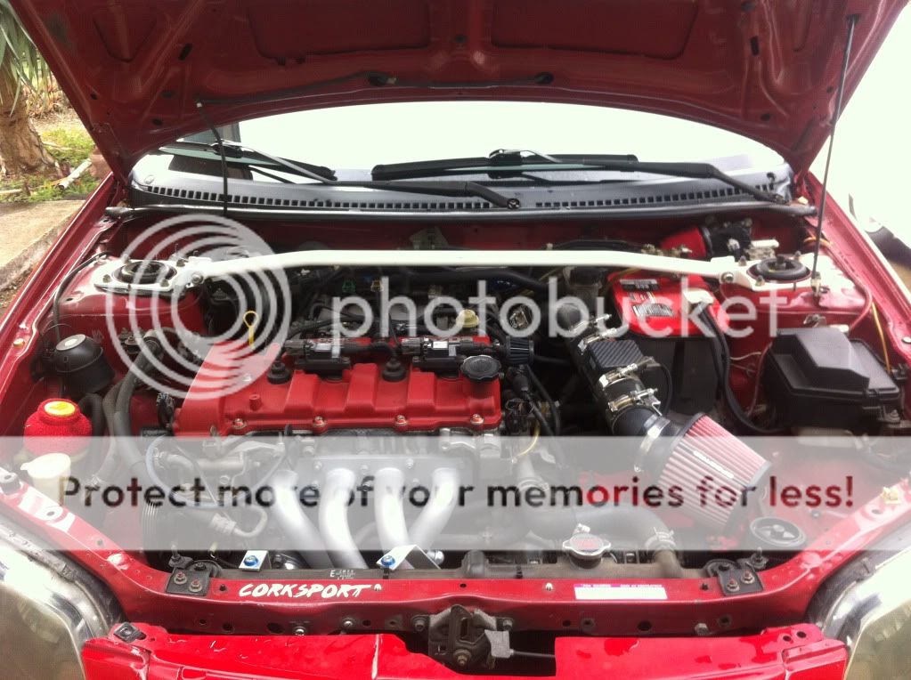

As it sits.
Next pics wont be posted till turbo time. =)
