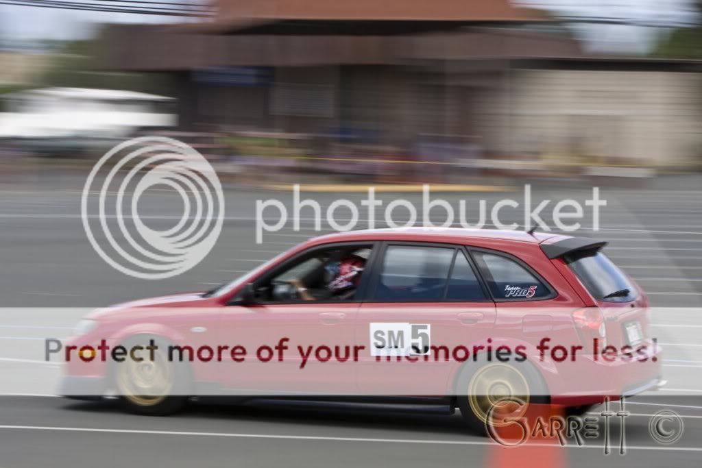

Hmm. So I got to hit up the Dyno today and get a proper tune. Pushing 160hp... But im only boosting 4psi. I gotta find out wth is going on. The SC is rated for 7psi. =(
Although I feel a big difference from the tune it self. It does feel good. Im going to post up the dyno sheets on friday. (I dont have a scanner..=)
Here are some pics for now.
