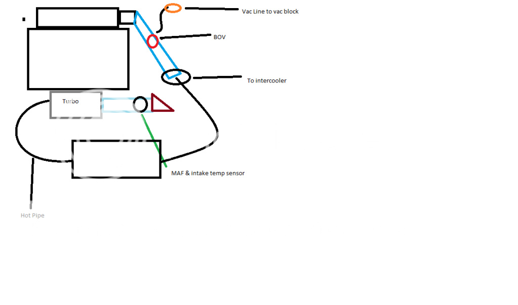

Trying to get a hold on everything. So is this how it would go?
Somewhat.... Also where does the bpv go?
the BPV is in lieu of a BOV, and recirculates your boost when you shift instead of venting it to open air... you need a line going from the red circle back to the intake. the forge you're getting is 5/8" in (from hot or cold pipe) and 5/8" back to the intake. its a little small, i know i get turkey with it. if you dont want turkey, you generally need a 1" fitting on a regular BOV (HKS, greddy, et. al.) and get the matching fitting on the intake.
since youre going FMIC and hacking up your intake i was really surprised you wanted the BPV, you might want to consider skipping the forge and going straight to a recirculated BOV. most of the reason people skip recirculating a BOV in the MSP world is because you have to hack up an intake and weld a 1" fitting on it, but since youre hacking up yours anyways and will have to get a 5/8 fitting welded on, you might really want to consider going with something nicer than the forge. i can of course be flexible if you decide you want to go that route.
also the link you posted wasnt about the check valve on the brake boost, that one had something to do with the EVAP system - and i had no idea that particular valve was on turbo's only. ill dig around for info on the brake boost as well.
Ahh ok ok So I dont need the forge BPV then?....I guess you can cut that out too. lol

Other than that just doing reseach for now. Im also making a paint of how I think the intercooler set up will go. again post comments please. lol
