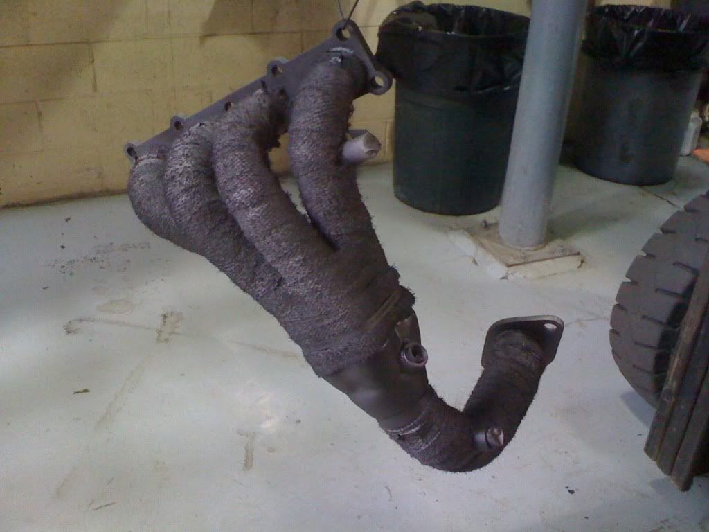

I wrapped the top half of the header, Im welding in the o2 bung in today after work. Then im going to wrap the rest of the header. Ill post up some pics later.

got the o2 bung in and wrapped the header.
Painted it Cast Iron grey...
That header looks so cute and fuzzy, I want to cuddle with it. heh-heh. Looks really good, man. Did you use hose clamps to keep the wrap on tightly? Are you going to silicone seal it?
I used these stanless straps (kinda looks like hose clamps..lol)Im applying the silicone tomorrow.

dam nice! that should help keep in a good amount of heat
Thanks!
Im doing a bunch of heat retention and cooling items in the engine bay.
Water Wetter, Oil cooler, reflective tape, header wraps/ also sealing up the space between the radiator and the frame.
