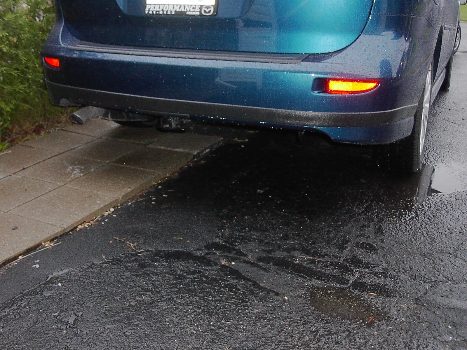

Been watching this post for quite some time and decided to go with the U-Haul hitch. I bought Hitch # 24754 (Class I, In the instructions that came with it, it says the hitch is a Curt Manufacturing Hitch #11338). Price was $119.95 at a local u-haul store. The store was asking for $70 extra for installation but decided to just install it myself.
Installation was easy. Just needed an extra hand to lift the hitch while positioning the screws. The hitch weighed 24lbs according to the instructions. I had to enlarge the existing 3/8" inch hole in the bumper beam to a 7/16" hole.
There were two U-Haul stickers which were visible. It said not to remove it for warranty purposes. So I peeled it off and sticked it the back so it will not be visible.
Now with the $70 I saved, I'm going to buy a nice bike rack.
Thanks to all who contributed to this thread. The information was really helpful.
Picture of the hitch (front)
Picture of the hitch (back)
Installed (rear view)
Installed (bottom view)
Instructions

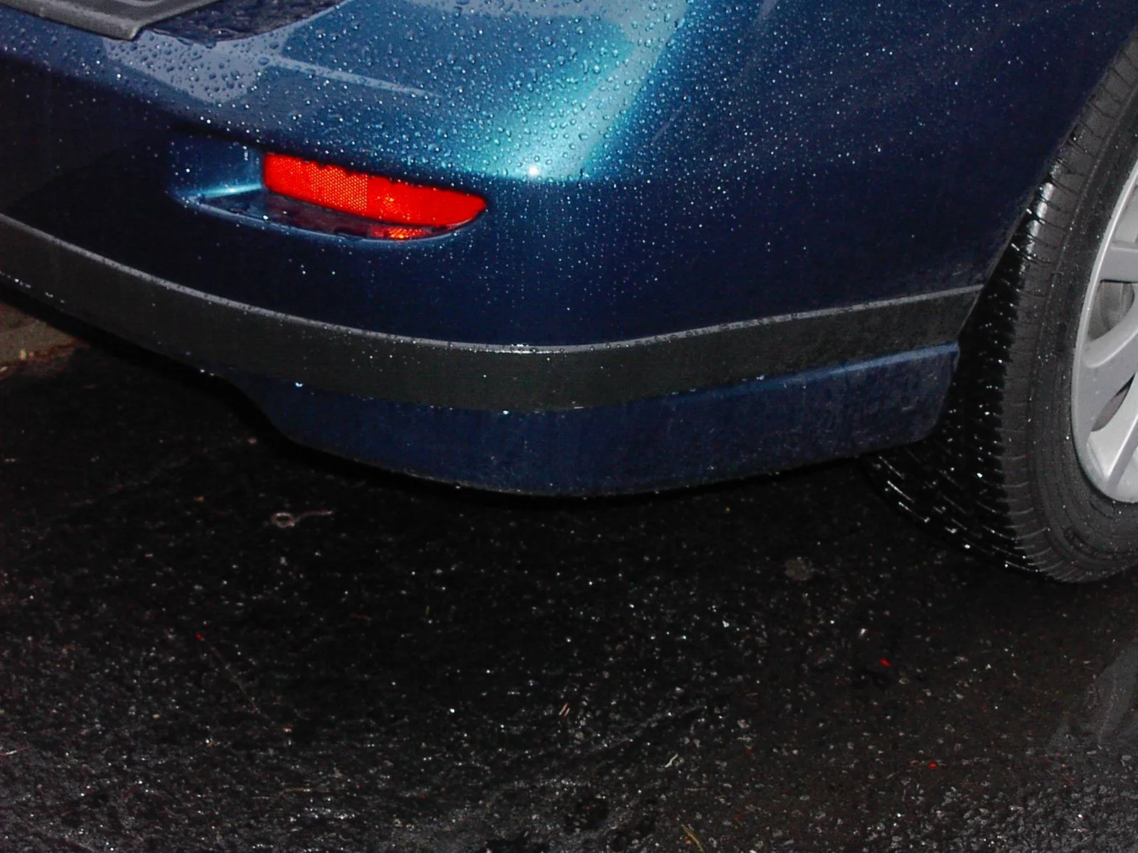

I added a bumper guard for my curtis hitch you may want to invest that addition. I went to my local trim shop for the trim.... I have attached a pic
