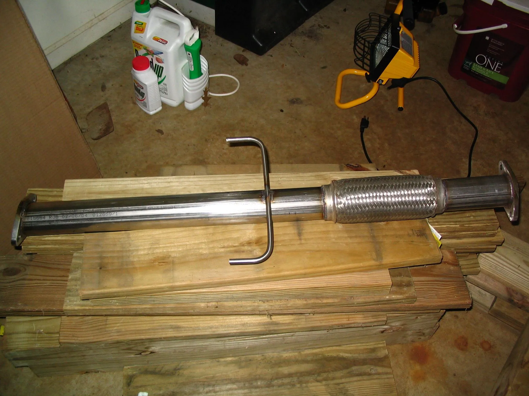

I just got my midpipe from Wagner (it took about 3 months to get), but I am going to use it with my AWR header. It is the one without the cat, but they are both the same length and diameter. Maybe you are looking at the downpipe? I sure hope so. This damn thing better fit.CRISPY5 said:Anyone know where I could find a high flow 2nd cat to bolt up to my AWR header? The one from wagner won't work as far as I can tell... Are there any others, I've been searching around on the net and can't find sheet.

scorch70 said:I just got my midpipe from Wagner (it took about 3 months to get), but I am going to use it with my AWR header. It is the one without the cat, but they are both the same length and diameter. Maybe you are looking at the downpipe? I sure hope so. This damn thing better fit.Here is a pic I just took.
ps Im not necessarily recommending Wagner. Just letting you know what I got.

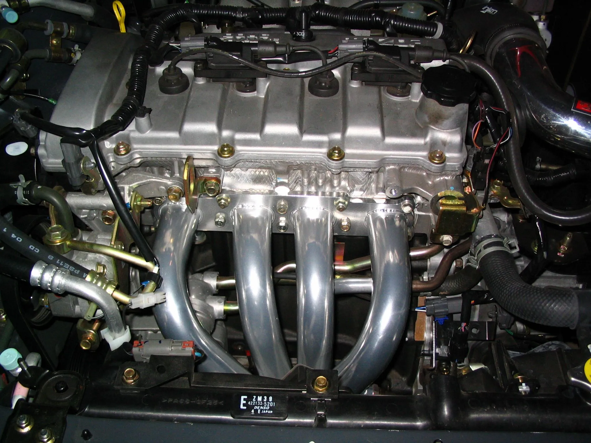

I got the standard finish, polished I guess. It looks really nice (attached a pic of it installed). Looks the exact same now as it did when I got it, no changing color or anything. Worth 190 bucks? I really dont know.CRISPY5 said:Looks like you are going the same route as I am. I have the K&N CAI however, and my AWR header is in Mississippi getting coated at JET-HOT as we speak (what color did you get and how do you like it..., and the MAGNAFLOW cat back is next on my hit list.... How does your ride feel and sound right now before you put on the mid pipe?
