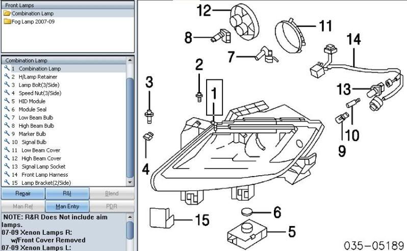

Well, first off, not sure what year your cx-9 is.
I have attached some images that are applicable for 2008. I don't know what year they changed the design of the headlamp slightly, perhaps 2009?

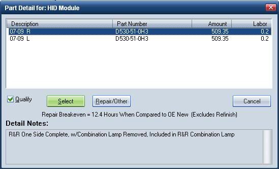

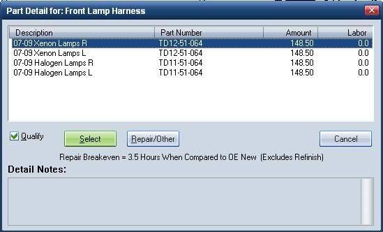

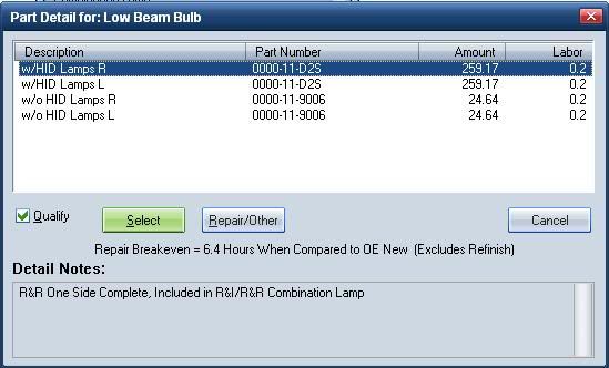

The plastic headlamp itself, has 2 different prices, which does not even include the harness, the module, or the hid bulb. Not sure what is different about the plastic headlamp between hid/non hid.
The HID assembly has a different housing, has an "hid module" (circuit that the hid bulb plugs into), and an hid bulb. Although the price for both wiring harnesses is the same, it appears that they are different harnesses.
Here are some images that may help you.
Oh, I remember now why the empty headlamp bucket itself is more expensive for the GT.... it has electronic leveling, where there is a selector knob on the dash to move the headlights up or down.
