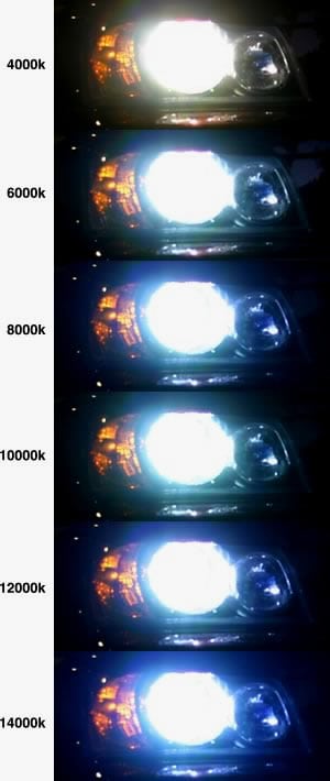

Sup fellas, about to pull the trigger on an HID kit from http://www.xenonexpert.com/xtreme_hid.html but I can't decide on the color.
Can you folks that upgraded to HID kits post some pics of the different color temps, and how they look in our standard projector headlights.
I'm looking for an OEM look, similar to BMW/ACURA etc....which seem to be pure white, but have hints of purple from certain angles. I don't want 5000k as it's too blue, so either the 4300k or the 6500k....but some pics or recommendations from you guys would be awesome.
Thanks!
4500k is the whitest and brightest, 5000k isn't noticeably different at all and isn't blue.
6000k is white with a touch of purple
8000k is white mix with a lot of purple
1000k is white mix with a lot of blue
then after that you start getting crazy colors.
You want either 4500k or 5000k

i have 6000k and there is nothing purple its just very white
I'm getting 8k and it is just a slight hint of blue, I have a friend who has them and is upgrading to 12k. Personally, I think it's retarded to go that high but I like 8k.
It is dumber to go higher then 8k to me too, you start loosing light and are much more likely to get pulled over for blue/purple/pink lights.
For best light OUTPUT, stick with 4300K - 6000K. In terms of what colour you want, YMMV.

The blue/purple flicker seen from the edge of the beam on BMW's, etc is a function of the projector optics, not the lamps. All OEM HIDs use 4100-4300k lamps which are white. If you truly want that "flicker" then I suggest looking for some actual HID projectors to retrofit into your headlights, and color mod them by placing washers between the shield and the projector bowl to allow light to leak out and cause the flicker. You can't do that on the OE halogens projectors as the shield is attached. Even the OE Mazda HID projectors can get a pretty amazing end result.
Oh and 6500k is more blue than 5000k. ;)

fact:
Apexcone 4300K hid kit is MUCH WHITER AND BRIGHTER than the stock OEM 4300K hid kit that comes in teh MS3 GT
I'm running thier 4300K plug and play kit and it is WHITE! no tint of yellow at all
But, each company is going to be a little different.
My wife is running a 4000K techone kit and it is even whiter than my 4300K
neither have even the slightest tint of yellow or blue
As long as you stay in the 4000K to 6000K, you will get the most usable light
As soon as you start going blue-purple, you significantly reduce the amount of useable ligth your eyes can see
is it actually 4300k or is it 4500k? All the apexcone bulbs I find seem to be only available in 4500k.
i am 100% sure it was 4300K, but after searching myself, they all now say 4500K. either way, it's pure white, no yellow at all
I believe 4500K gives the maximum useable light. Anything higher or lower than that adds more color (lower = yellow, higher = blue/purple) but less usable light.
that's correct. 4300(4500K) is OEM yeiling the greatest 'usable" light
but, i do have a 4000K kit in one car and there is NO yellow to it at all, it's made by Techone, so, i'm not sure if they just mislabelled the bulb, cause from all the HID charts iv'e seen 4000K should have a yellow tinge
everyone saying "usable light" is referring to lumens which is light output
