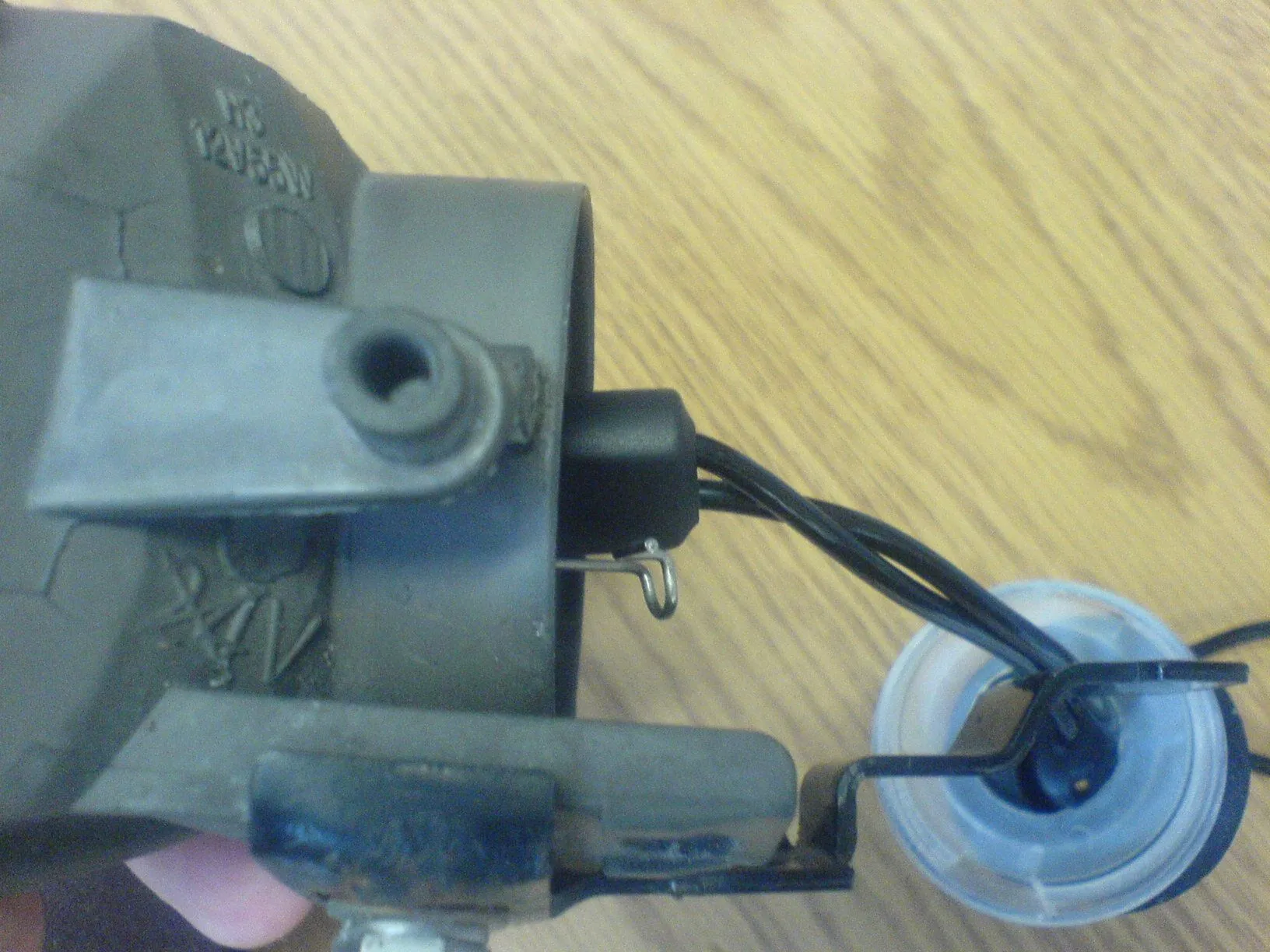

here's the other reason i would stay away from the rebased H3 kits... not always having the room in the back for the base of the bulb. the larger base is the rebased kit, and the other is an H3C bulb. the other problem i had with the sedan housing and the rebased bulbs was the rebased bulb would hit the stock glare shield before it would seat correctly, and i couldnt get the bulb clip to hold it in.
so, unless you are absolutly sure you have enough room inside your fog light, i would go with the smaller H3C bulbs.
