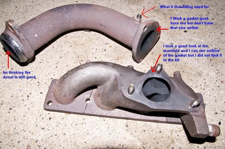

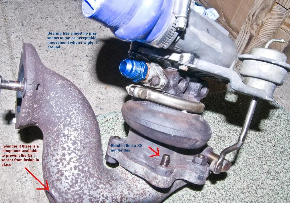

So I went ahead and sea foamed my engine today to get it ready for the install. I also took a good look at the parts and found out that i might need some stainless steel studs and gaskets for the downpipe. Take a look at the pictures and let me know what you think.
Over all im not intimidated by this install at all but getting these extra parts will make me much more confident in the process. (cabpatch)

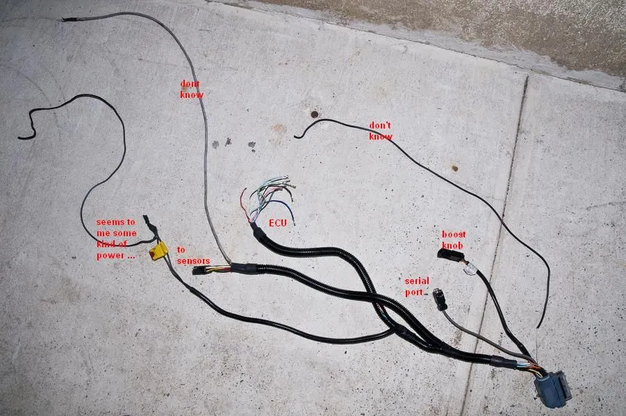

I took almost everything off at this point. Have 3 problems at this point 1 EGR pipe tread is refusing to come out, 2 Oil T fitting has uneven thread, 3 weiring harness has some wires that i cant identify, no Im not in panic just yet(boom01)

Wiring - can't help you with that one...
well i installed the hiboost manifold, turbo, s pipe and j pipe in my car and custom everything else.
the gasket to the j pipe and s pipe doesnt exist because you do not need one. the metal is flushed so it would not leak. that also includes the manifold to turbo and turbo to s pipe. ( put i picked up wrx gaskets for the turbo to manifold and turbo and s pipe just incase.)
the set up is tight so be patient with it.

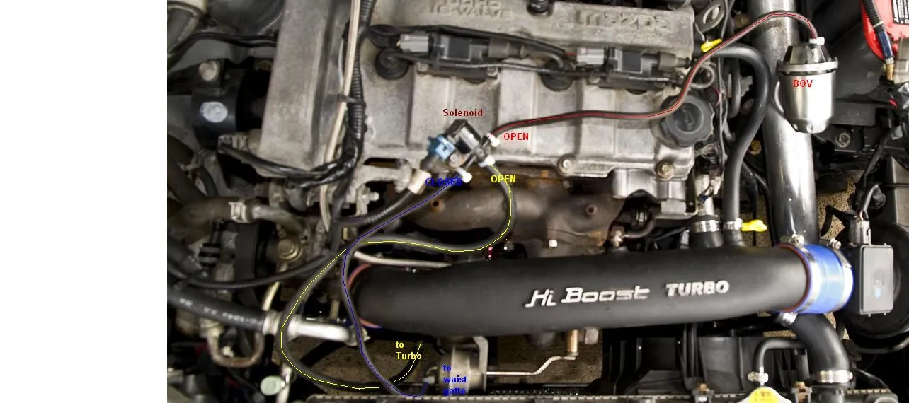

First question is how do I hook this up to the Waste gate, Im guessing the blow of valve, and the outlet from turbo. To the boost controller.

Ok to start you wiring is most likely ****** re chack everything. As far as the boost solenoid is a 3 way solenoid right? If so then im pretty sure one of the ports is going to be left open. Your going to have a seperate plastic tee for your bov
looks liek you have the solenoid hooked up wrong. if its like any other boost solenoid your going to have one port open. Your bov should have its own independent vacume line run off of the intake mani

I also fixed the vacuum by separating the BOV valve house from boost controller and taping in to the manifold. Checked the 12V power to E6X and its constant never turns off don't know if its good because Im thinking maybe it needs to clear after car turns off and in this case it dose not happen. When i start the car it still has that idle where it goes up and down and all the lights do the same i checked voltage when operating it fluctuating (maybe the alternator went). And the last issue that i have is stuck accelerator (thats what i call it) well not exactly. When I rev the engine a little bit something like 3200RPM it tends to rev up and stay at that RPM if i rev to 2700 it will stay there if revved to 3200 ill get stuck there. Most of the time after turning the car off the revs will drop but on rare occasion when I restart the engine the revs go right back to to where they were. And it has something to do with the OBD code P1562 that is coming up.

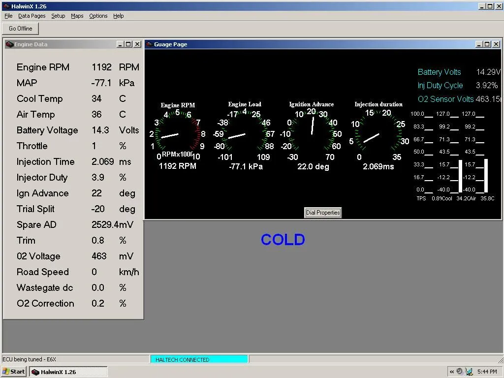

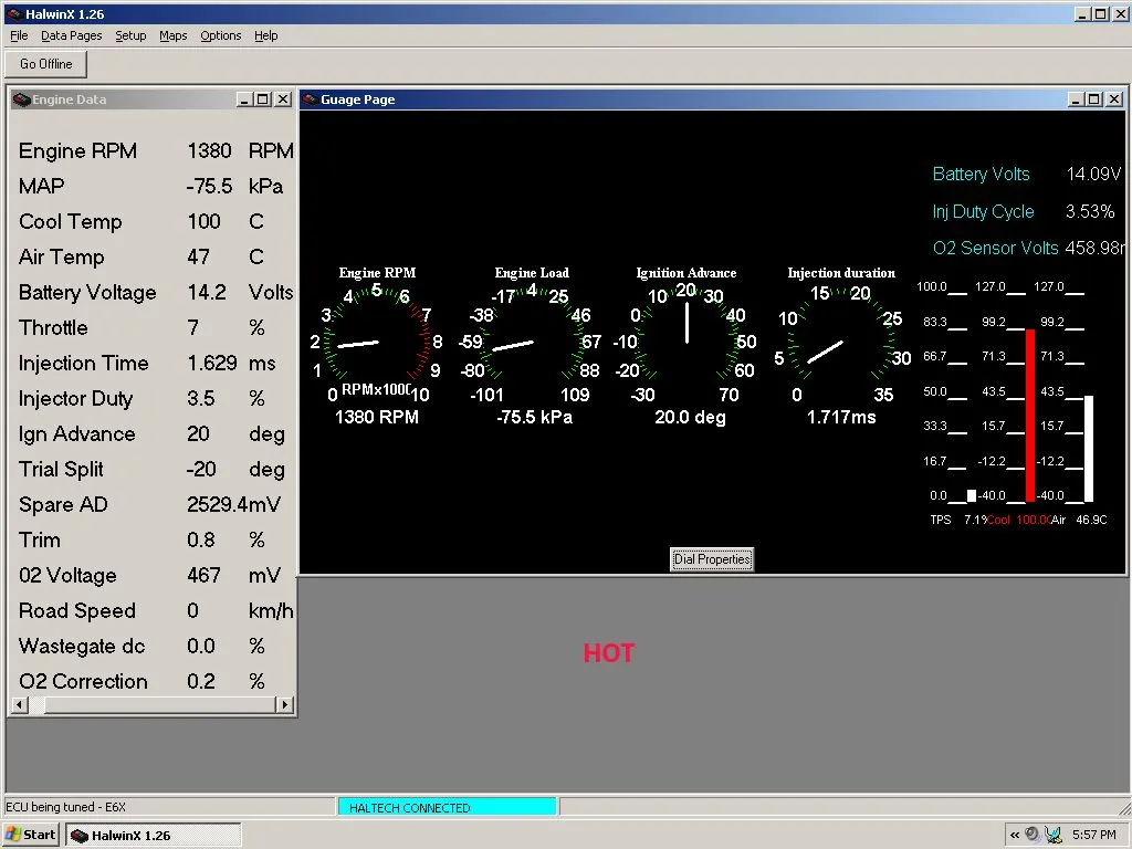

some screen shots of the car running
So I hooked up my laptop to the E6X and took two screen shots one when I just started and one after the car warmed up.
I don't know if you can make anything of the data being displayed but maybe some one will spot something. Until then Im back to work!
