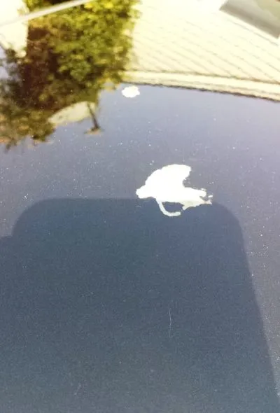

Hi all CX5 owners...weird question to post/ask here. As I always do with all my cars, I washed it this past weekend with my Griots Garage products and when I rinsed off the soap/water to my shock and surprise I had FOUR spots in the shape/size of a US dime that were completely bare! The paint actually popped off! What are your thoughts? Paint defect from Mazda? I will wait to get some response here within a day or so prior to visiting my dealer where I purchased the car about 3 months ago.

Wow I would be heading to the deal asap. There is no reason you should lose paint just from washing your car, that is ridiculous.

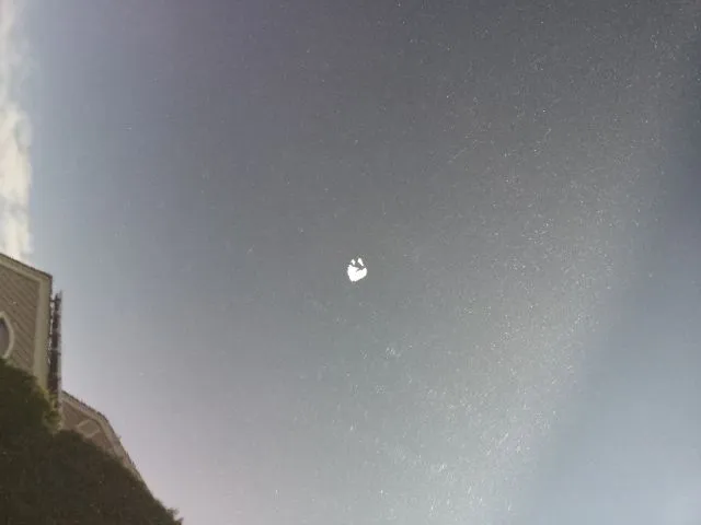

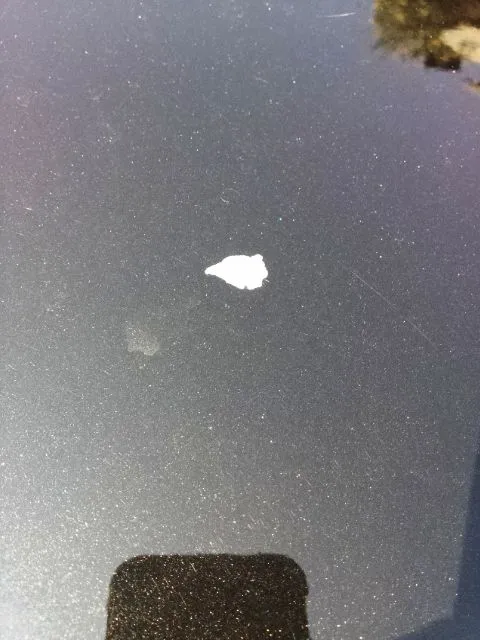

To update you guys here...my local Mazda dealer forwarded the pictures they took to their regional manager/quality person whoever they say it is and waiting to hear from him/her. They outright said it is a dealer issue and not to worry they will absorb the expense (s*** of course they better have!). My concern is that it isnt "new" --after only 4 months it will need a hood and roof panel paint job! (wow) ...cant say I am totally happy. I would in my fantasy world would love to hear them say "no problem...pick out any other CX5 from our inventory to get that new experience again"... crossing my fingers. Here are the pictures, hopefully they are easy to view, I labeled the three pictures for the three different paint issues.

Wow, from that pic I do not think it is thin paint but rather a cleaning problem at the bare metal stage when they painted that did not let it bond to the metal. Paint may be thin, no doubt but it would have the problem all over the car if it was just short changed on paint. Could have been a bad batch of paint too that was not mixed right, not primed correctly or a problem with the electro charge during painting. What ever the case it is good to hear that they are taking care of it.
