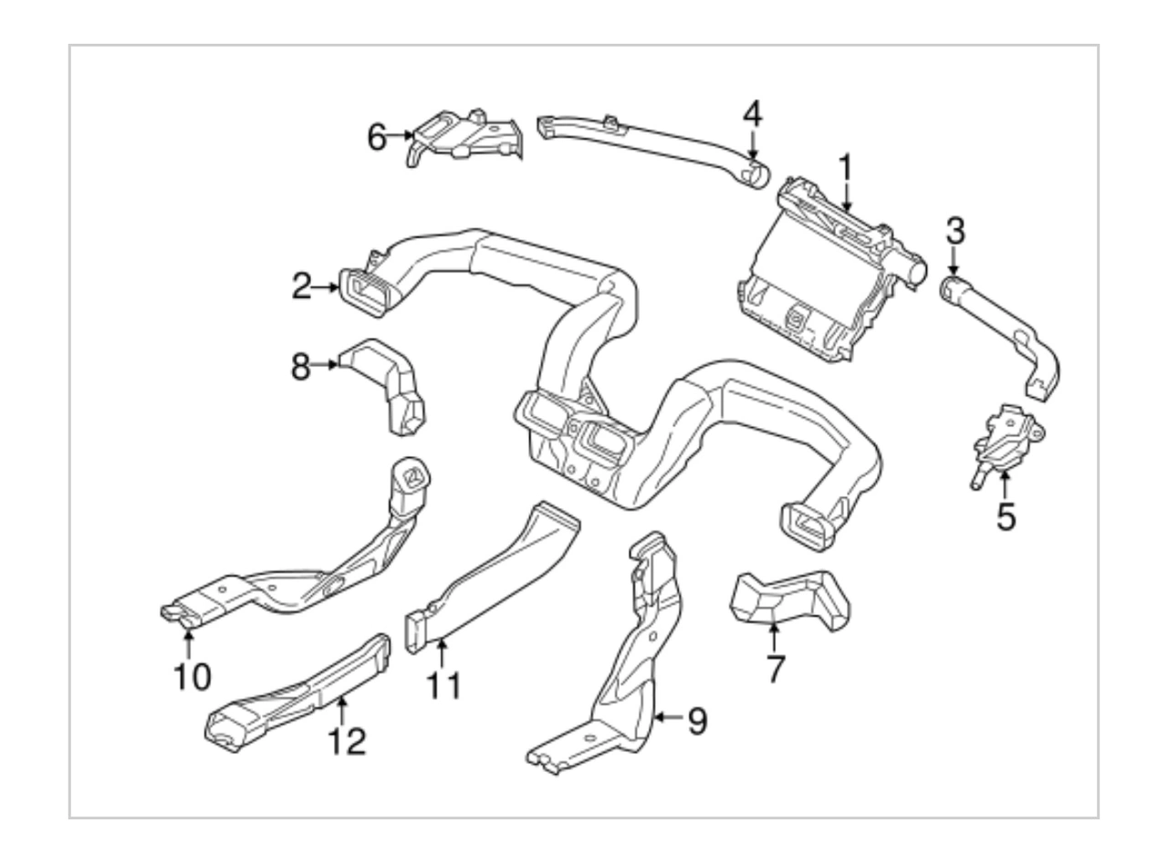

IF you can spot the ring, and that's a BIG If. perhaps if you have a shop vac, or similar, you can fashion a small tube attached to the vac and use the tube to grab the ring by suction and get it out of the ductwork that way?
If someone has a dashboard diagram, it may show where the defroster vent hose comes from. That may have a better access point than from the vent above.

First off OP, be glad you know generally where it is! I guarantee you know someone who wishes they knew where their original engagement ring or wedding band is. If you didn't before, well... you know me now.
Looking at the diagram cz5gt posted, it looks like the large piece #1 is where it might be contained. The good part is that likely narrows it down. The bad part is the shape of that piece probably doesn't lend itself to being able to suck it out of any other opening in the system. Again, be glad it's in there and not in the ocean or a storm drain or something.
I once used our house vac to suck a piece of pencil out of #1 spark plug hole on a 1970 Dodge Challenger
Dammit top dead center, where are you??!! 😆
If the ring is sitting in duct #3, a shop vac might be used to get it out. Hopefully the cabin air filter kept it from falling into the bowels of #1.
It'll be tough.
I think #1 can be seen at 10:30 which is a bit tucked away. But it does seem to me that there's a way to pop the bottom open and that maybe your saving grace
