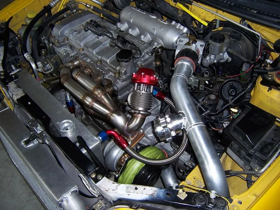

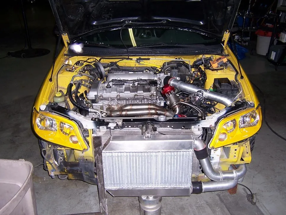

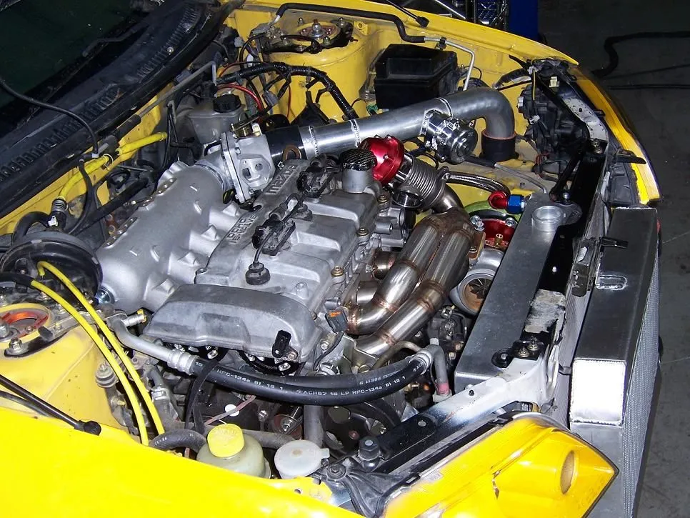

Here's some more progress and ya'll wanted more pics. Intercooler end tanks have been redone, charge piping made, waste gate installed, bov installed, and intercooler partially mounted.

That is sexy. But my god that IC is HUGE. And the headlights, not digging it...
but whatever, your turbo setup will kick ass :D
Overheating Will be a Problem.
You Have
FMIC
AC Condenser
then... Tada, Radiator..
Non of the Rad is direct air, it will always be soaking off of something else,
Normally a Radiator isn't even effective without the fan running until 35 Mph, and that's without the AC condenser in place. Your core is so thick that the problem will be even more pronounced.
I think the problem would be totally fine if you would remove the AC and install pusher fans in it's place.
It will clean the inside of the bay up very nicely..
Get MORE FANS
Get BETTER FANS
Or you will kill it in traffic.
Brian is right. Even with my PWR rad, t-stat, and straight water + water wetter only I still run really hot while sitting in traffic. And that's with a 15" and a 12" spal fan keeping it all cool.
I wanted to remove my A/C but it gets WAY to hot here in Calgary. It's like 33* today, and has been about there the last 2 weeks.
You Have
FMIC
AC Condenser
Get MORE FANS
Get BETTER FANS
I wouldnt think that he would be daily driving this car. And i just noticed
that you have AN fittings and steel braided lines for coolant hoses, BALLA!
Way Too Small. The coolant should flow with Volume and No Pressure. Doing this will totally reduce the effectiveness again.
(edited - was thinking of something else. Water Wetter is a very effective coolant. Sorry)
As for the IC being so large, the heat it absorbs from the charged air will be spread of a greater volume, and this only comes into play when the air is being compressed. With the turb I'm using there's not going to be any significant compression while sitting in traffic only while I'm accelerating, most likely full boost won't be seen until 3500-4k rpm. most of my in town driving is under 3k.
As for the coolant hose fittings, we talked to several radiator specialists and the hose companies, and explained in detail what we were doing and they all stated the the hose and fittings we got were sufficient. Also will be running High cfm fans (don't remember the brand name off hand).
Man up and take it buddy :D It has been equally hot here but it really isn't that bad. Maybe if you were stuck in traffic a ton, but if you don't have to sit at lights a whole lot it is fine. Windows down, music up, all good :D
It's not an issue of heat soak, It's an issue of restricting fresh air. The core is very effective at limiting airflow. It has a massive surface footprint.
Ya, I do spend a bit of time in traffic, but I' ma wuss I guess. Us Canadians don't take to the heat very well lol!
Brian is right though, it is very difficult to get enough air to your rad through the IC, PS cooler, and A/C. Like I said I've done everythign I can to keep the car cooler and I hit 250*F in traffic on a hot day. It won't really go above that, but that's still pretty hot. My factory temp gauge doesn't move until about 275*
