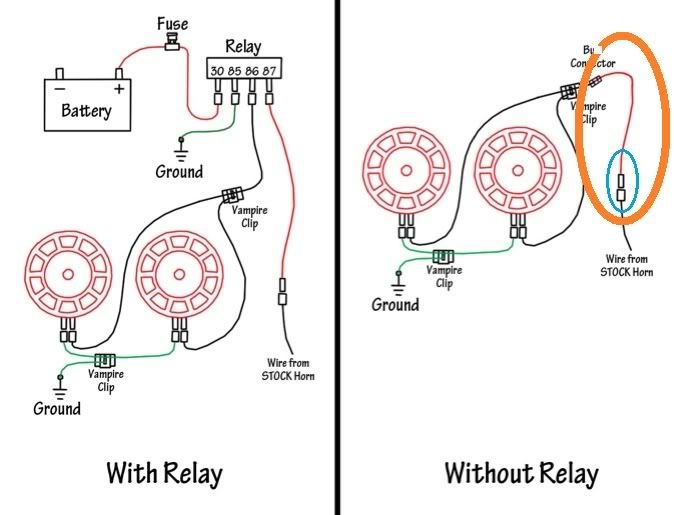

quick question with the install of the horns...did you just cut off the plug from the fatory horn and use a butt connector to attach it to the new horns?
orange circle is the new wire, and the blue circle is what i am questioning...not using a relay
You can, but I would recommend using the relay. The stock horn line doesn't supply the horns with 12v. If wired like the picture on the right, your horns will never be 118db
i have them connected now. im going to be running a relay to them shortly as i also need to adjust the grill a bit.

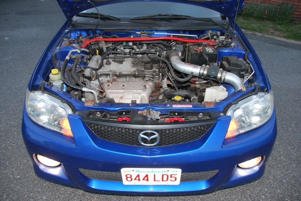

I haven't installed mine yet, but from the looks of it, I'm going to have to trim some plastic from the back of the grill
On the top of the plastic grill, you can cut out some of the "tray." This allows you to use some existing holes to mount the horns and will give you clearance above the horn.
Not the best pic but you get the idea
The little screws right above the horns are holding the brackets for the horns
i just made a new bracket 5 inches long, compared to the 3.5 inch bracket that comes with it. all i had to cut was the two lower plastic pieces that are located at the bottom inside part of the grill.
