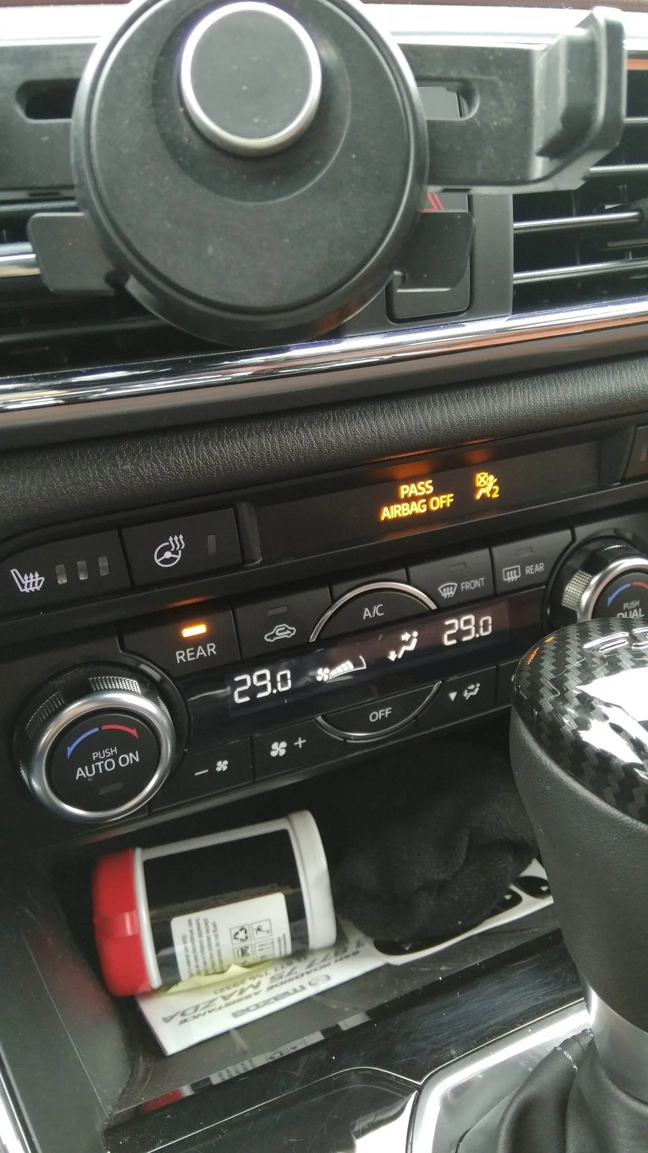

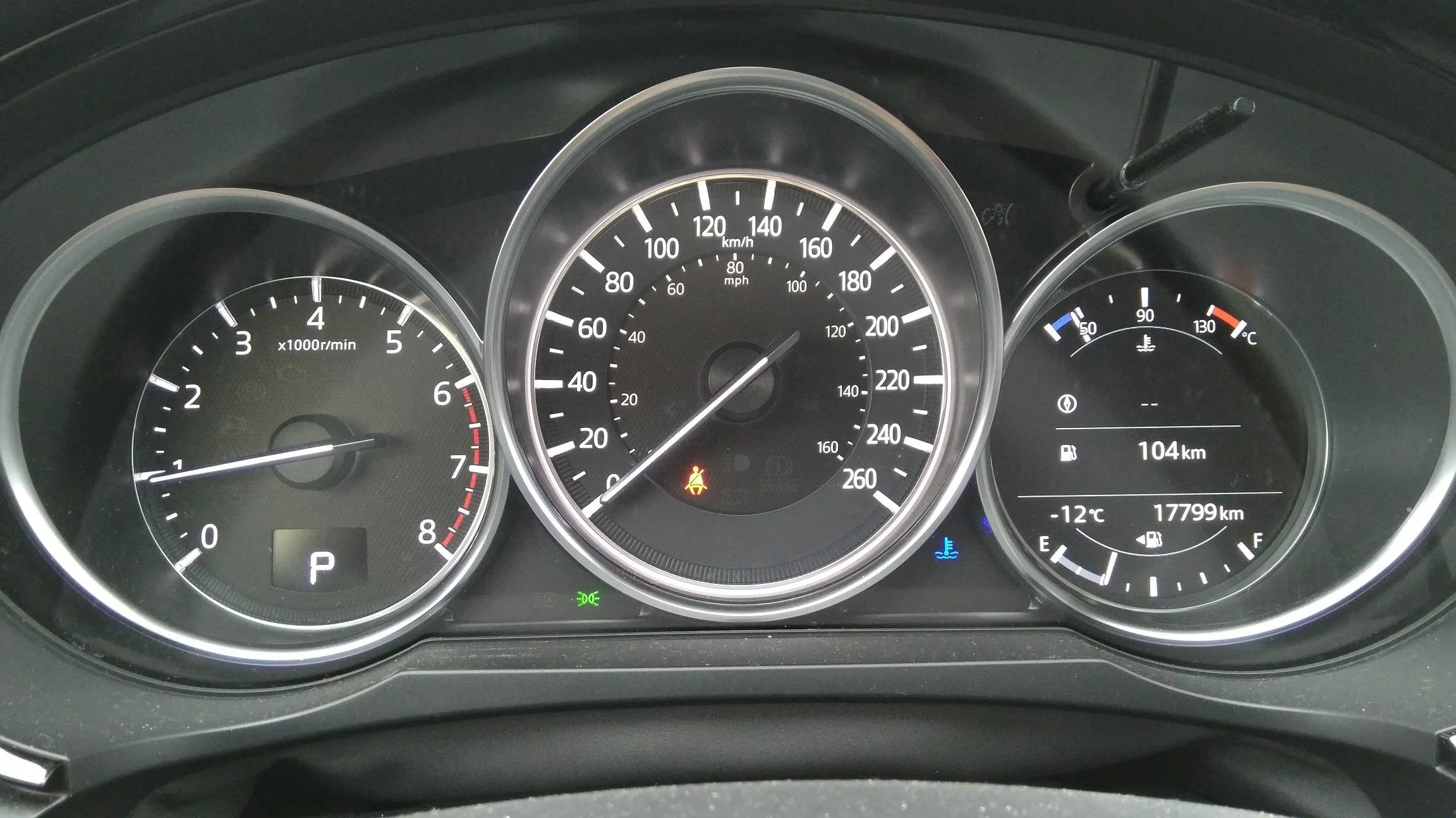

I'm going to attempt the test again right now.. The car has been sitting outside overnight in -25c, and it is currently -17c. The block heater has been plugged in overnight as well.
So, started the car at 2:07pm. All HVAC settings were still set to the same conditions as before, air directed to footwell/driver, recirc off, heat set to 29c. I also noted that at startup, the RPMs hovered around 1500 for a few seconds (maybe 10?) and settled to around 1200. Engine temp gauge is at the coldest reading. Again, ambient temp outside is about -17c. I took it off the block heater and went back inside.
20 mins later, I went back out. Here's what I found.
attachment.php
attachment.php
In the pics you can see that the fan is still two notches away from max, meaning that the system knows it hasn't warmed up enough to blow at max strength. You can also see that the temp gauge is still in the blue, the cold engine indicator is still lit, and RPM is hanging out at around 900. The fan was blowing hot air, and the cabin had warmed up an adequate amount, though if I had to go somewhere I would not have turned it down just yet.
Again, this is opposite behaviour of what others are experiencing. I don't know what the deal is here, but maybe you guys can use this information and my documented experience to your own advantage with your local dealers or Mazda Corporate.
