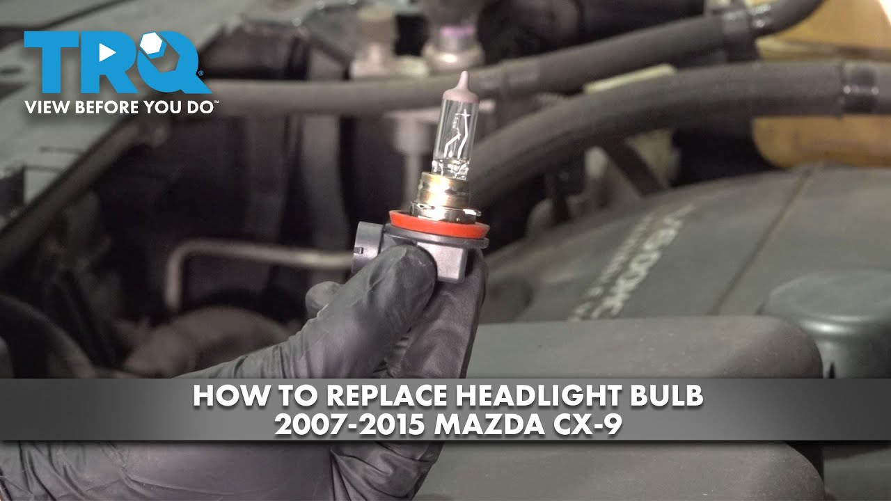

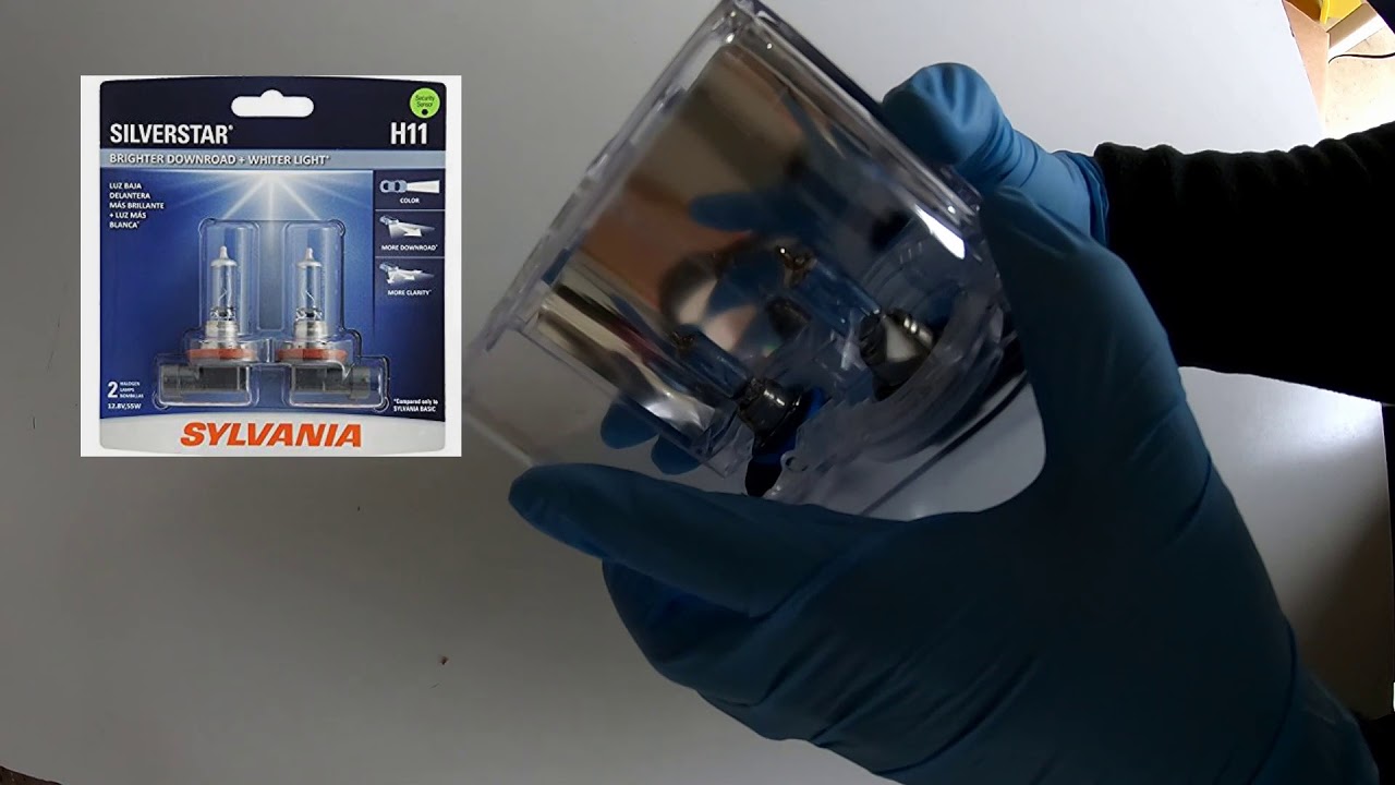

If you're interested in doing the bulb swaps and new bulb/ballast installations yourself, here is another great video to reference, in addition to the video posted above. This is specifically for non-HID bulb replacement, but it should be very similar for HID-equipped models.
NAPA lists the halogen high beam as 9005 (US$9) while the halogen low beam is the H11 ($18). Follow sm1ke's always excellent advice for the high intensity discharge lamps.
