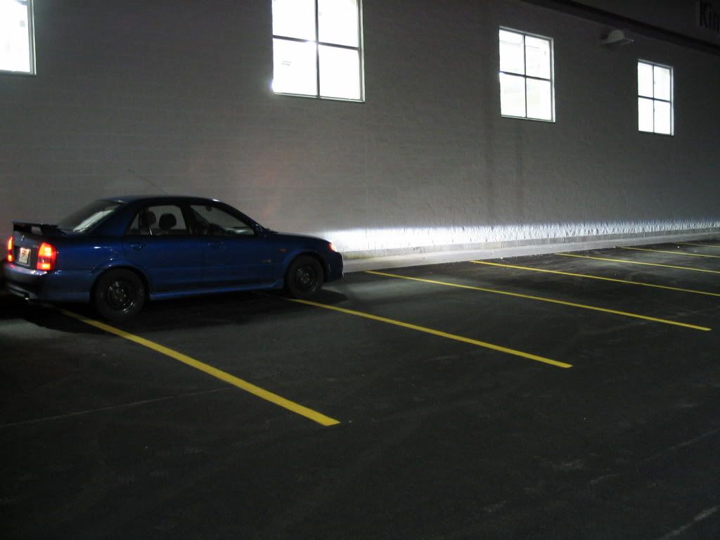

but if they are lined up but pointing up blinding other drivers you won't be able to tell by pointing the car at a wall. Parking parallel to the wall, very close to the wall that is you can see your beam along the wall and see the slope of the beam.
Pic of my old MP3 with HID projectors. This is what I mean
What happened to those headlights?
What projectors were they?
