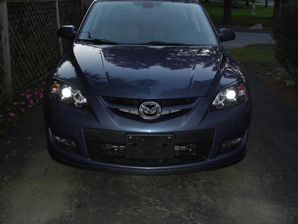

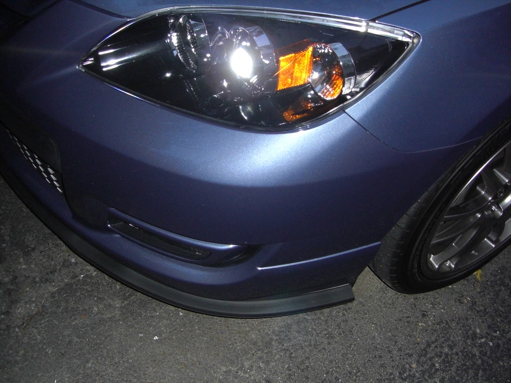

Yeah there is one wavy spot on the passenger side of my car... annoys me but not enough to do it again yet.
And its not hard rubber. It is a foamy rubber. It has give to it but it doesnt not lose its shape.

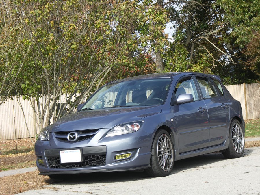

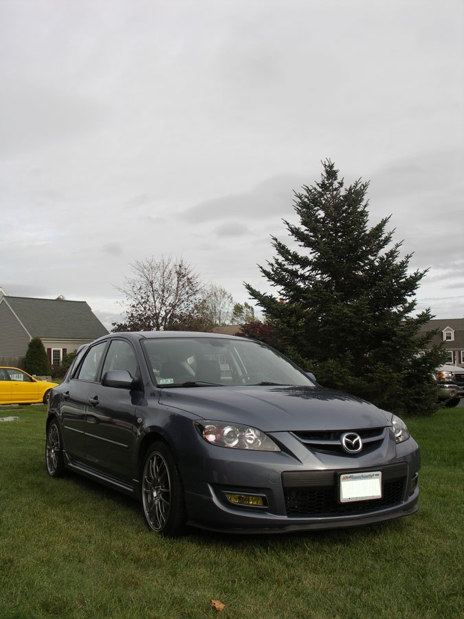

i used the grey super double sided 3m tape. i got 2 rolls...rolled it out on the bumper where i tried an extra piece of the "lip" to figure out where to put the tape...then ran the lip along the bumper. i put 4 screws....not needed but mine is super straight with the bumper. i put a screw on either end of the bumper to make sure it didnt ever peal back and one where the bumper raises up in the middle to hold it up into the bumper. came out perfectly straight and actually looks like it belongs. no waves, no peeling.
The best advice I can give you is raise teh front of the car up, jack or ramps if you can and take your time. Lining it up isnt hard but you will want to play with it before getting the tape ready so you know where it is going, especially in the center where there is a bit of a valley change under your grill. I bought double everything and there is a spot on mine I am not completely happy with but it hasnt bugged me enough to do it over yet.
