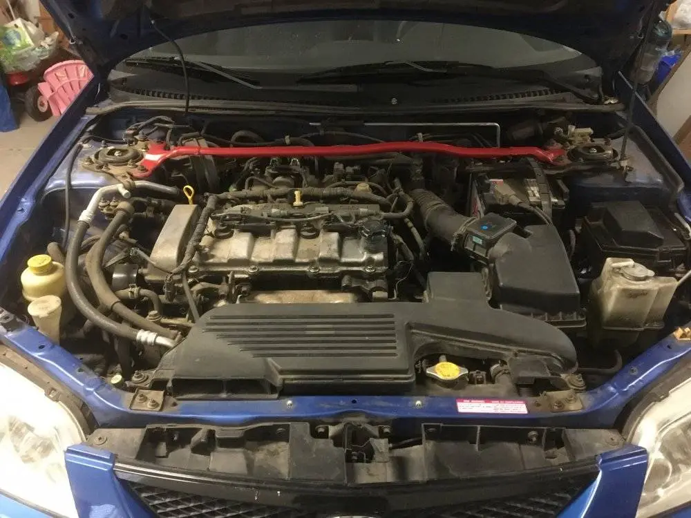

The first round of inspections exceeded my expectations. This is an exceptionally well cared for car.

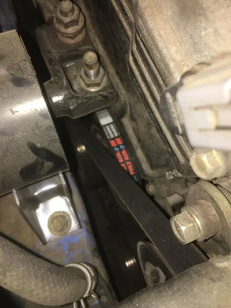

Everything under the hood looks great. The drive belts look brand new, the hoses are flexible and free from cracking, and really, the engine bay looks great.
I’m going to pull the valve cover next weekend to check valve clearance and look at the timing belt. A new gasket has already been ordered.

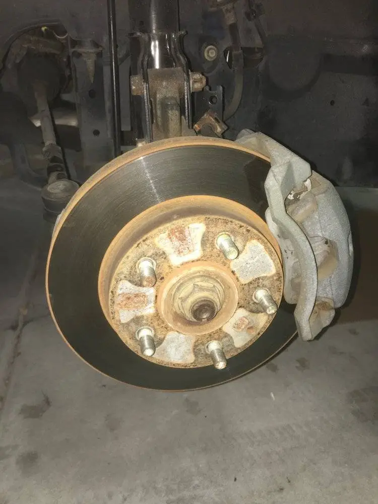

The breaks look really good all around. The disks look like they’ve never seen a worn out break pad, and the pads still have a lot of life left in them.

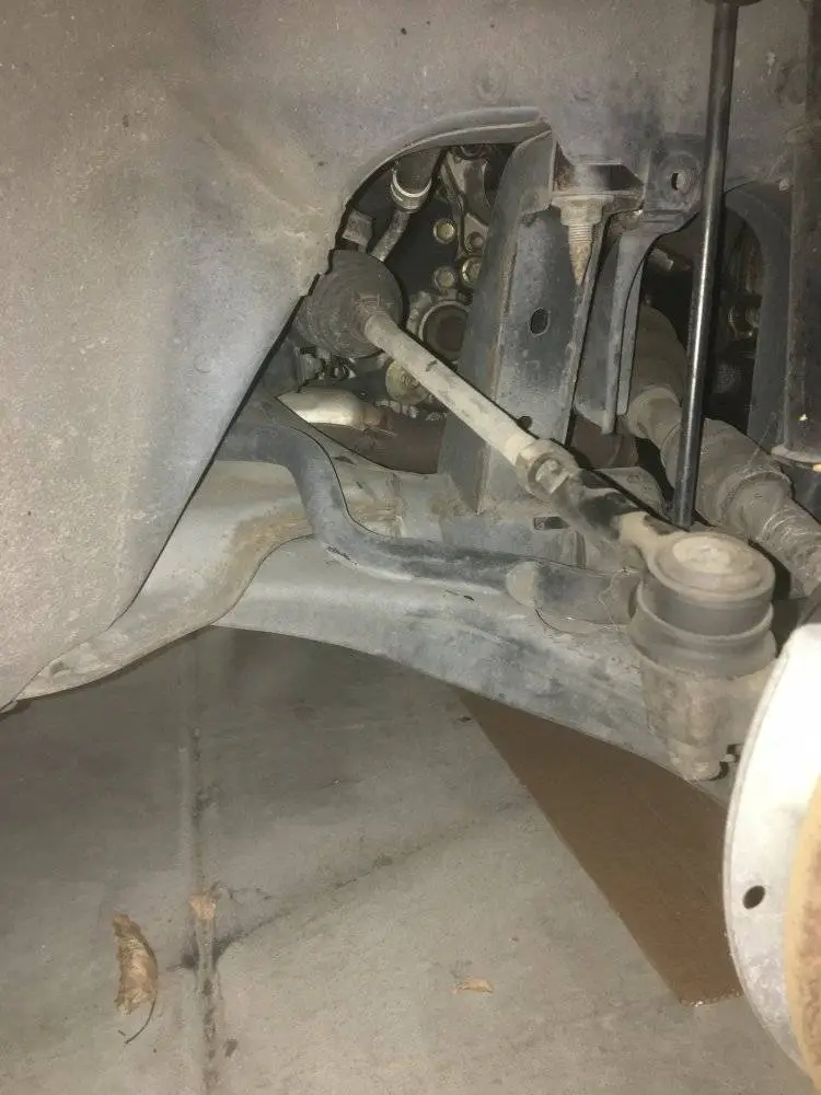

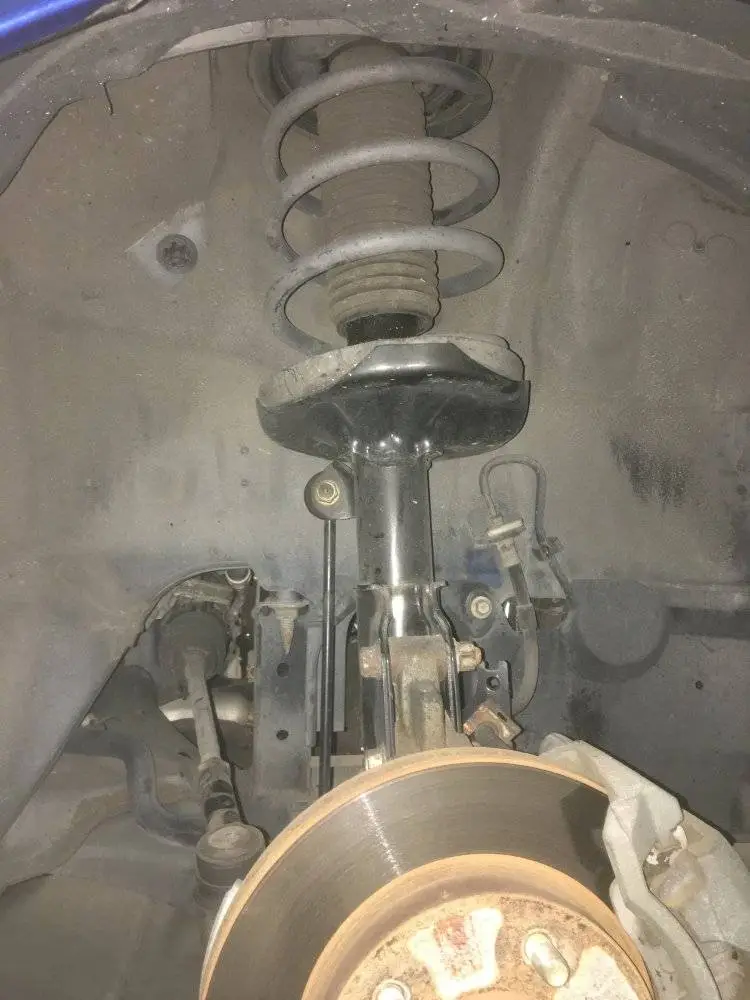

The suspension looks great with no overly worn or swollen or cracked bushings. The struts are all intact with good boots and no evidence of leaking.

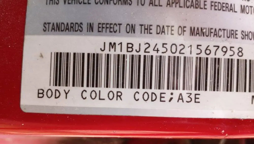

One question. Does anyone have the paint code for the red strut tower brace? I would like to color match the valve cover with it.
A3E.
I'm lucky because my car is the only color that has a color matched tower brace. Lol

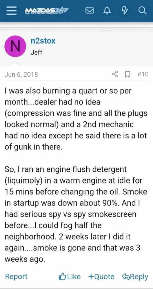

Check your car for oil burning.
Almost all 2.0 liter FS engines burn oil.
You won't notice any smoke at first until the burning gets really bad.
Check your dipstick after a few hundred miles.
Our engines have issues with seized oil rings and plugged oil drain holes.

Will I see any evidence of oil burning on the spark plugs? I’m pulling them next week when I pull the valve cover.
Not necessarily.
It starts off so slowly that the only evidence is on the dipstick.
I don't want to trash up your thread, but knowing where you stand with oil burning is pretty important.

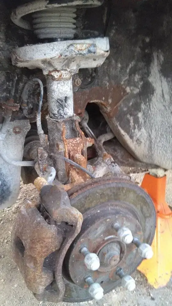

Our rear brake calipers are complete odd balls.
They are not seized (necessarily)
(Sorry only some of my pictures are still there.)
Thread 'Rear caliper dissection' Rear caliper dissection

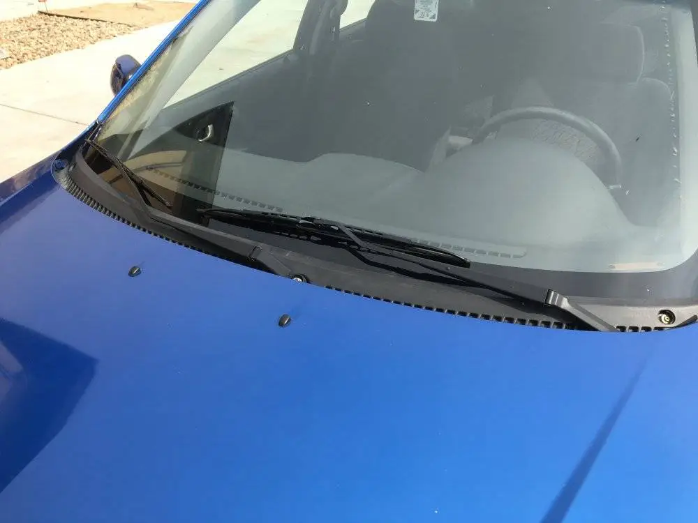

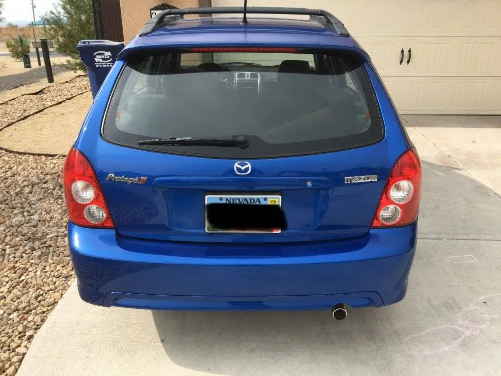

Fresh windshield wipers and Blaaaaaack wiper arms.

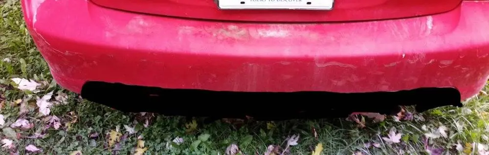

I removed the rear bumper protector to paint it blaaack, but after cleaning the bumper I don’t know if I want to put it back on…
I could have used the rubber bumper protector.
My car didn't come with one.
I've pounded a lot of crap in and out of my 'trunk'.
My rear valance painted...
(I didn't paint it. I spent half an hour blacking out the picture with my finger on my phone. Lol)
The valence or the rubber skid plate?
Plasti-dip peels off the valence if you don't like it.
