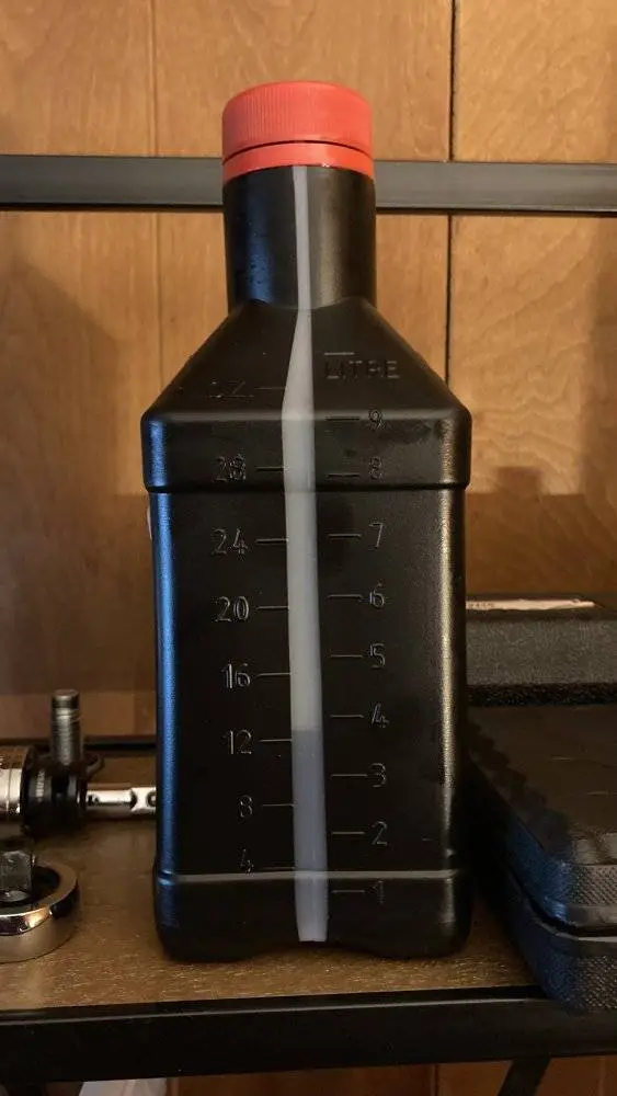

It took 5.5-5.6 quarts to hit the top hole when cold after sitting all night. Oil filter changed as well. 21 3T. Took more than I expected.

Here's my reasoning on only adding 5 qts. It puts the level just under the MAX mark, so there's room for a little OD, which is a common on DI engines. I've checked my oil on and off over the years. Sometimes it's at, or just slightly above the MAX mark. Other times it's back to where I filled it to. I have never been anywhere near the MIN mark on the dipstick.
Yeah I can relate to that. When I checked the oil after the first 200 miles on the engine, it was a tad above the top hole. What I found was that they are coming slightly overfilled from factory. I had thought it was fuel dilution but that was not correct. I personally like the oil to be exactly at the top/max line. Even if I had half a quart of fuel dilution it won't hurt the engine as all engines have some room for spare capacity in the event of a major overfill. I'd only be concerned with anything more than 1/2 quart overfilled.
