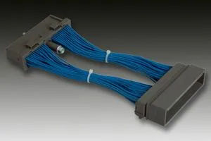

How would a guy go about cheating the system? I've got a LT10S that I will put in and as far as I know there are no emissions laws here... Yet! Is there a way to have the stock ecu run when no power to standalone and pretty much have a switch to turn it back on? Or a main connection that will allow ecu to work on its own?
You will have to get one of those ECU Harness Extender things that AEM offers. It goes in the middle between your ECU harness and your ECU. That way you can just wire the Haltech into that, instead of your original ECU wires and when you need to remove the Haltech, you would just take the middle section out and plug the original plugs back together.
