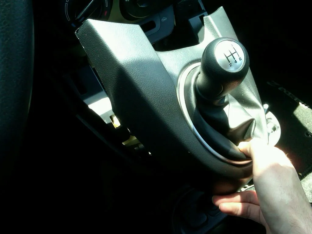

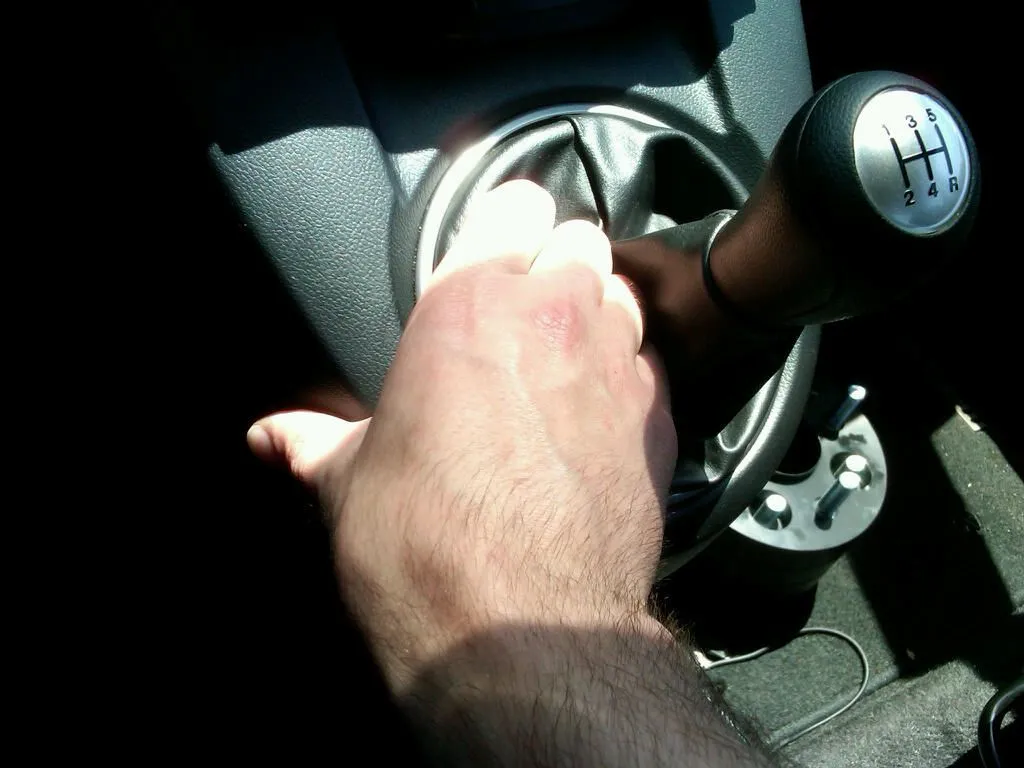

Here are some picture that might help. I was out in the 2 today during lunch and snapped these photos. It shows how it all comes apart. Mine you can just pull from around the shifter and it comes up, but I think that it because I have taken it off a number of times.
All sorted, it was very easy once I realised you could just pull the gearstick panel off! lol
