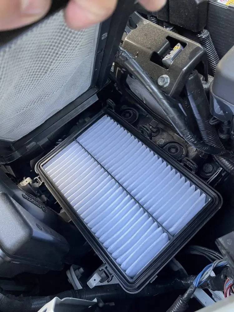

Brought my car in for an oil change at a trusted mechanic I’ve been using for years. After the oil change the Mazda sounded much deeper on acceleration, which concerned me. Read it was probably the engine air filter box. Sure enough, it was unclipped…and was pretty shocked that when I opened it, it was empty. I know nothing about cars, never changed an air filter. Instead of making a huge thing about it and driving 25 minutes back, I just went to Autozone and bought an air filter and the sound went away. Makes me kind of want to go back to using the dealer for service again...

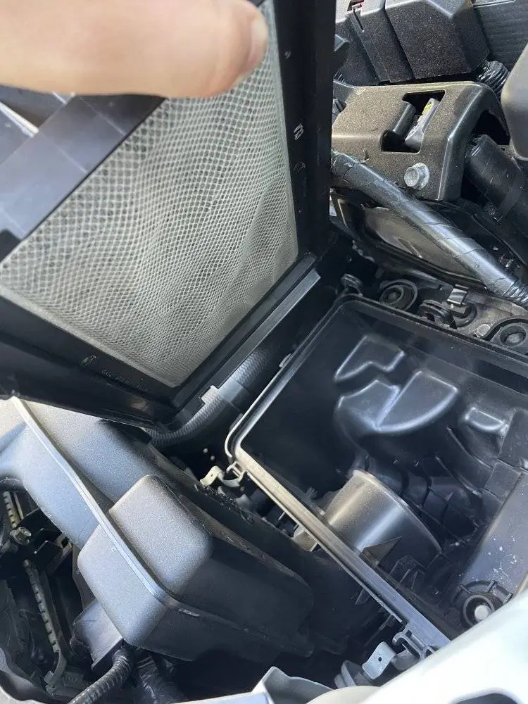

I do have a question, though. See that piece of mesh on the top end of the box? Does that ever need to be cleaned/replaced? Photo without the air filter below.
I believe that is a carbon insert. I don't think it is replaceable, but I would probably take a vacuum to it whenever you change the air filter.

That white mesh doesn't need to be changed. It's just to keep the big stuff away from the filter.
⋯ I do have a question, though. See that piece of mesh on the top end of the box? Does that ever need to be cleaned/replaced? Photo without the air filter below.
On 2017 and newer CX-5’s, there’s an additional carbon filter on the underside of the air cleaner box cover. It’s not a separate part and you'd have to get the entire cover for a new charcoal filter.
In most cars, the carbon filter has been used to absorb hydrocarbons after the engine shutdown. It helps to get a PZEV rating.
