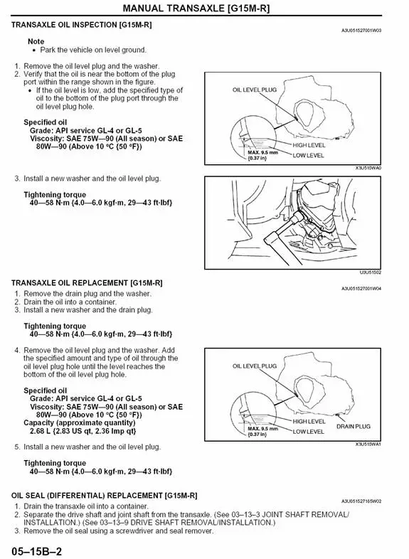

Here's the service manual page for replacing your transmission fluid. Have fun.

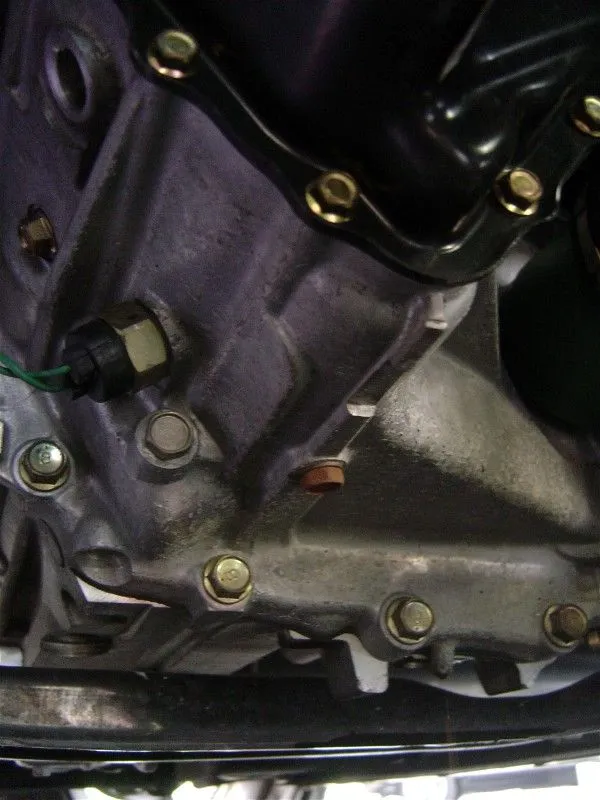

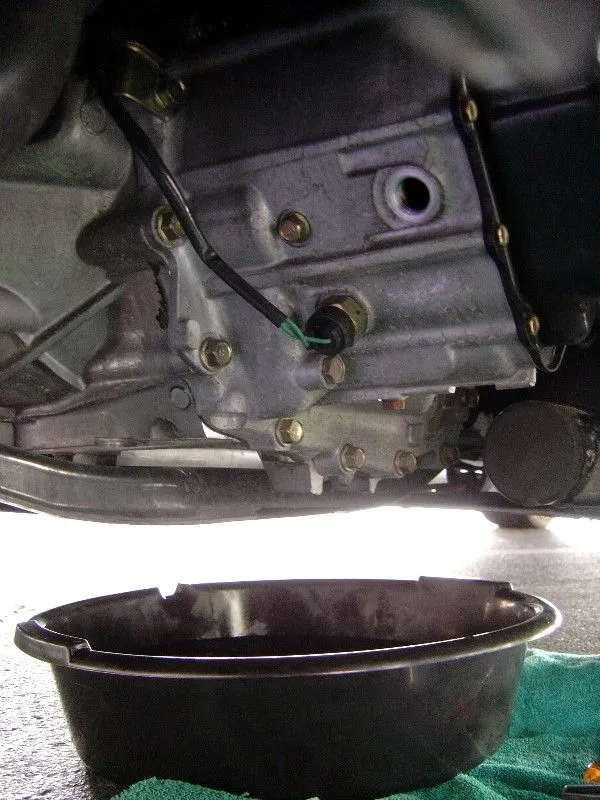

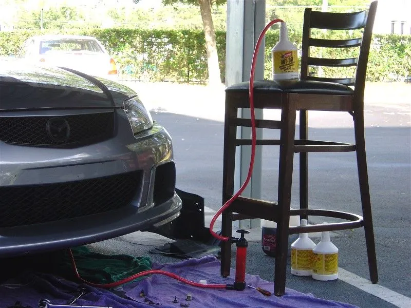

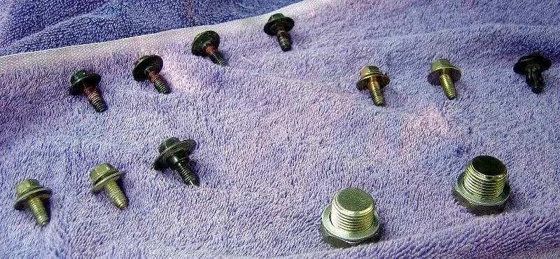

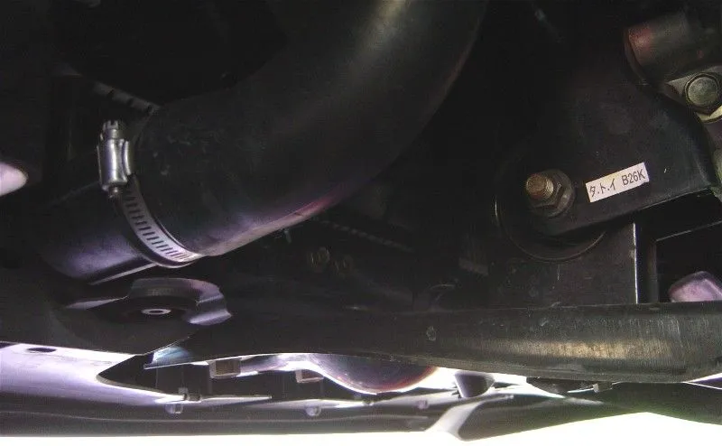

I just changed to the Redline MT-90 last week. I had to buy it from Apex because I couldn't find it at any of the Discount Auto Parts stores (even though Redline's site says that Advanced Auto Parts, who merged with Discount Auto, is the sole in-store distributor).
As with most installs, it took me longer than it should have because I had never done it before, but it really wasn't that bad once I removed 2 plastic pieces from under the car (I did it without jacking the car up).
Here are some pics I took while I was doing it:

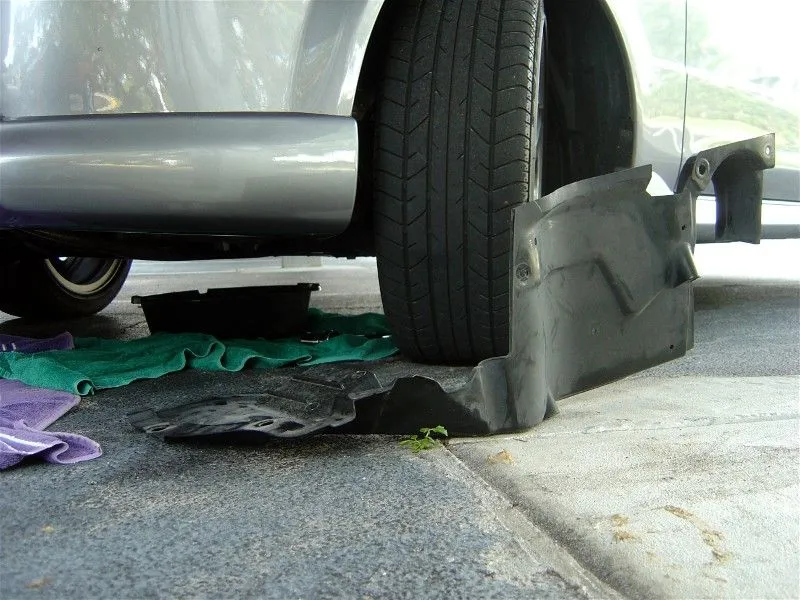

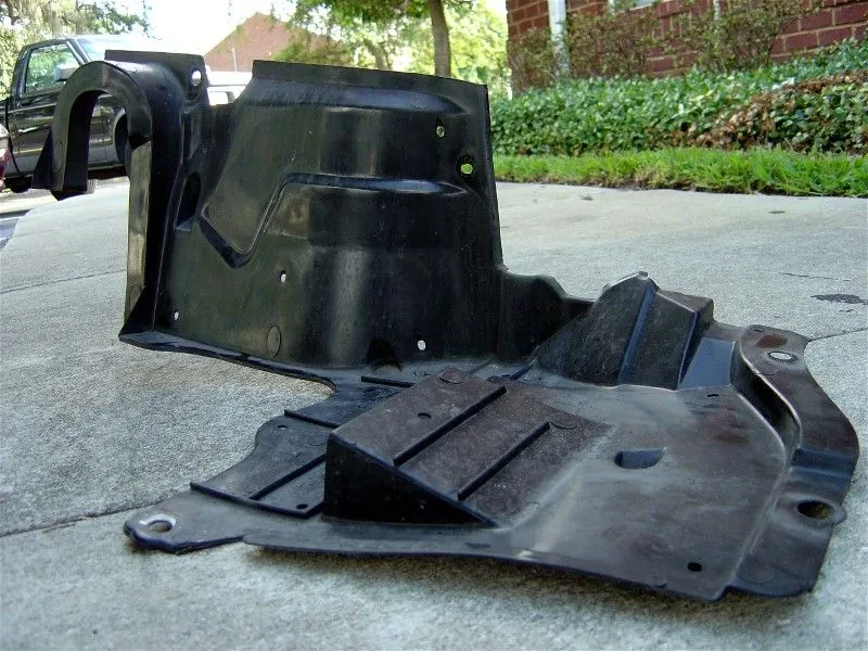

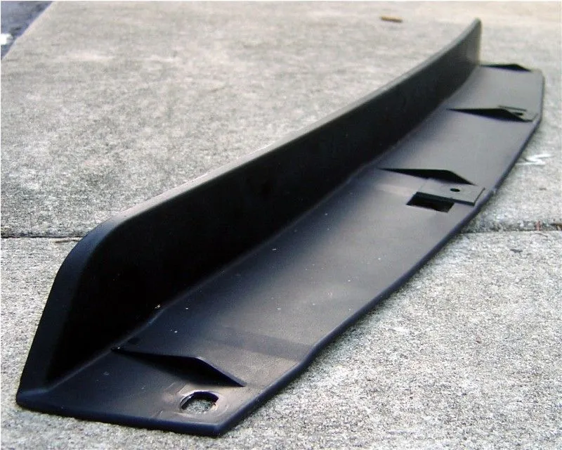

Here are the pics of the pieces I took off to get at the tranny better.
