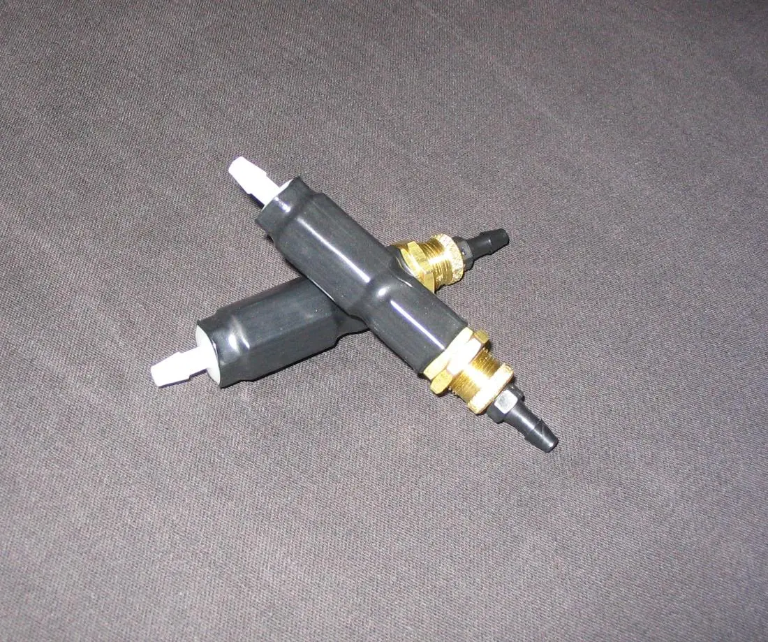

I have one spool controller that is spoken for and will be shipping out tomorrow. I can have another one ready to ship on Thursday, and will have about 3 ready to go for Friday. So anyone interested can pm me or contact me at sales@nsnmotorsports.com to place orders.
I'll try to post some pictures tonight if I get a chance too!
