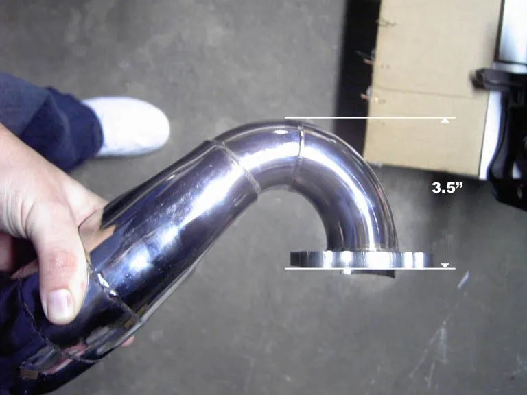

well its flush with the turbo, i dont think its an install issue, i think its just too much of a radius to get it to not hit.
we should compare dimensions, like measure from the flange to the bend see if all of ours are the same. it could be done with 2 rulers. im going to measure mine tonight.

heres a pic of my spipe from the side with a small measurement. so we can compare one that didnt fit. maybe it will tell us if were all fitting wierd.

Removing the rad and mani is only if you cannot get to the bolts that are hard to reach, at the back of the flange and the bottom. That was not an issue for me, the original dp is off without removing them and the new one is on. now think like this for a second. 1. Maybe I am not an amature machanic 2. if I remove the turbo and bolt it back up 20 times its still going to be in the same place and the pipe will be hitting the ac condensor. 3. it wont fit. Phill already took care of me so its not an issue. He runs a good business and I would not hesitate to do business with him in the future. I would not have put him through sending me another if I didnt know for a fact that this one would not work. Not trying to be an as$ but i dont care to have people act like I dont know what I am talking about when I would not post unless I was 100% sure.
I will take a picture of mine when i take it back off today from the side like that.
cool sounds good, i just had my turubo replaced not even 500 miles ago so everything should be easy to remove. id rather do it the belt way also cause thats alot easier. i think im going to do mine sunday. Yea GHL is a nice business, very prompt, i had no doubts they wouldnt get it resolved quickly. im not worried about mine either but i also cant afford alot of downtime, so i want to compare mine and yours to see if i would have the same issue. thank for the all the input.
