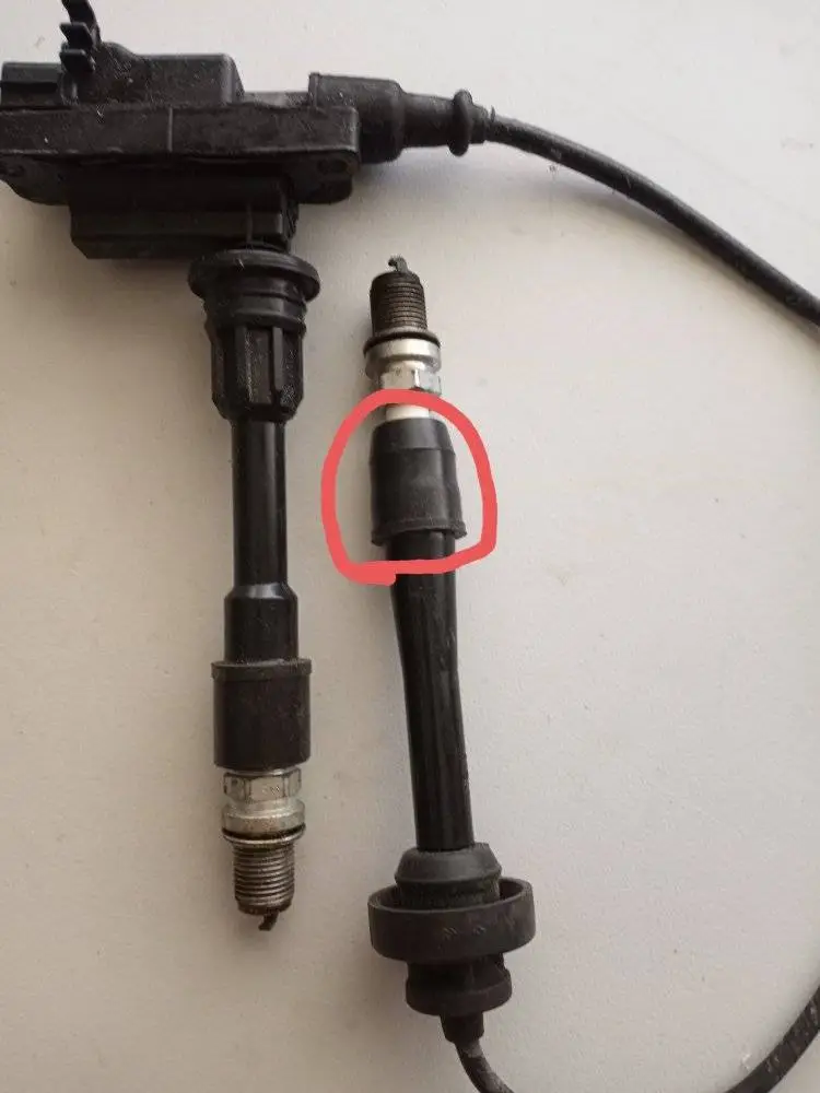

So, changing spark plugs and the coil pack pulled out without pulling the spark plug boot up.
Any ideas on how to get the spark plug boot out?

Actually, yours came apart differently than mine.
You should be able to get a flat head screwdriver under the lip of the boot and pry it up.
On my car, the rubber boot was stuck on the spark plug and the plastic pulled out.
I had to reach down into the hole with the coat hanger to try to get the damn thing off of the plug.
I took me over an hour of fussing around.
You probably need a new coil now, I don't think you can just stick the wire back into the boot.

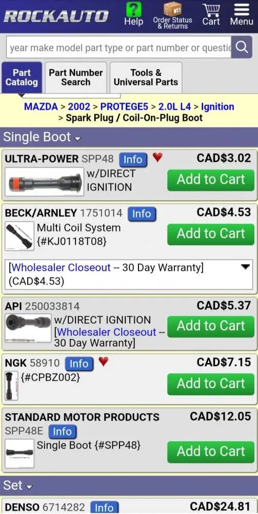

It looks like you can buy just the boot for the coil, so it must be designed to come apart.
If you can manage to get your boot out without buggering it up, you should be able to just pop it back onto the coil.

Do you still have your spring?
I don't see it in your picture.
Yeah, still have the spring.
