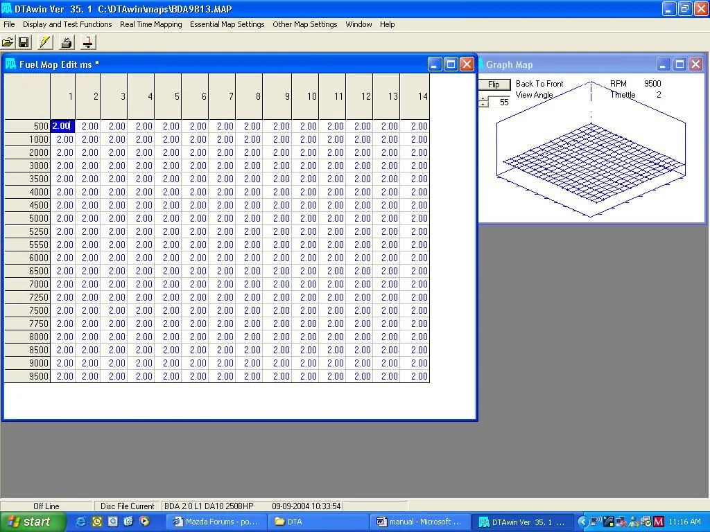

How would you read this fuel map?
The Top columns represent the gears?
The left column should be the RPM.
Thanks for the help guys
Maybe top column is boost and the EMS only kicks in once 1psi is reached?
