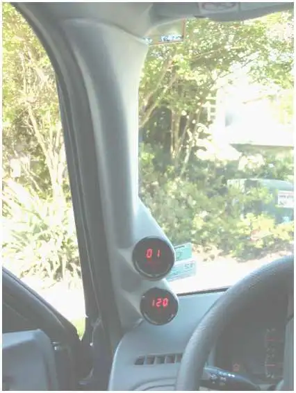

Full pillar pod cover picture
Finally got a digital snap of my installed Auto Meter Full Pillar Pod Cover with Nordskog digital gauges. The top is the boost gauge and the bottom is the air temp (for under hood ambient temp) gauge.
