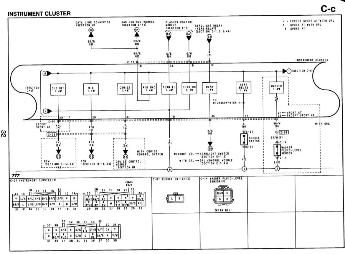

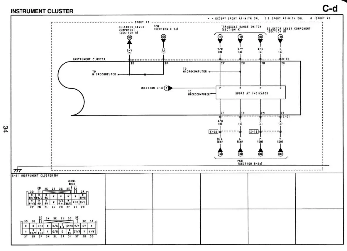

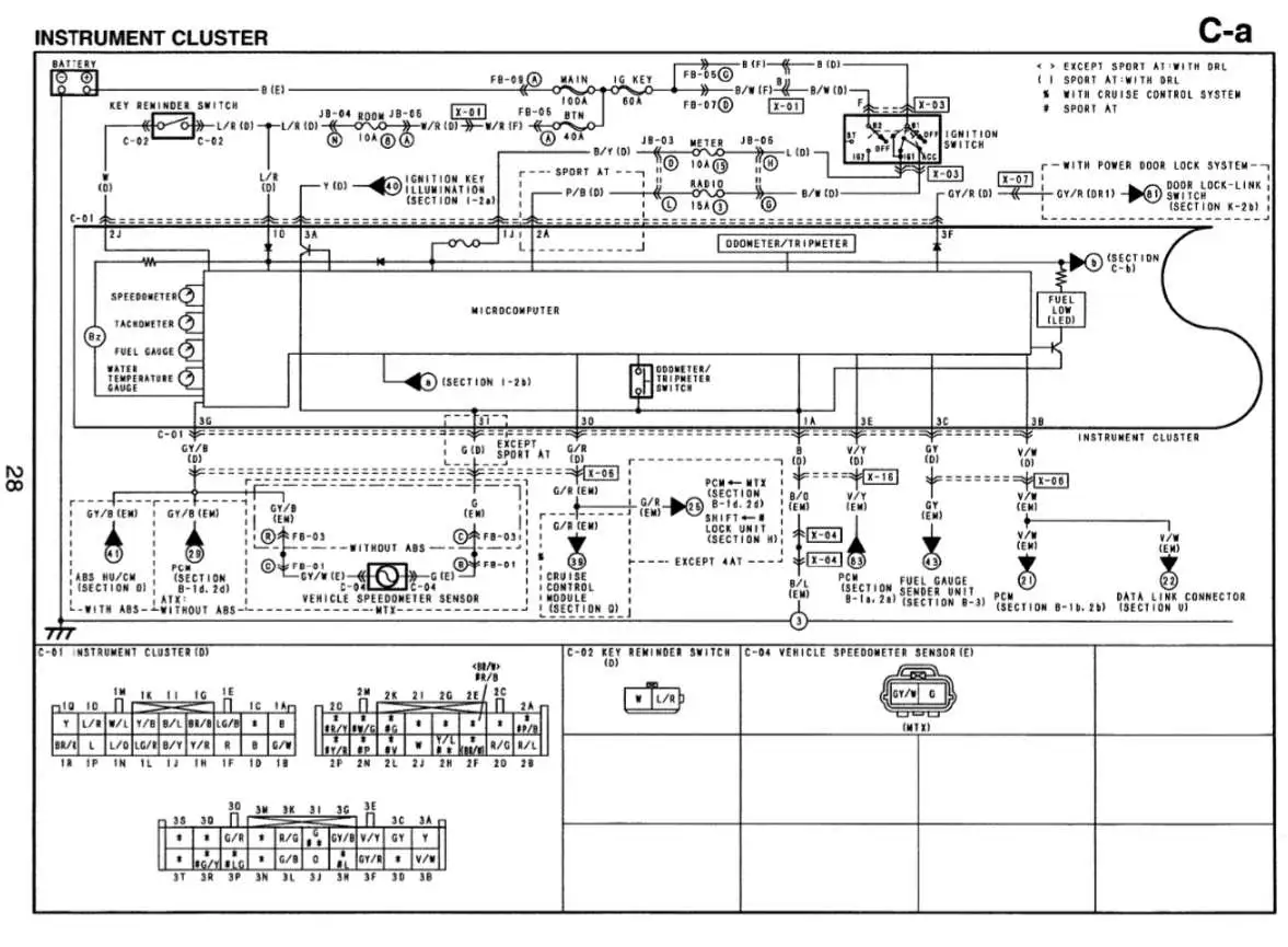

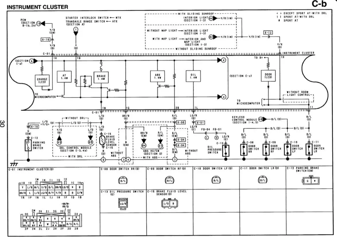

I've got these diagrams for the 2002.5 Protégé5 cluster.
I have no idea about the 1999 1.6l.
