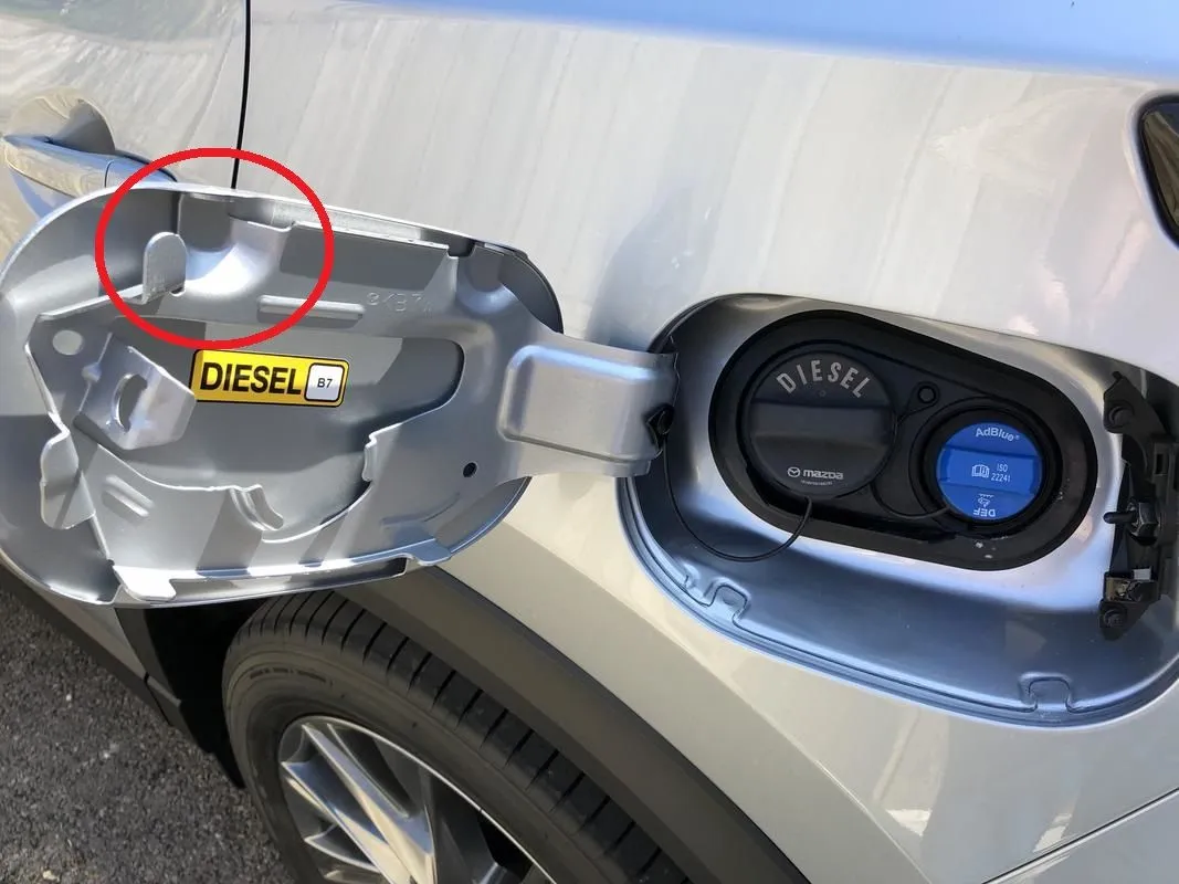

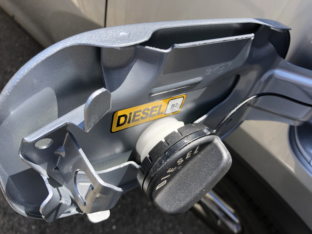

A preview of both.........

A picture is worth a thousand words. Thanks Anchorman!
Since AdBlue Diesel Exhaust Fluid for SkyActiv-D diesel originally was added only to meet US diesel emission standard, I was wondering has the AdBlue also added to existing CX-5 diesels in other regions such as Europe and Australia?
And where should we put the AdBlue cap as theres no cap holder for it? ;) Wait, it seems Mazda did add a metal piece on top of the gas cap holder which looks like AdBlue DEF cap holder?

Def fluid is incredibly corrosive to paint. Id guess you just leave it hanging where it is. But any spillage needs to be washed off ASAP.

Didn't know AdBlue DEF is corrosive to paint. But that rounded frame on gas cap door does seem to be a place to hold AdBlue DEF filler cap.

90% sure it won*t reach up there but I*ll investigate tomorrow. When I filled mine the other night I just hooked it inside the fuel cap strap.

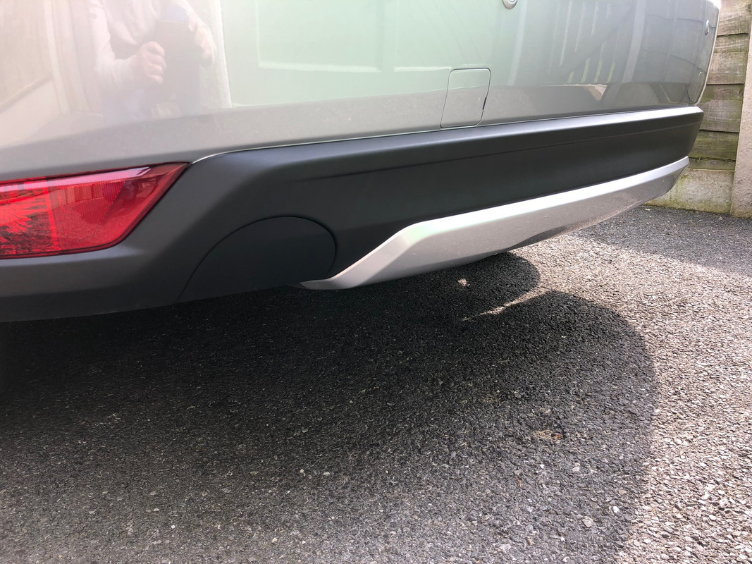

I had an 18 model but got offered a good deal when the GT (you*re Signature I think with the nappa leather) so now have a 19. The 18 was 175 PS with twin exhaust tips. This 19 is 184 PS but because the AdBlue tank takes up quite a bit of space under the floor, it now has a only one exhaust tip and a blanking panel in the bumper. The increase in power comes from new multi phase injectors and a new variable nozzle turbo that go with the SCR (selective catalytic reduction) or AdBlue version so the small hike in power is just a spin off. It has gone from 420 to 445 Nm or whatever that is in Ft/Lbs The production date was mid 18 but they started arriving late in the year. This photo shows the blanking plug;
