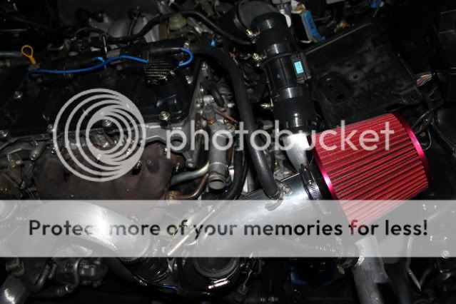

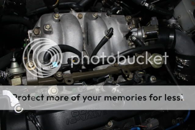

Pictures of the tuck as requested! If you would like more detailed answer you can ask Circuit or myself.
The wires on top of the VC were pushed to the side and then the wires that were on top of the fuel rail was tucked under.
I need some help with one or two things that i forgot where they plug.

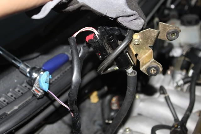

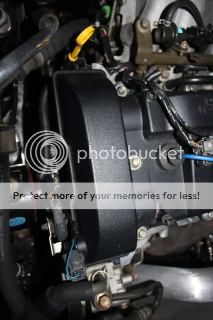

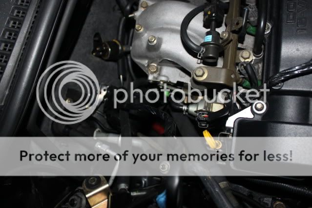

In this picture i can't figure out where the wire that has the blue tap around it goes.. Those wires were located near the top mount for the struts. At first i though it was for the Cruise control but i didn't find a sensor or plug.

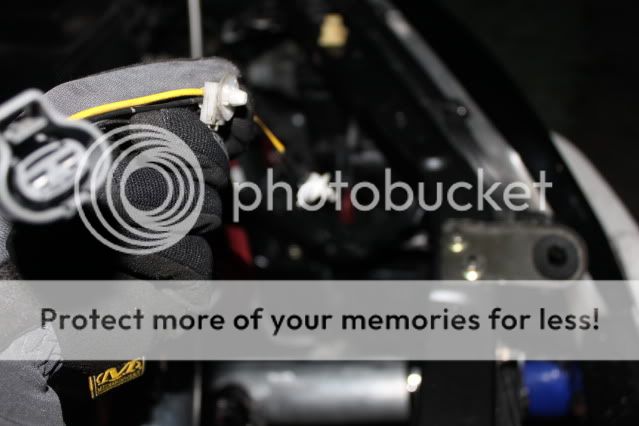

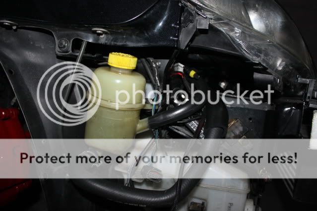

This picture shows a great clip wire from the driver side right about above the headlight. Im not sure where that goes neither.

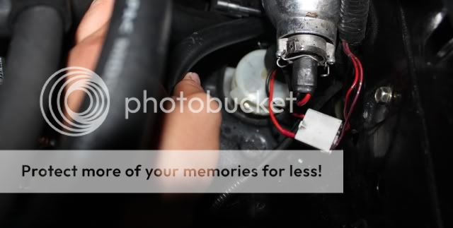

And the last thing is where do i plug the waste gate to. I know the vac has to go somewhere on the turbo but i don't see anything. Definitely need some help with that.

what hose did you use for the ps relocation? is it the factory hose that you have pictured?
I got PS hose from Autozone and factory hose to hook up the PS. The one from auto zone was less than 2 feet. I'll measure it if you really want to know. The relocation definitely makes the bay a lot cleaner. =).

sucks man. btw how are you gonna check/add fluid to your ps?
I already filled the PS bottle and everything seems to be fine. As for check it and filling up again, I can either pop out some screws from the splash guard and check that way. If i wanted to fill it i guess i would have to take off the bumper. It's a cosmetic thing. To me it was ugly to have a yellow bottle out of no where in a black engine bay. definitely looks a lot better where it's not visually seen. I don't mind taking off the bumper to fill it. How often to do you have to change and fill the PS fluid? =D
