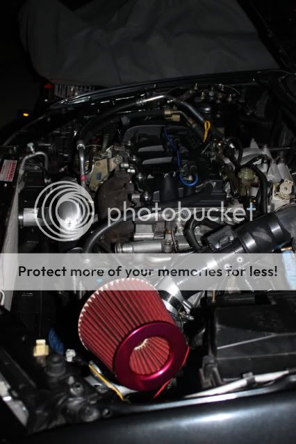

I hope this gives you guys a better picture of my tuck that I'm doing. I also got the pipping for the turbolife all set up. I relocated all the bottles; power steering, coolant, and oil catch. Im still debating if i should go with a short ram because of my DG Air Ram Hood or go with the CAI. Thoughts?

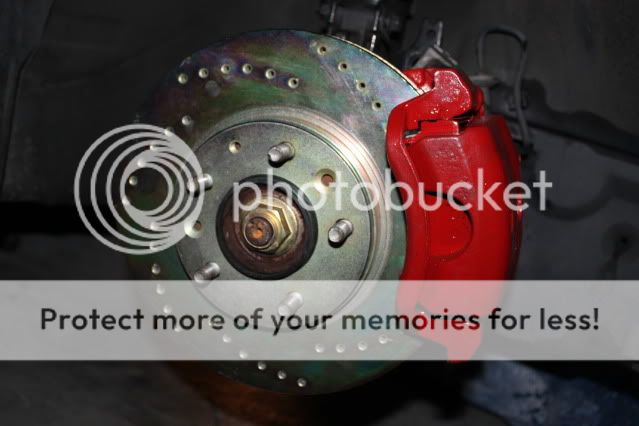

Mazda6 Big Brakes 06-07! Painted them red and got one of the MSP Axles in. The driver side axles isn't working with me. =/

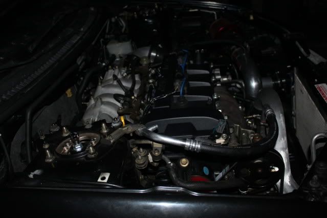

Showing where i relocated the power steering bottle and the Mazda6 Big Brakes. I went to Kragen and i got the wrong size tubing to finish the relocation of the power steering bottle.

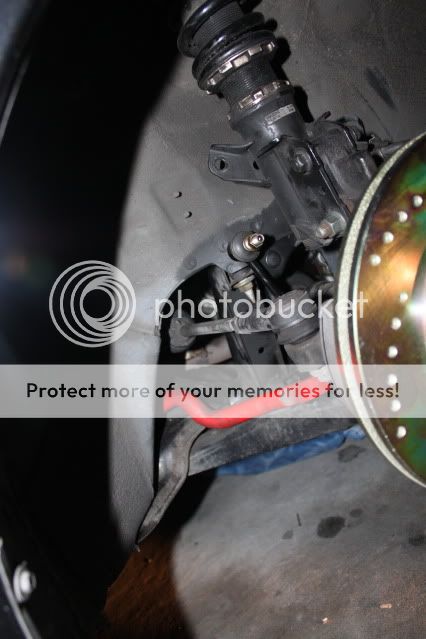

Got the Racing Beat Front Swap Bar in and BC Endlinks(a lot thicker than stock). I gotta say that it was a SOB to get the RBFS installed. Dropping the whole sub-frame and lining everything back up..XD
