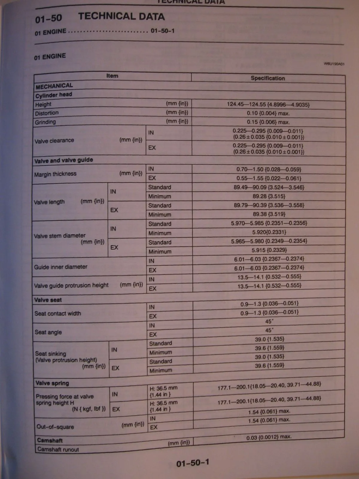

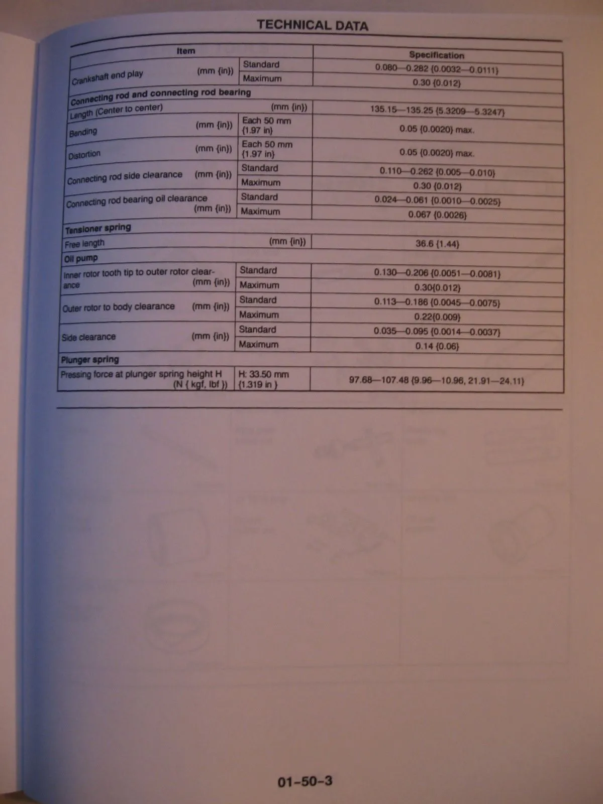

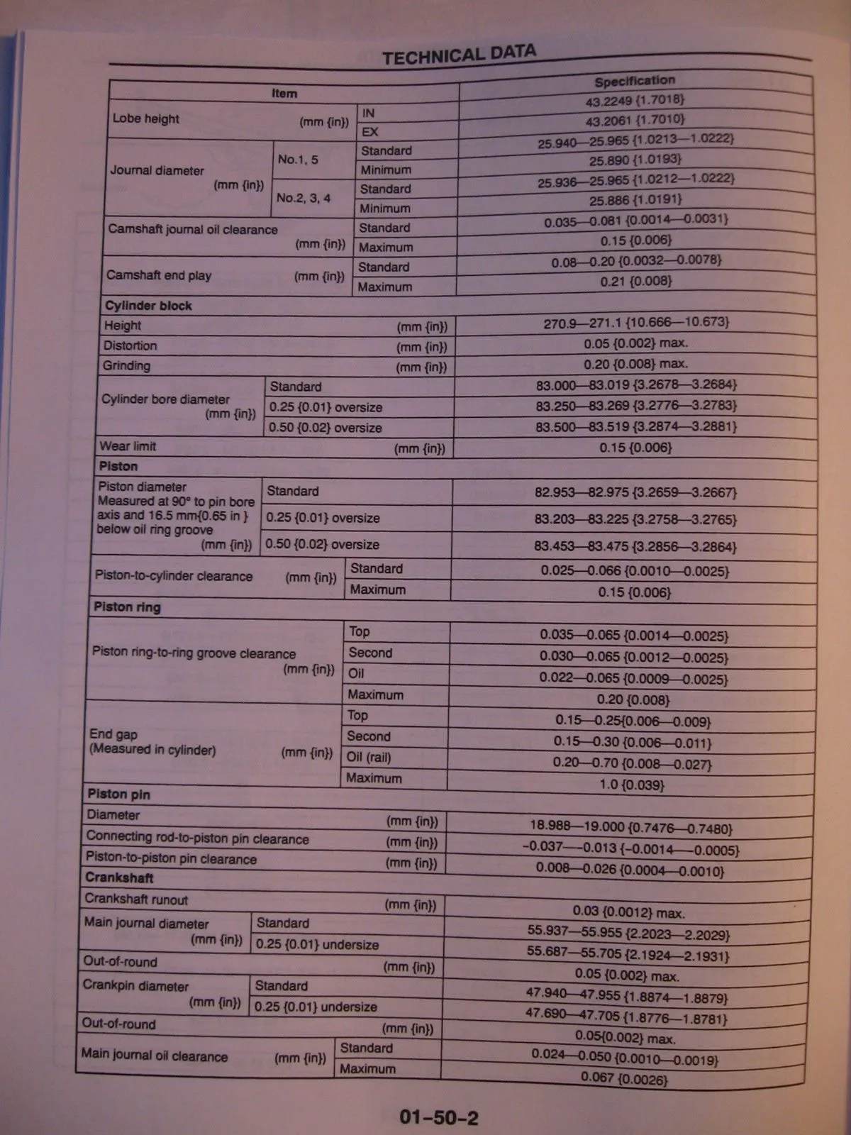

I was looking for this info and it was nowhere to be found.
I ordered the proper FS Engine Overhaul Manual and thought I would share.
These are the Clearances for the FS motor.
I am attaching them as they are large and easier to read that way.
I hope this helps someone out without them having to spend the $35 like I did.
Thanks, ForceFed!
Edit: I thought the rods for the FSDE were 132mm long? the doc you posted says 135.2mm center to center. are rod measured any other way besides center to center?
