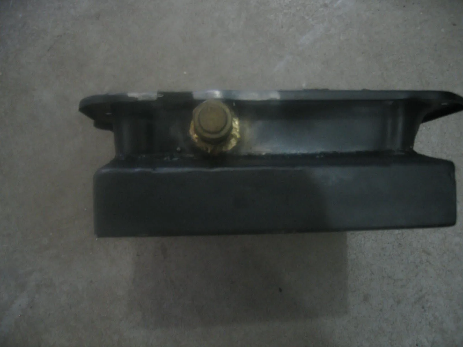

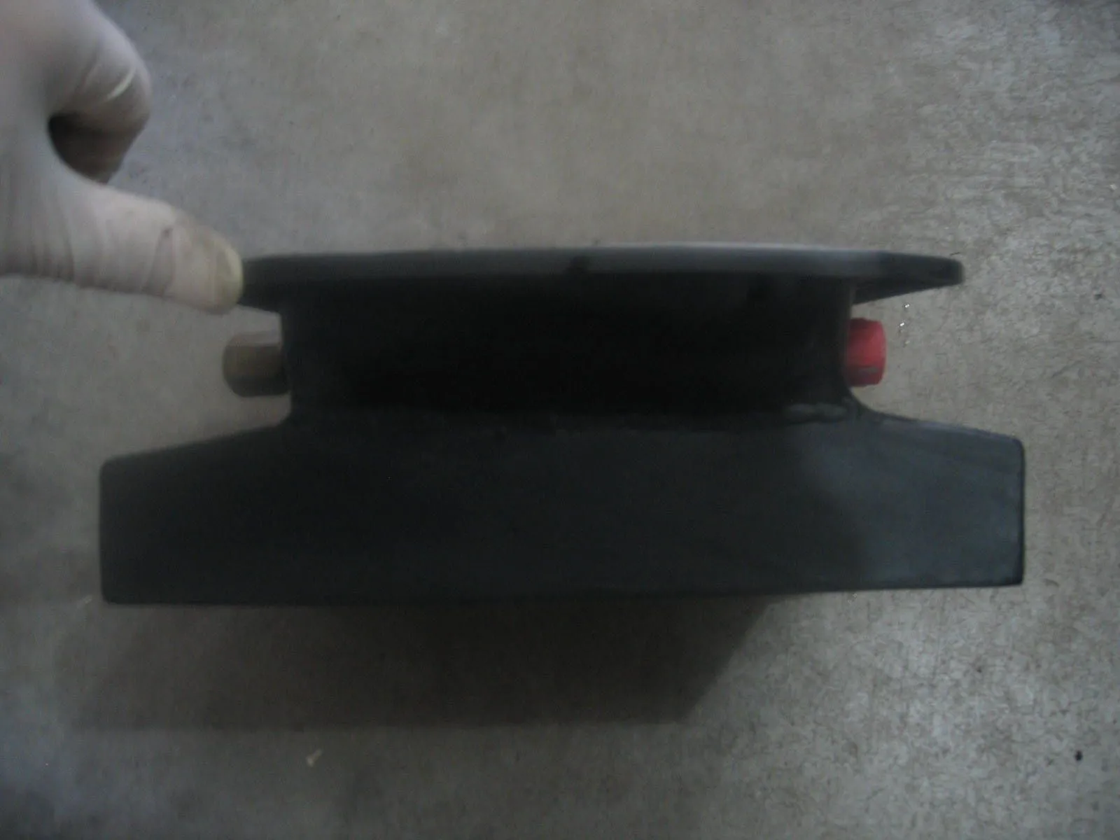

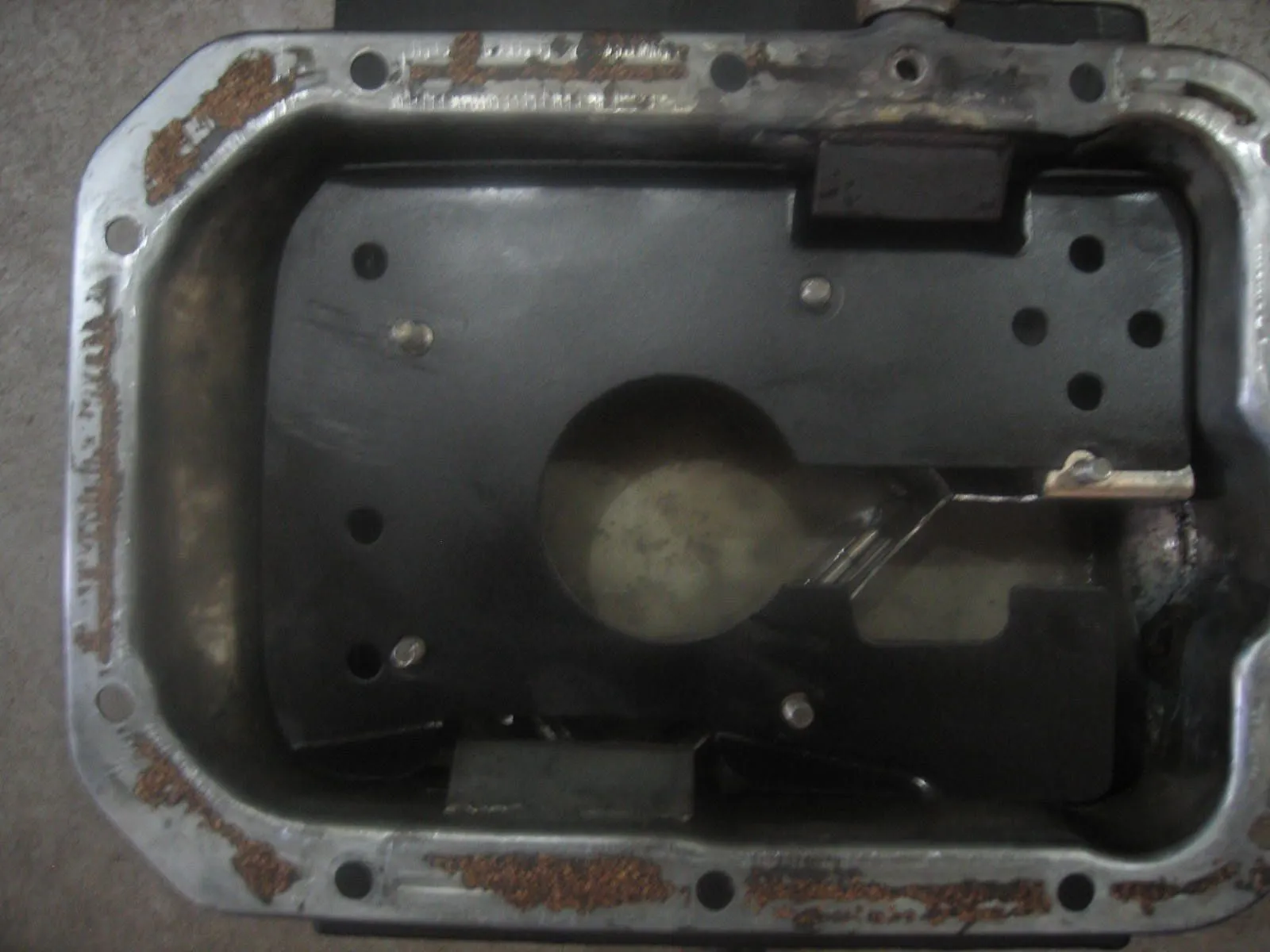

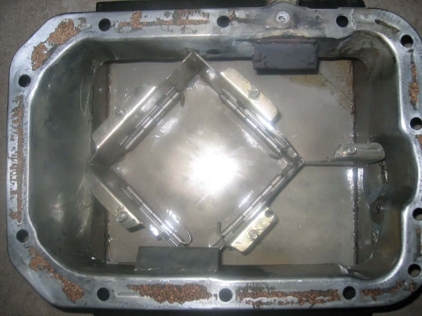

As requested, here are some pics of our current oil pan.....
Pic 1
You can see the "gates" surrounding the pick-up that swing only inward to keep oil around the pick-up in turns
Pic 3
This is with the baffle plate in place. Also notice the baffles over the inlets on each side for the turbo oil return and the external PRV bypass return. The keep the oil off the opening to the pan to allow free flowing returns.
Pic 4
Pic5
These are external pics. Notice the "Block Body Emitter" coating to help with oil cooling!

Yes, we used the OE oil pan bolt flange, but it is custom fabricated from there....
We are not really looking to offer these pans as they are quite labor intensive and not really intended for street use as they do require maintenance to keep them from leaking.....
Pictures posted as requested to "get a look" at what we are currently using....
Is the oil leaking through the welds?
Yes, this is very common with custom made pans. The mig/tig welds tend to leak a bit, especially with synthetic oils. Just takes a bit of brazing to get it all sealed up. I think you can see the new brazing in pic #4.
