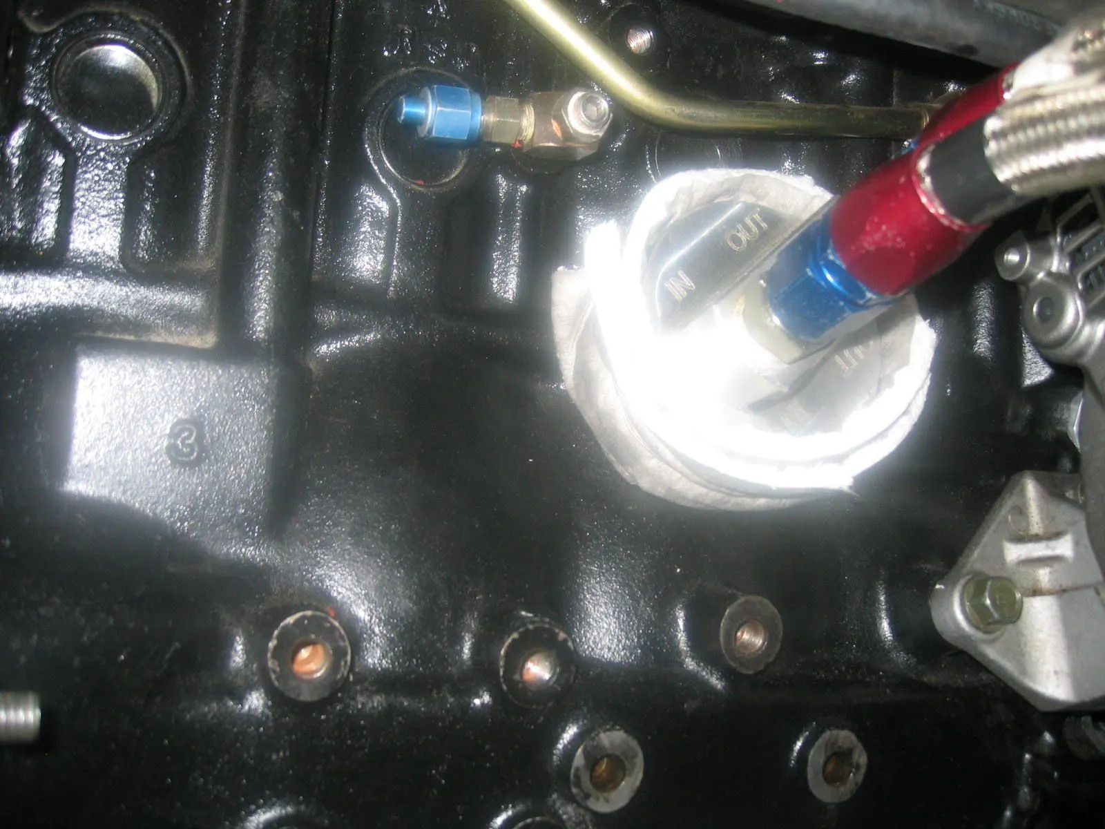

So I assume this utilizes as sandwich plate of some description? Do you guys also run an oil cooler, if so, is it air or water cooled? I'm curious because I want to run an oil cooler off a sandwich plate on the back of the block and I'm wondering if this might get in the way or vice versa. I also need two ports for oil temperature and oil pressure - man I'm running out of places to put things!
We use a relocation adapter rather than a sandwich plate. A sandwich plate is designed to allow the use of the OE oil filter on the back side with two ports coming off at a 90 degree angle. For our race motors (and any performance motor) the OE size oil filter is woefully inadequite. Also, making a 90 degree bend in that short of a distance creates to much resistance to flow. Therefore, we use the adapter shown in the pic below. (BTW, the material wrapped around it is a precaution for any possible leaks. It is a flame retardant absorption material.) It has straight through flow and we use a remote filter mount to allow use of a much larger filter. You can get a remote filter housing with addition ports for your sensors.
In regards to oil cooling, yes we do run a cooler and it is an oil to water cooler or a "heat exchanger". We did not go with an air to oil cooler because with the large intercooler out front there is no more "clean" air to make an air to oil cooler effective and we did not want to decrease the effectiveness of the intercooler.
Ok, I follow that. I wonder if it would be possible to run a sandwhich plate underneath that for some pressure/temp senders? Man I'm just trying visualize everything. This kit is great but I just wouldn't know where to put my oil pressure/temperature senders with this in place. The temperature sensor can go anywhere as oil flow really won't mess with its reading but the pressure sender needs to be in a "dead end" like the stocker. I suppose an oil-to-air intercooler could always just be run inline with any of the braided steel lines as well as the temperature sender.
I wouldn't run anymore than either the sandwich plate or the relocation adapter. Stacking them is just asking for a leak! You may be able to tap the relocation adapter or a sandwich plate for an additional sensor mount...
I read an article the other day by one of the NASCAR engineers that the factory oil pressure sending unit position is always the best place to get a good reading so I would stay with it there. If you decide to run a remote oil filter usually they have provisions for sensors built-in.
We run the oil lines out of the adjuster into the cooler. Out of the cooler to the filter and out of the filter back to the motor. This way we know the motor is always getting good filtered oil.
