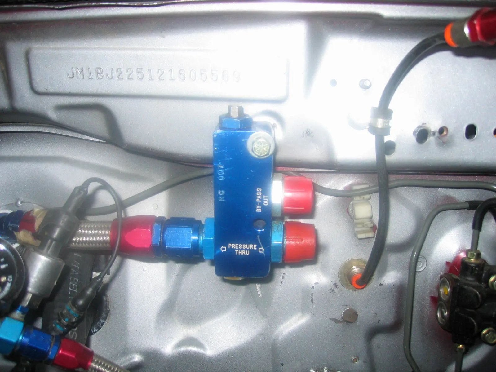

Here is a pic of our external pressure relief valve....
The size is about 1.5" X 4.5" without the fittings
