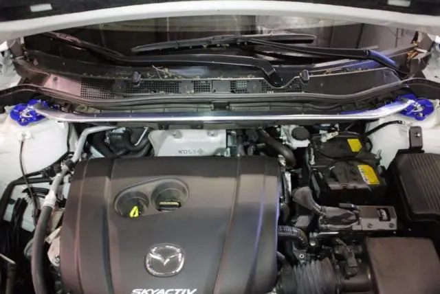

Don't get that multipiece bar. You want a rigid bar; ithey are made like that so they can easily resize it for different cars. OEM bars on high performance cars are almost never multipiece. The ultra racing bar is about $130 shipped, rigid and chassis bars are what they specialize in.
This is why you don't want multi=piece

Chris, what are you referring to as the multi piece bar? The one with the removable end mounts?
Getting my strut bar from MEAGAN RACING. Yes they do serve a purpose and yes I drive my CX5 hard, it does stiffen the chassis. People on here that say NO... are not knowledgeable about suspension geometry. If you reinforce ANYTHING it will be better. That along a rear sway bar will make a world of difference. So if you put-put around town...no bars needed.

I have read, that the one piece is more rigid, than a three piece, like the one in that picture.
Yep that's right. A fully welded single piece will be more rigid than a multi-piece bar.
