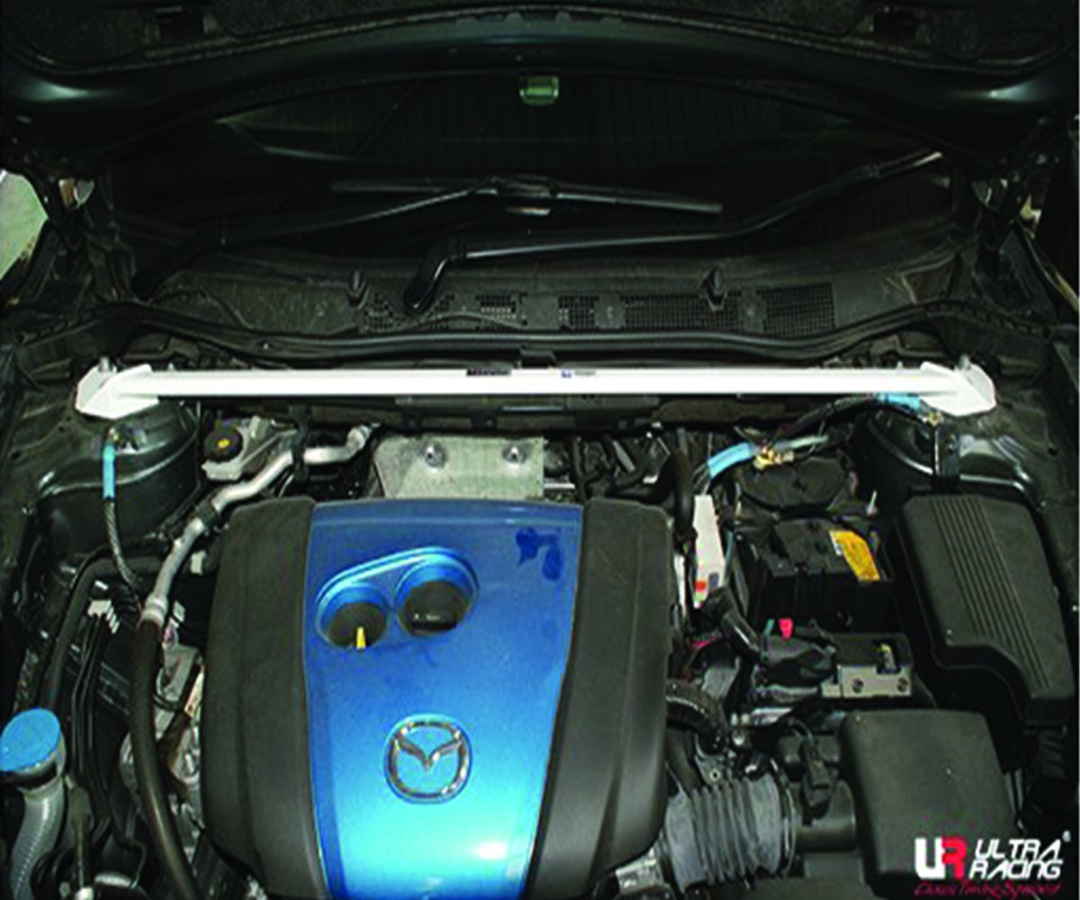

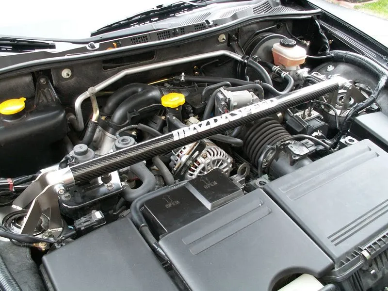

Pardon the confusion, but do both Megan and Ultraracing front strut bar fastened down to the vehicle via bolts? I'm confused about where the welding is for Ultraracing.
Ultra Racing:
Megan Racing:
Now, these are photos from different model years, but the main difference is visible. Both bars bolt to the upper strut via 3 bolts on each side, but the Megan bar has 2 additional bolts that can be used to tighten or remove the bar from the end braces that bolt to the upper strut. That makes it a multipiece bar. The Ultra Racing bar doesn't have these 2 additional bolts - instead the bar and the end braces are all welded together.
Ultra Racing:
Megan Racing:
Thank you for the clear explanation. I understand now.
