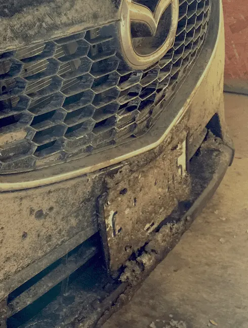

There are two circular indentations in the front bumper where you can drill the holes. If you look at the picture of my front plate you can get a general idea of where to drill the holes if you decide to do it yourself.

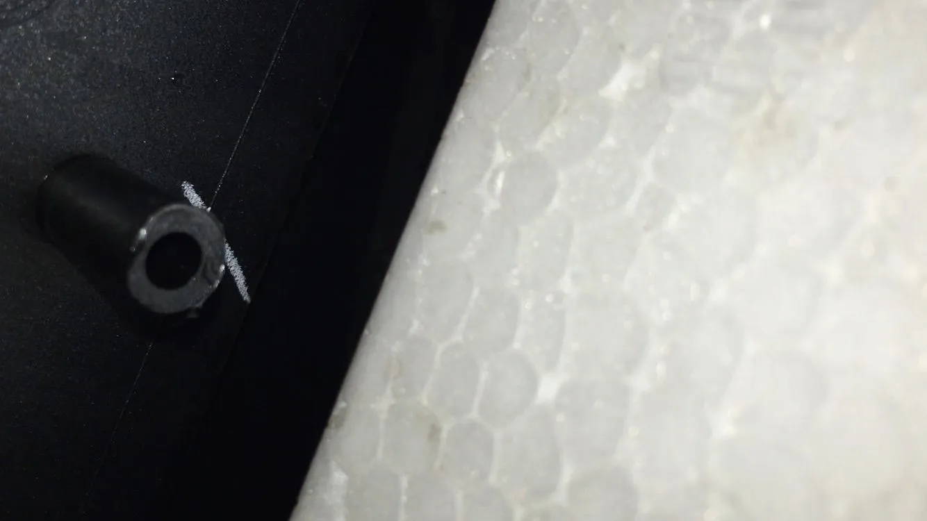

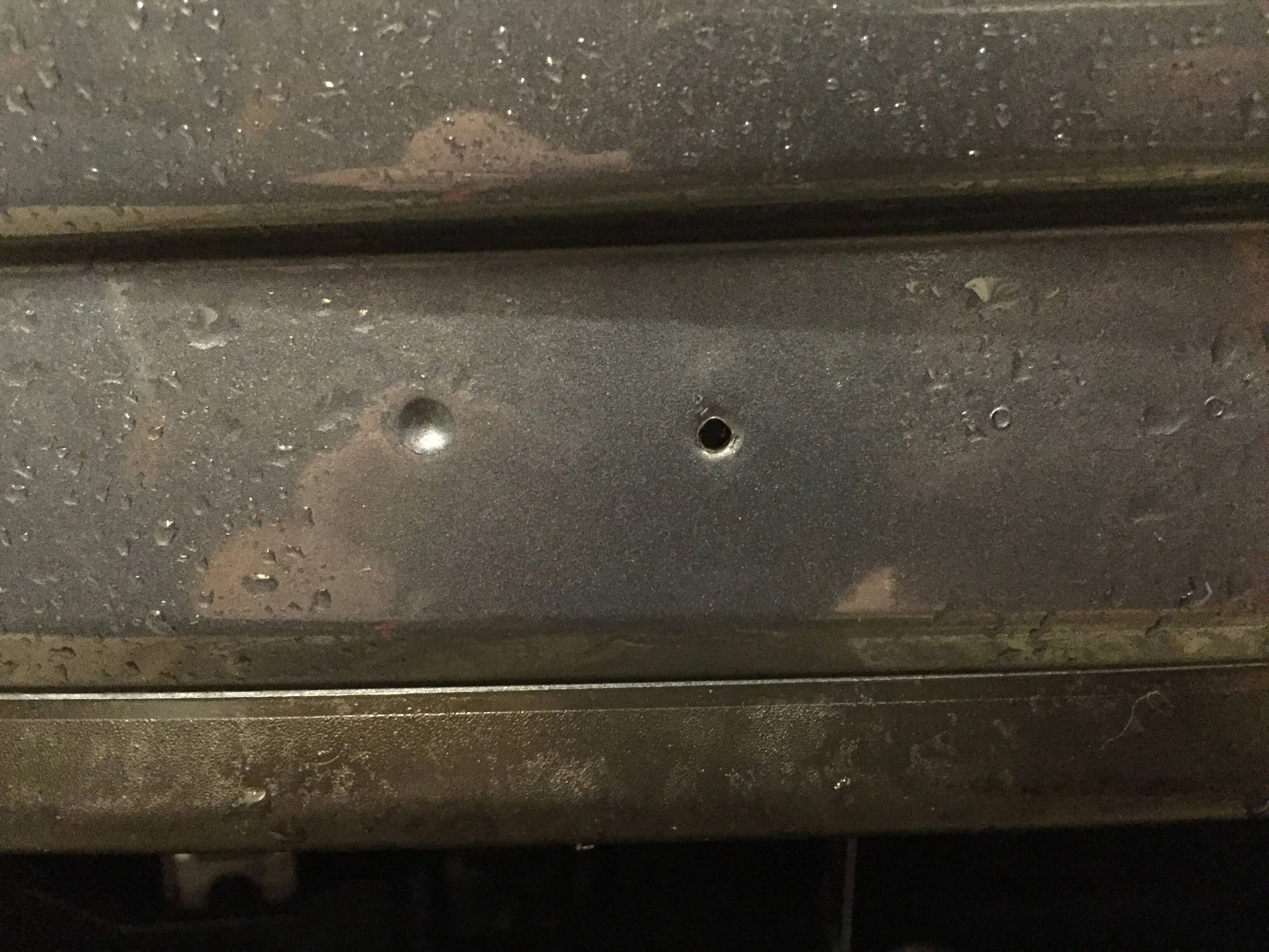

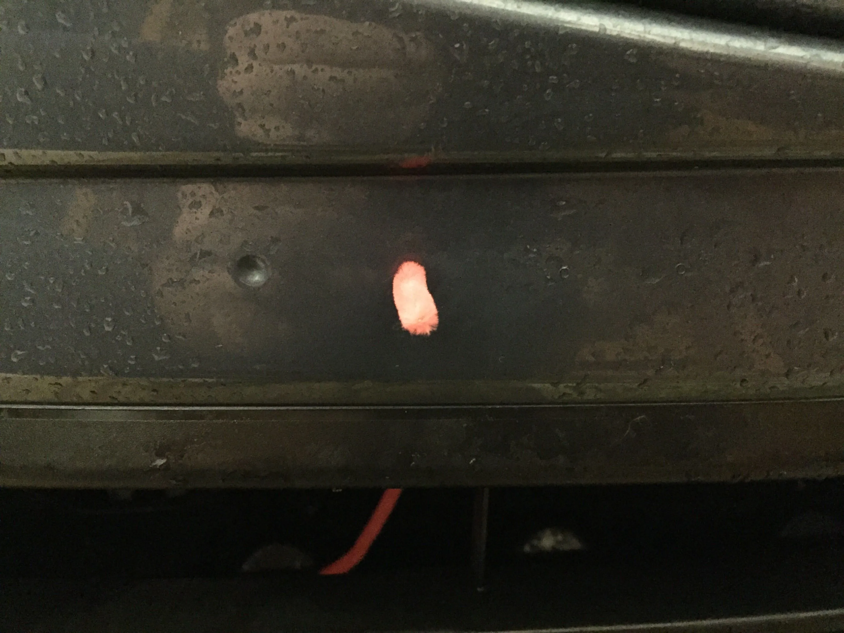

So my plates finally came in today - I drilled a small shallow hole in the dimple, just enough to pierce the plastic bumper and saw it felt hallow after doing so. I took a picture under the bumper and as you can see the piece that is behind the dimple is hallow in the middle? How is a screw supposed to hold the plate? I pushed a pipe cleaner through and you can see it goes all the way in.
Do I find a screw that's slightly larger then the hole but not large enough crack it? Seems like an awful design - why wouldn't they add something threaded behind there like how the rear plate mounts?

You can use something similar to a wood screw that will bite into that hollow tube. I wouldn't worry too much about cracking the plastic because it's relatively soft, as long as your screw isn't too big.
3
Machine screws aren't the right type for this application.
I had no idea there were those tubes behind the dimples, I thought the screws went straight into the plastic and only had a thin wall thickness to hold onto. The tubes definitely give more strength to hold the license plate.
I had a pack of hex-head 1" #12 self-tapping screws laying around. I put them on and it went on snug, but not tight. They still turned pretty easily with the wrench - although it was tight enough that I couldn't un-screw them by hand so I guess that should work.
