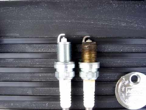

update: got the new plugs in...asked the parts guy at Advance Auto for the plugs to a 1998 Honda CR-V EX (ZFR5F-11).
I don't notice any gains in power or anything, but the car definitely runs a lot smoother. Idle is a little lower (I think...maybe I just didn't realize how low my idle is) and starting into 1st gear at a red light or stop sign is as smooth as butter. Also, acceleration seems to be smoother too. It's kinda hard to describe, but everything just feels great! Definitely a great "mod" (2thumbs)
Attached: pic of the long reach ZFR5F-11 versus the stock BKR5E-11

when i laid the plugs next to each other, the "long reach" plugs that i got, did not seem longer than the ones i had in there.
but the ones that were in there were filthy as crap, so its a good thing i swapped them out.
Only point was that it isn't just pop off the wires & unscrew the plugs if you don't have the 1.8 setup because you have to unbolt the coils to get to 2 of the plugs. The long reach plugs are only longer from the top of the threads to the tip of the electrode & not very much longer either.
