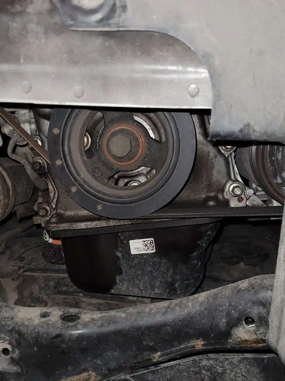

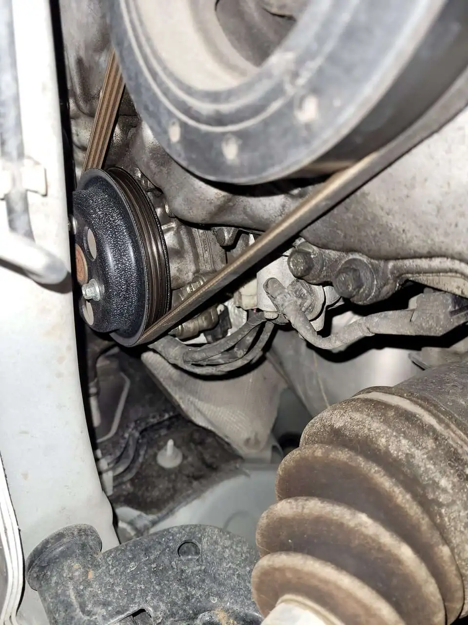

Hello fellow mazda owners. I was doing an annual service on my 2019 CX-5 2.5 FWD and an oil leak caught my eye. I removed the splash cover for the crank pulley and followed the staining up to whatever that pulley is for i the second picture. At first I thought it might be coming from the oil pan but odd that the stain would go up. Any ideas what that pulley attaches to? It's not a bad leak at all as none of the plastic under trays have any staining nor is the dipstick reading lower than it should but it'll start slow and get worse with time. I do all general servicing myself as the local dealers haven't done a very good job. I only mention that becuase I can already see the local dealer putting up a fuss about this if I bring it in for them to warranty. Thank you for any help!
Timing chain cover gasket leaks are not unusual on earlier model year Skyactiv engines, and that would be my primary suspect on yours as well.
Looks like it. Dealer wanted $1700 to fix it for my '14 Mazda3.
I told them, "Thanks. No deal."

UPDATE... I just returned from the dealership with a diagnosis of an oil leak in the seal at the timing cover. They did a dye test and also checked for a cracked cylinder and luckily there was no evidence of that issue. The service manager said they have had a "few" of both issues in the CX5 2.5 L engine. He said the majority of the cylinder cracks are showing up between cylinder 2 and 3. The repair will be done next week once they get the timing cover sealant in stock.
Thanks for the update. You don’t have cracked cylinder head right now doesn’t mean you won’t have it later on your 2.5L NA with CD. More common problem on the 2.5L NA with CD is the hydraulic lift adjusters. Mazda has issued TSB and Service Alert, and be alert on HLA’s clicking noise and don’t wait until it’s too late.
Yes, based on the pictures and videos we’ve seen, the external oil leak from a cracked cylinder head on the 2.5L NA with CD happens on the back side near cylinder #3.
From some member’s experience here, such repair may not work due to the complexity of the repair procedure outlined on the TSB.

UPDATE... I just returned from the dealership with a diagnosis of an oil leak in the seal at the timing cover. ... The repair will be done next week once they get the timing cover sealant in stock.
Just an FYI (if you're not already aware) that these timing cover gasket jobs are sometimes done with less than 100% success. In particular, the RTV setup wait time is critical, and the working window is often very narrow. Also, the multi-pass torque sequence is another potential stumbling block as well. And the third common failure point is not waiting the required amount time (usually overnight) for the RTV to fully cure, before refilling fluid.
Yes, any job can be messed up, but the reason I'm singling this one out is that a good portion of the timing cover gasket area is very difficult to see, particularly with the vehicle on the ground. And this means that a minor gasket weep might go unnoticed for quite a while, particularly if the fluid can accumulate in some hard-to-see location on the engine.
So this is a recommendation for you to do careful monitoring of the entire timing cover gasket area of the engine, for an extended period of time. An inspection camera can be very helpful to get a look a some areas which are otherwise inaccessible. Hopefully they will do a great job on your vehicle, but it's never a bad idea to be vigilant, just in case.
