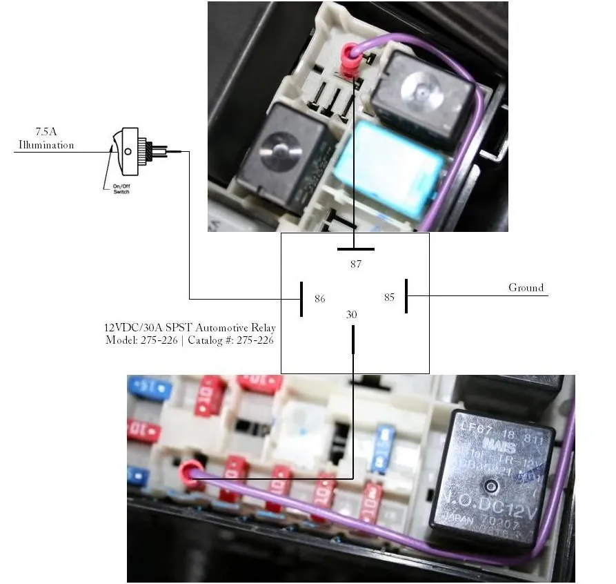

I have the factory HID's and i settled for a similar version of jam_asian85's in that other thread. I didnt like the idea of the fogs being on all the time and wanted some control though. I picked up a 12v relay from radio shack and put it in between the connections in the engine bay fuse box. I did have to run a wire from the glove box fuse box (labeled Illumination) to trigger the relay to turn the lights on. I also put a switch on that illumination wire so even with the parking lights on I can still turn them off. I have been running this for about a year, no issues.

not sure if you could take a pic of the engine bay relay setup? this is great...
When you hit the switch for the fogs, somewhere in that car, a wire goes hot, or a relay flips, something happens. The question is, does nothing at all happen without the headlights on, or does something happen and the addition of the headlights then causes the circuit to close on the foglight relay? If it is the first, then someone with a wiring diagram, a test probe, and plenty of spare time needs to figure out what change occurs. If we know that, then we can work out an add-on harness to give complete control over the fogs through the factory switch.
I made up a diagram of what I did. I hope this helps. I borrowed the pictures from jam_asian85's post. Hope you dont mind :)

so instead of using the aftermarket switch you could attach that relay wire to the factory switch assuming you can find it in the handle with the lights. awesome
