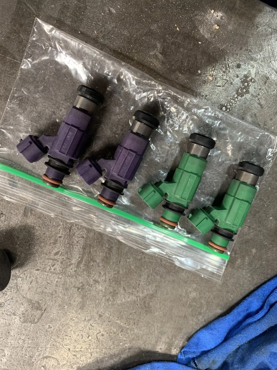

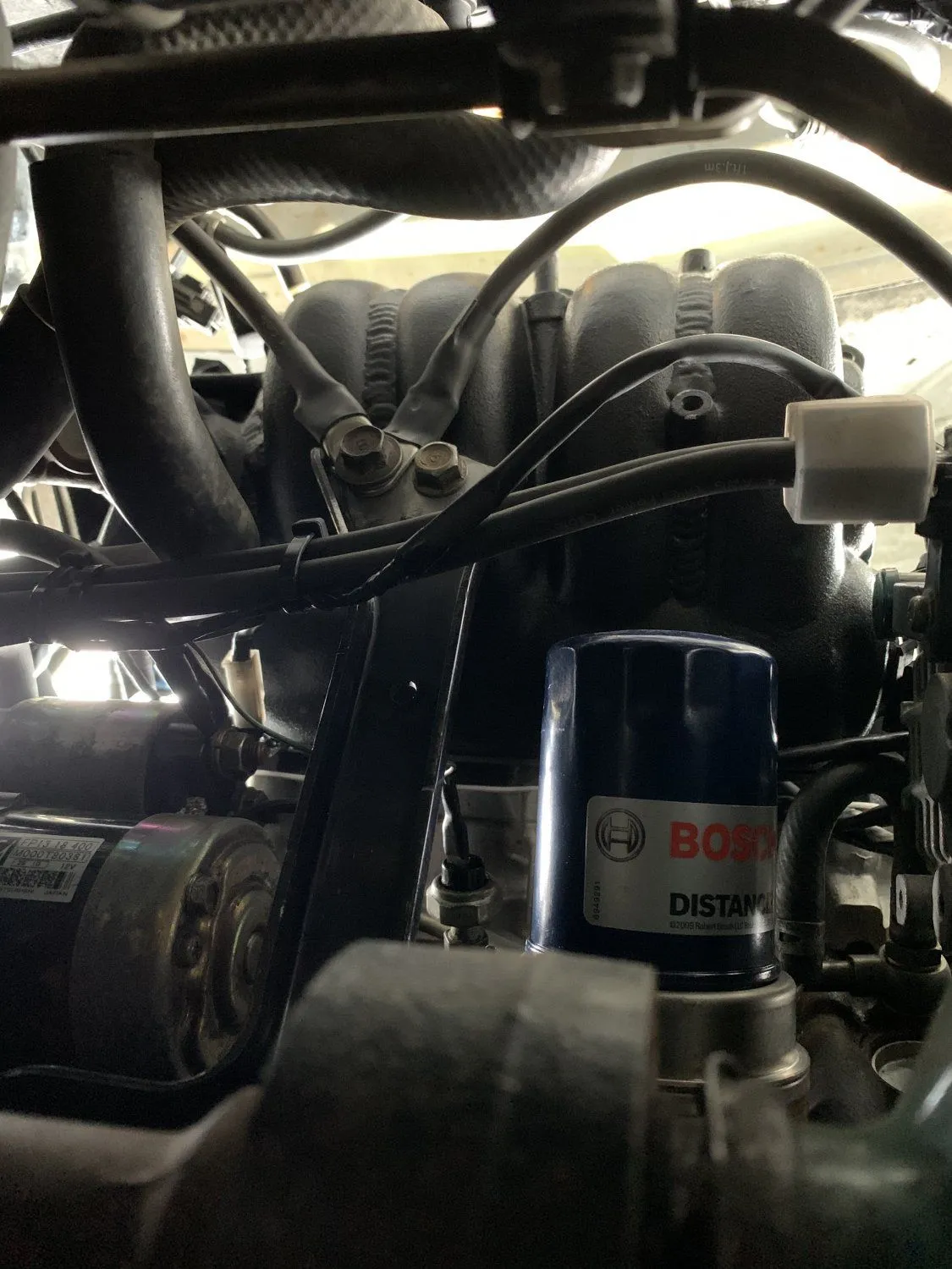

What are the benefits of the 626 injectors?

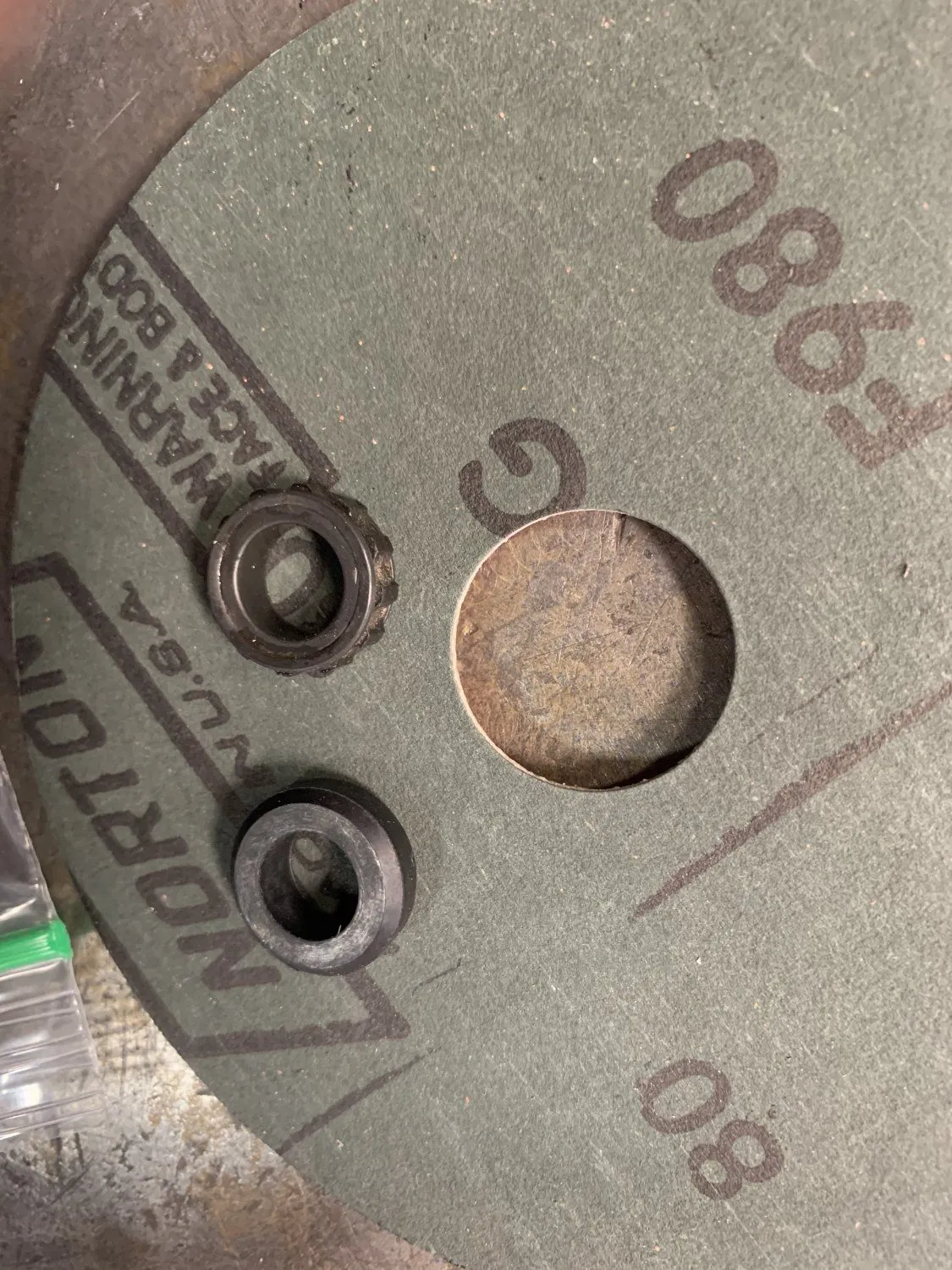

The seals are 626 and the injectors are Msp. The 626 had a full rubber seal instead of the half plastic half rubber that Msp came with. The 626 Seals are less likely to leak.

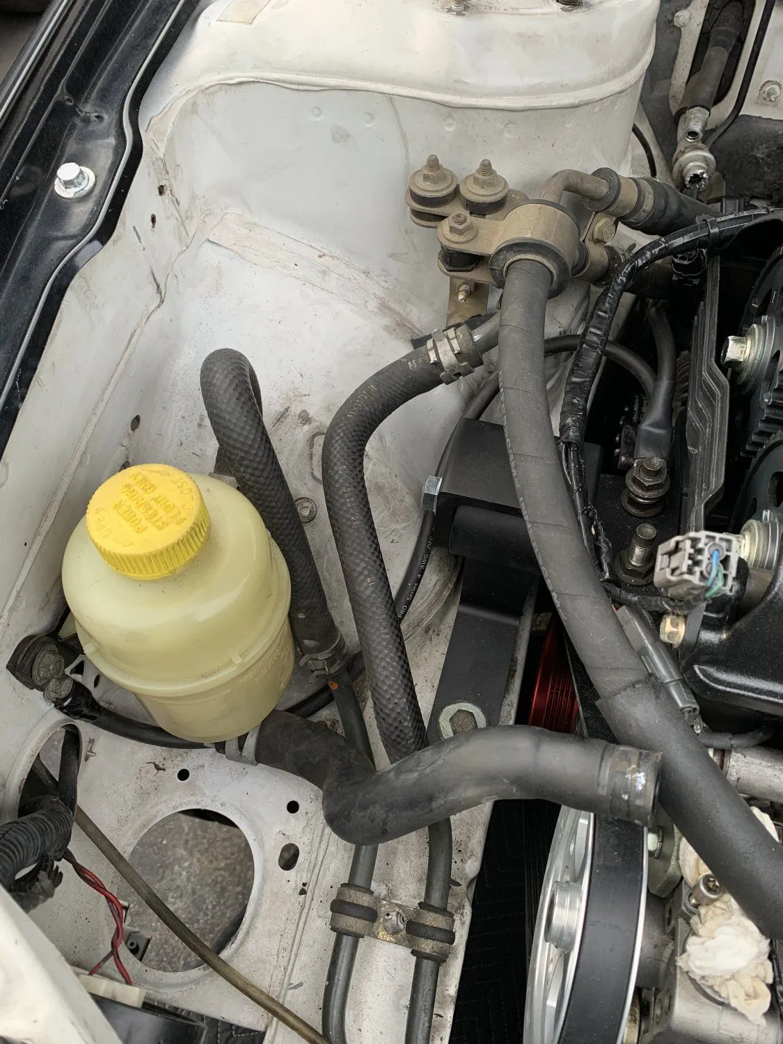

The wheels clear the shocks but are tight on the fenders. I still have to dial in the ride height and camber.

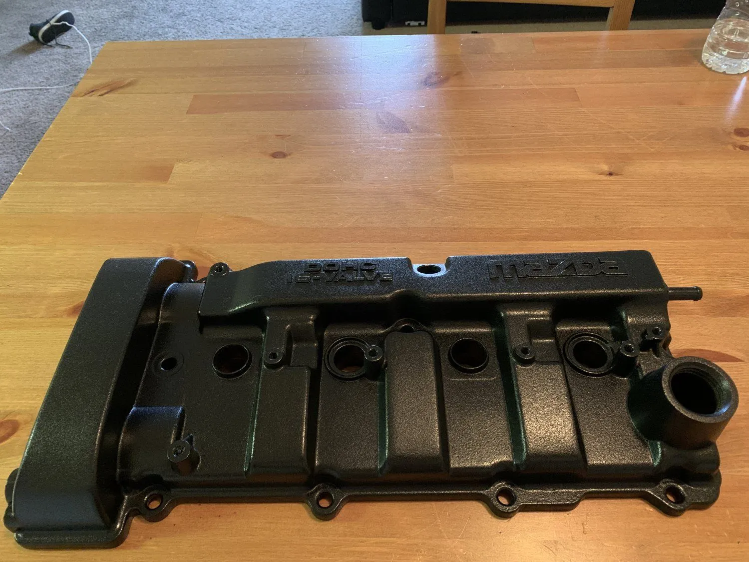

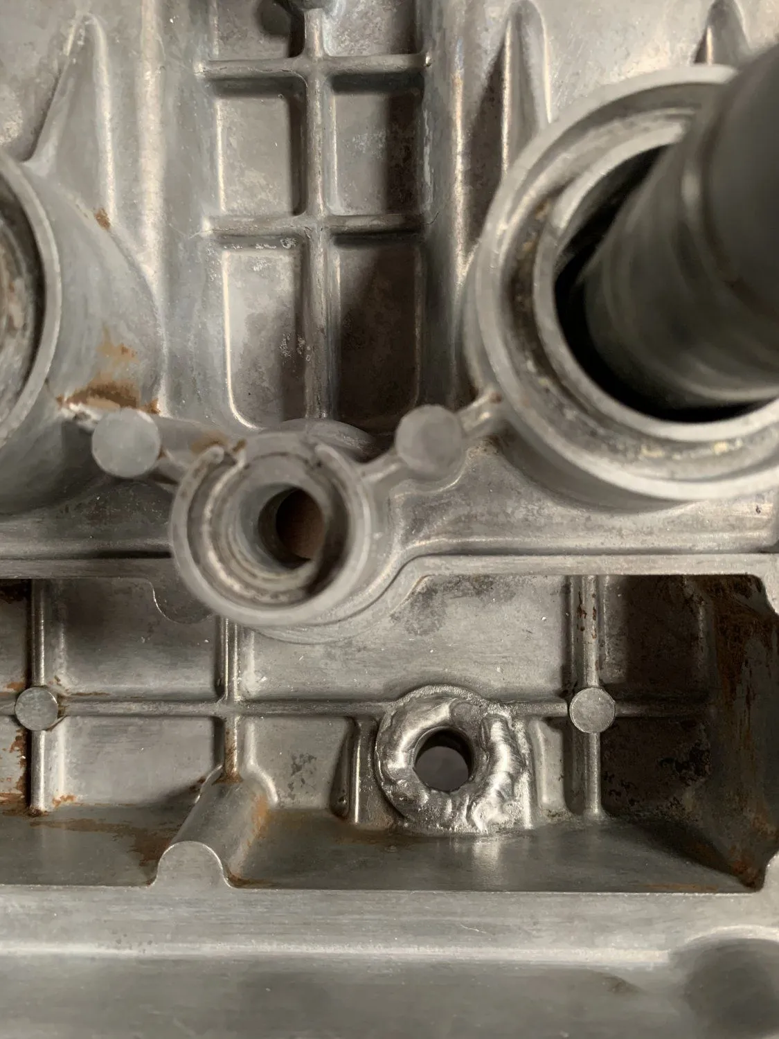

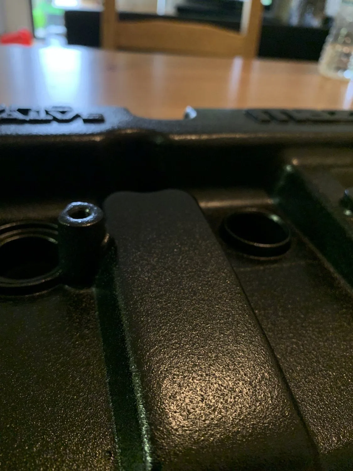

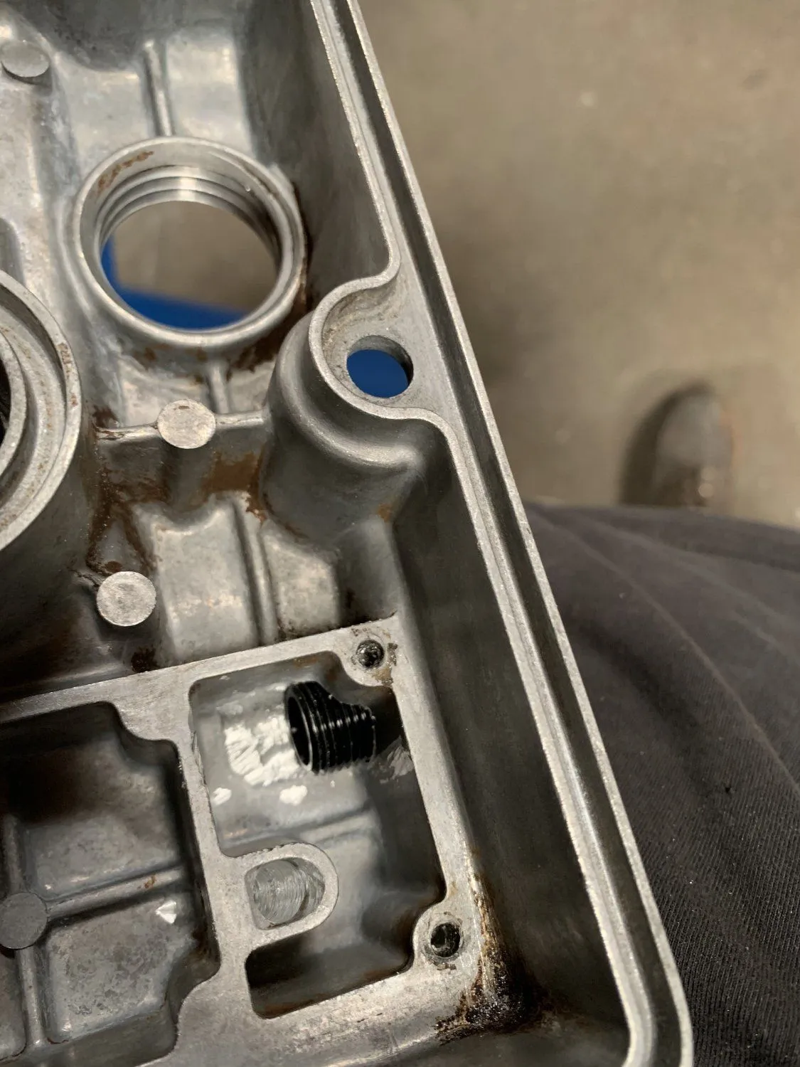

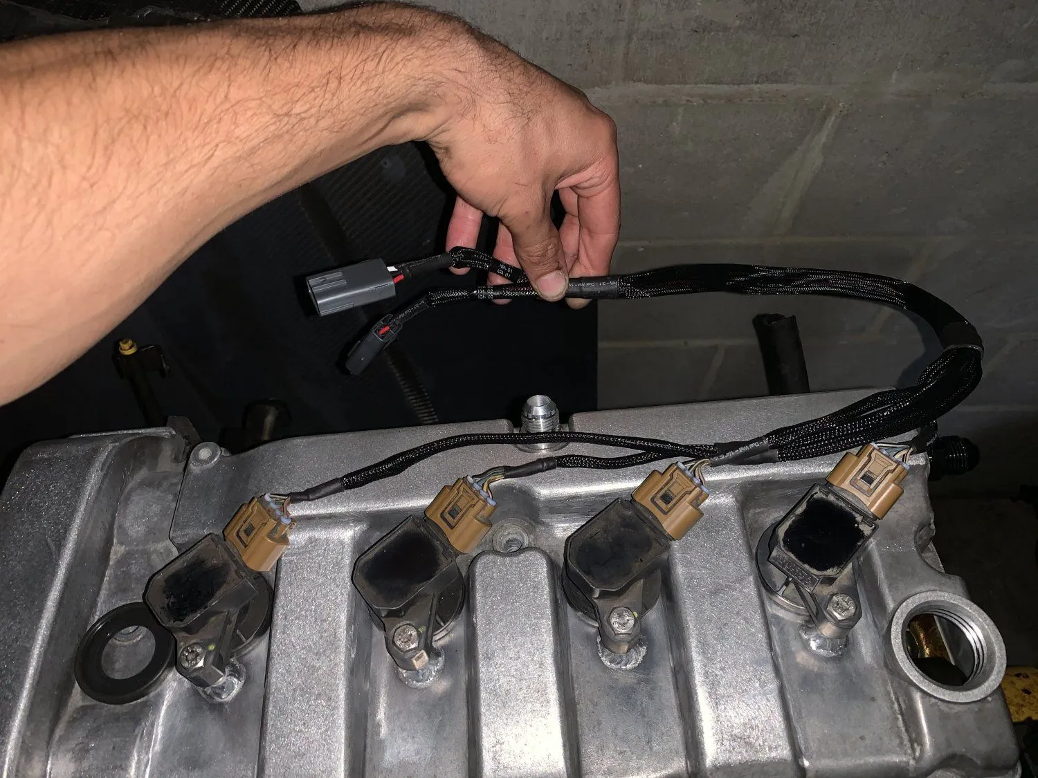

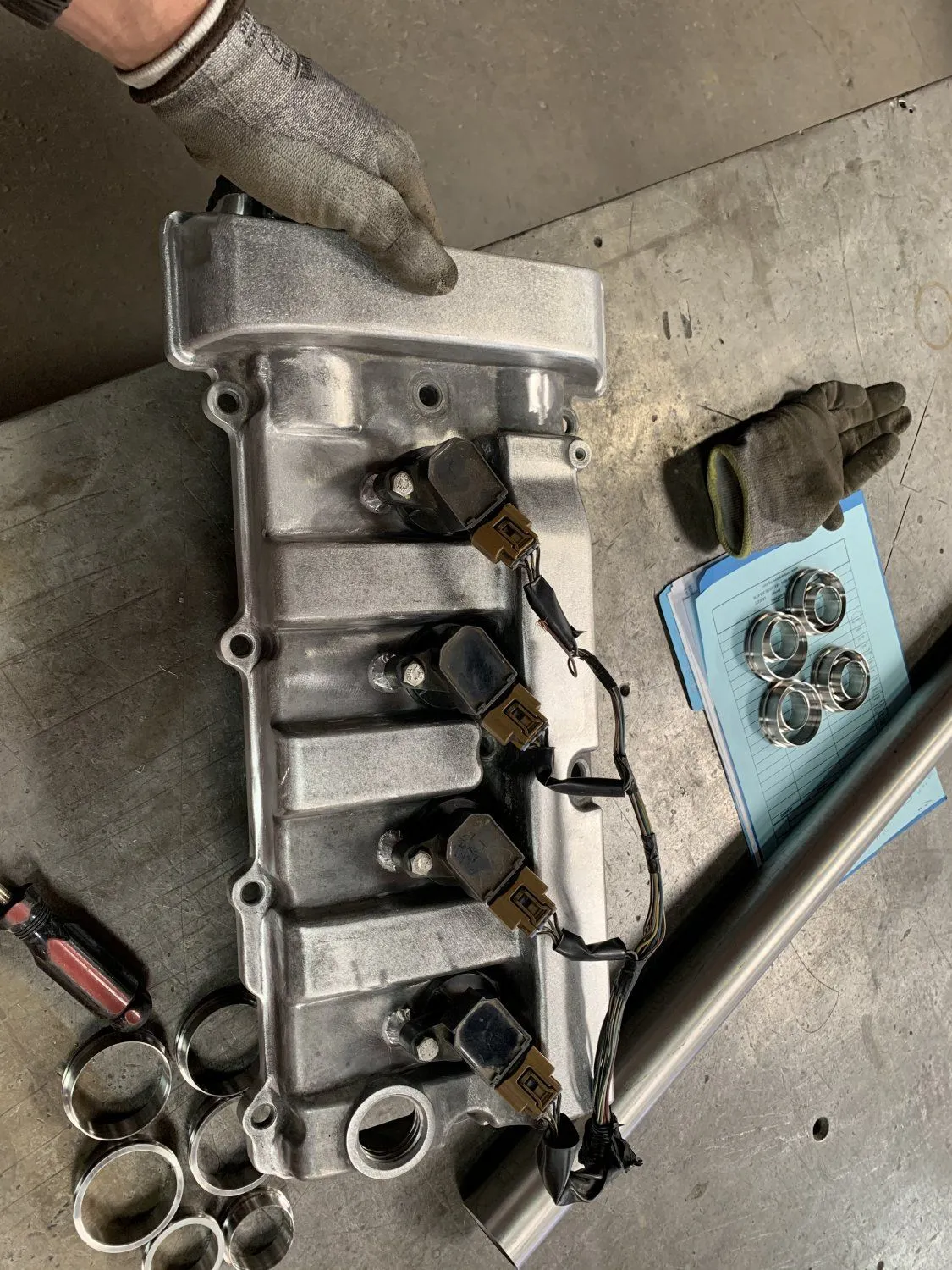

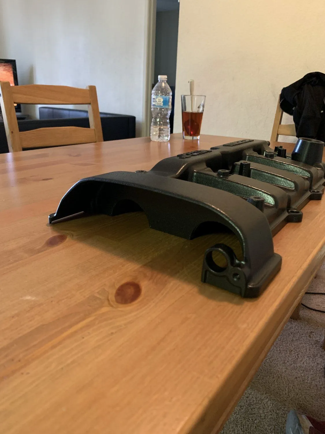

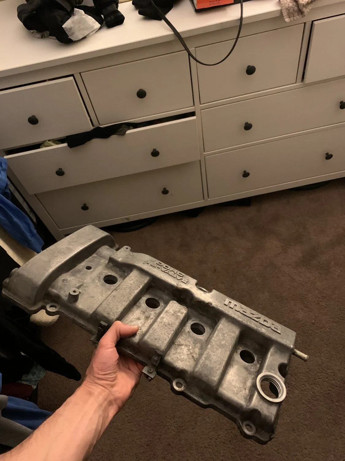

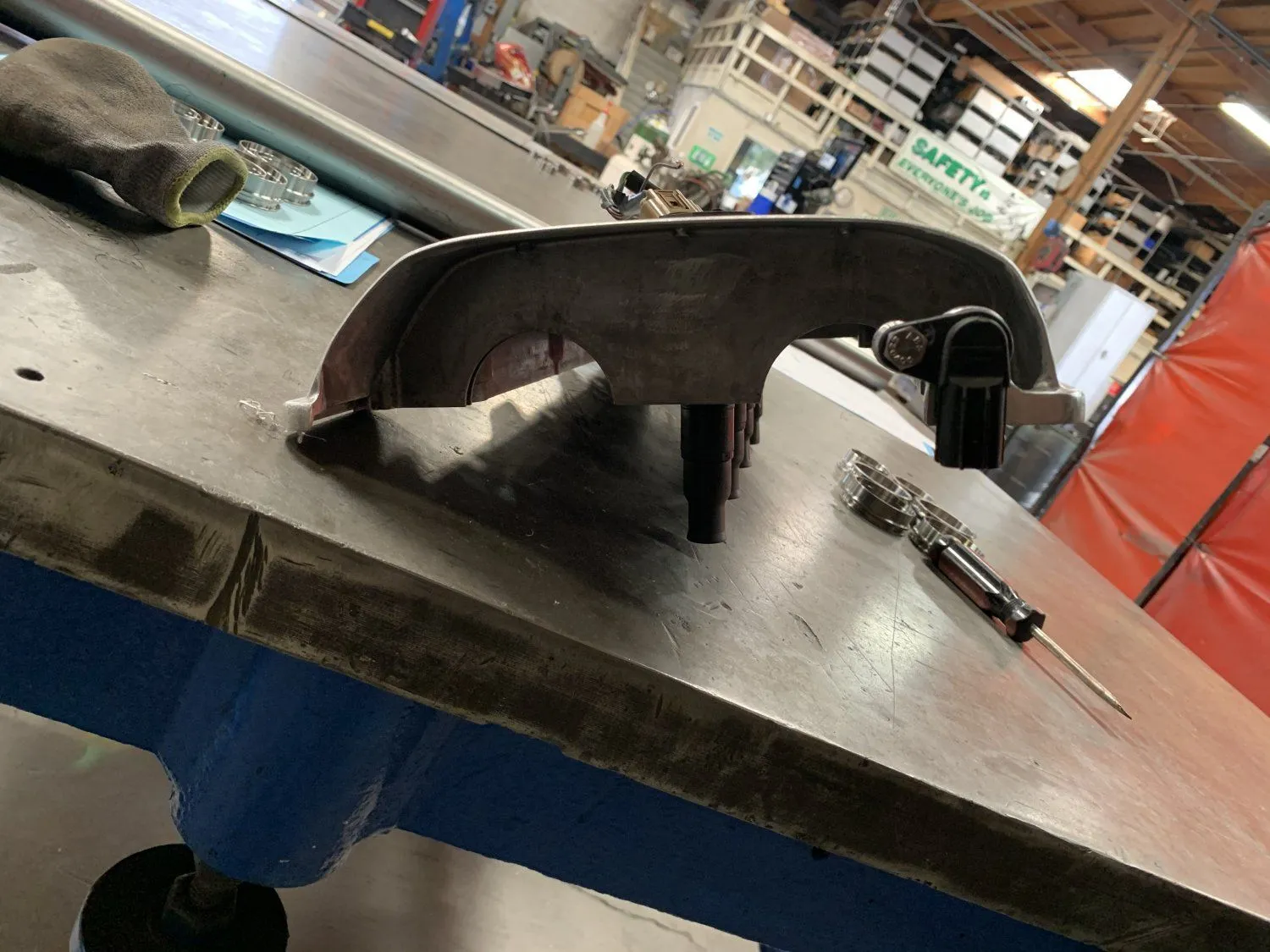

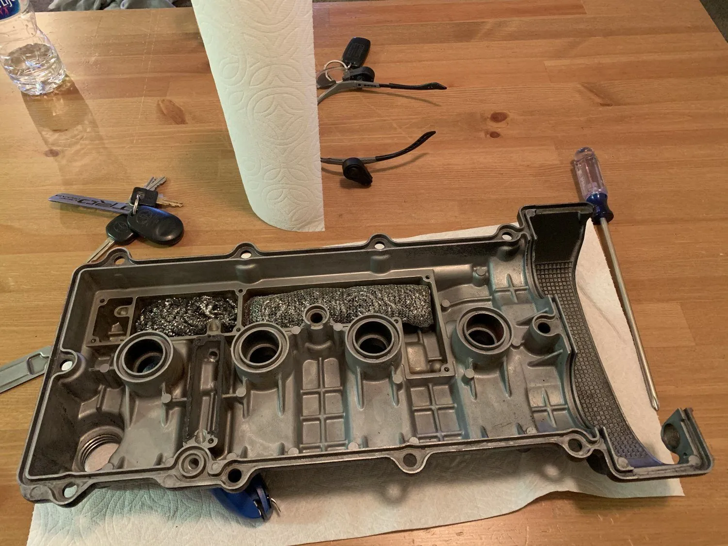

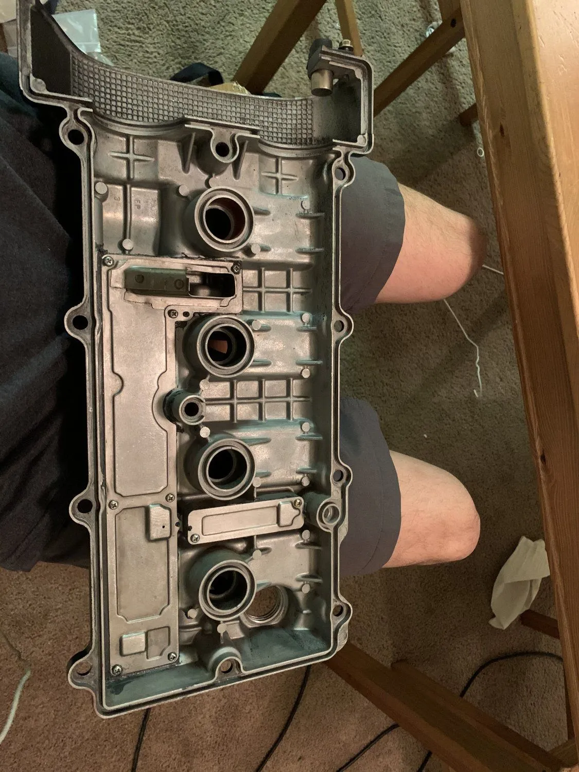

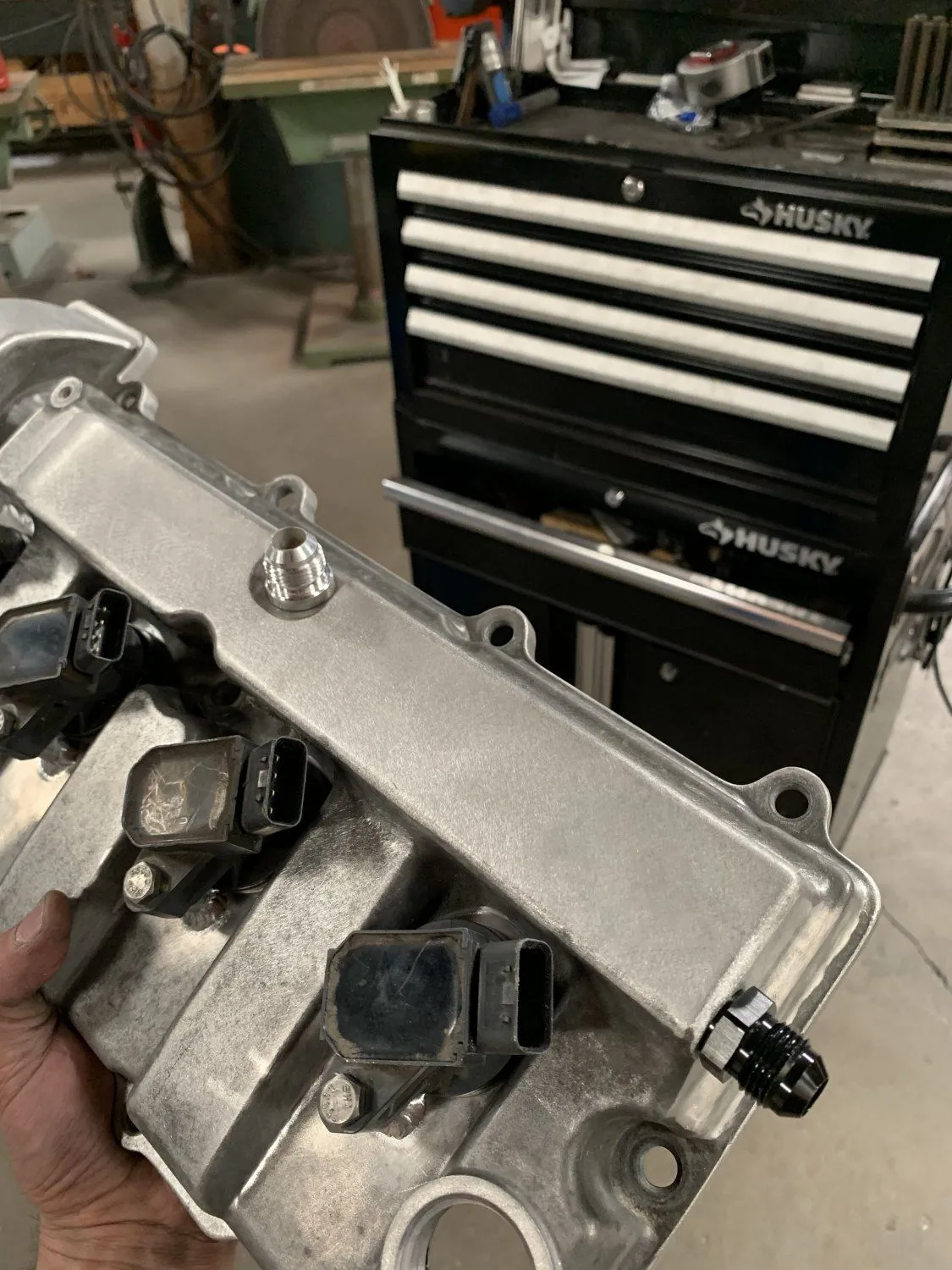

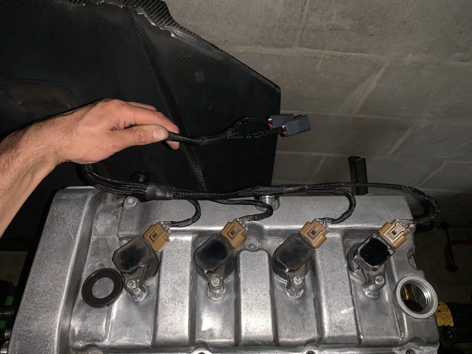

626 valve cover w/ Toyota coil on plug conversion, flipped cam position sensor, cam cutout, shaved, ported, -8AN fitting, harnessed performance plug and play harness. Waiting to be installed. Currently working on a battery tray that features a high out amg battery and oil catch can system

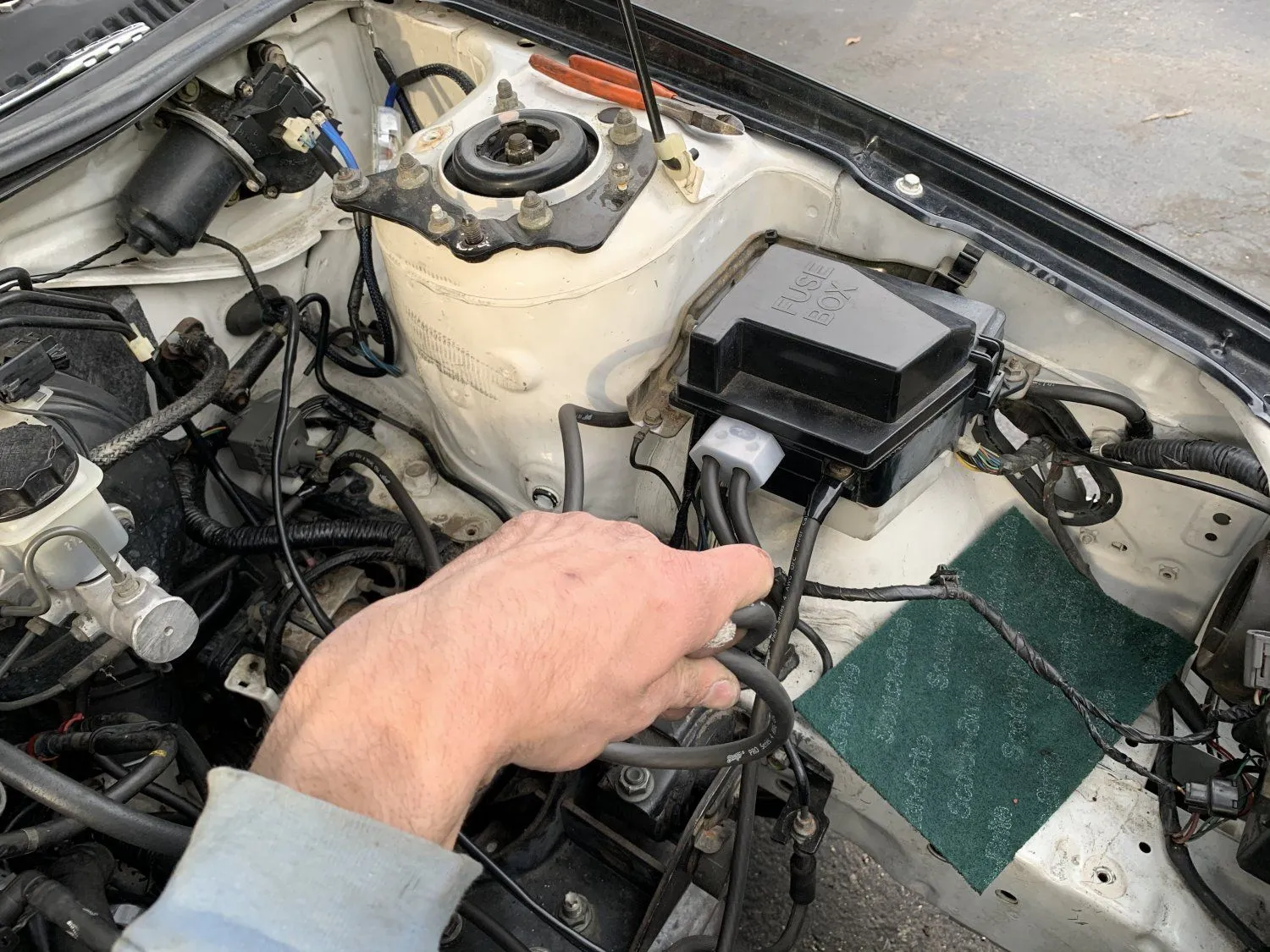

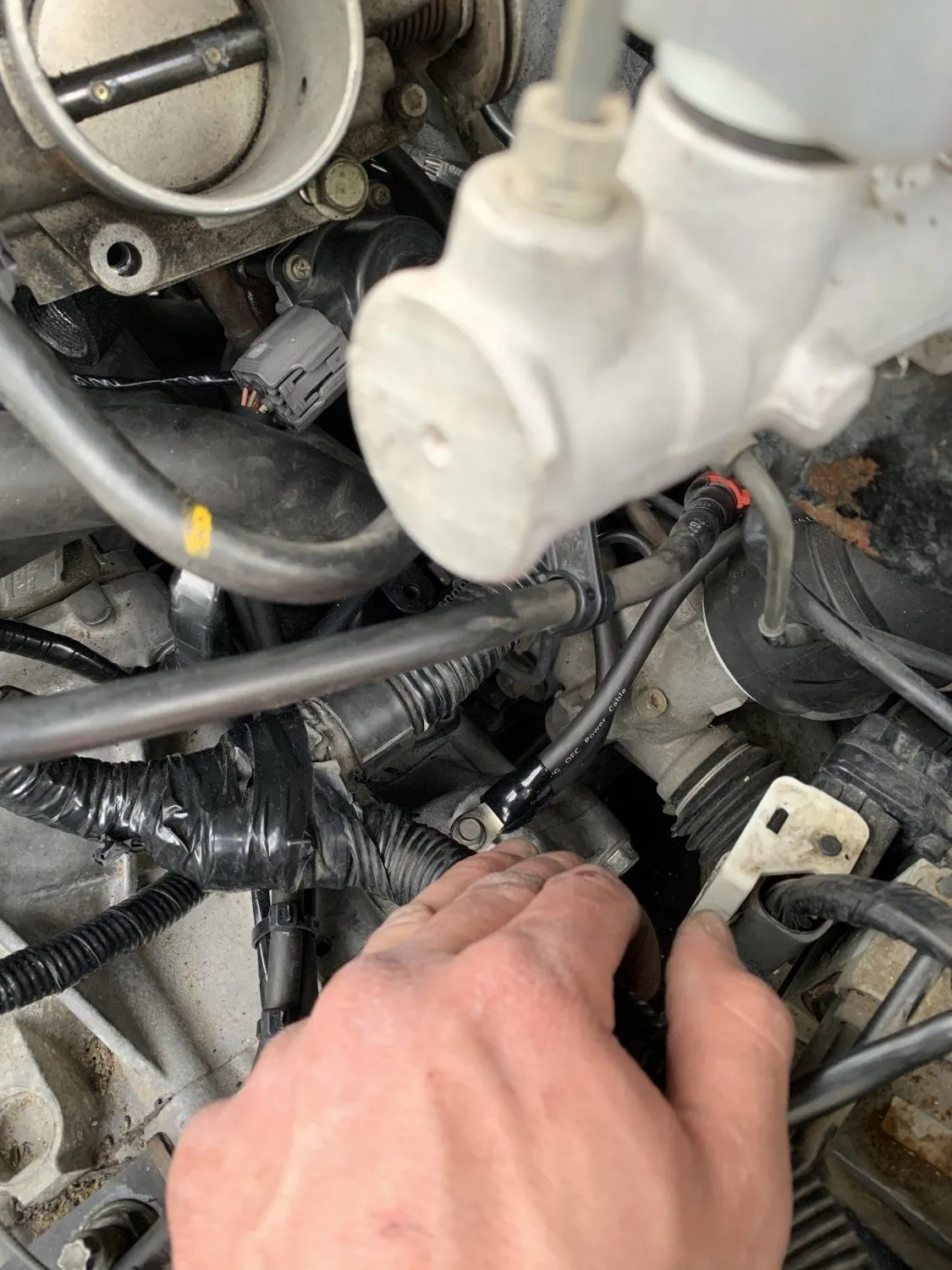

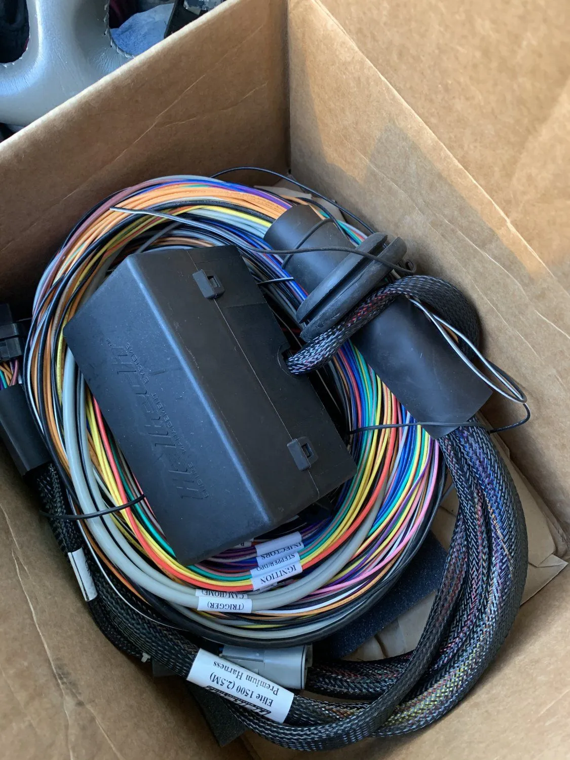

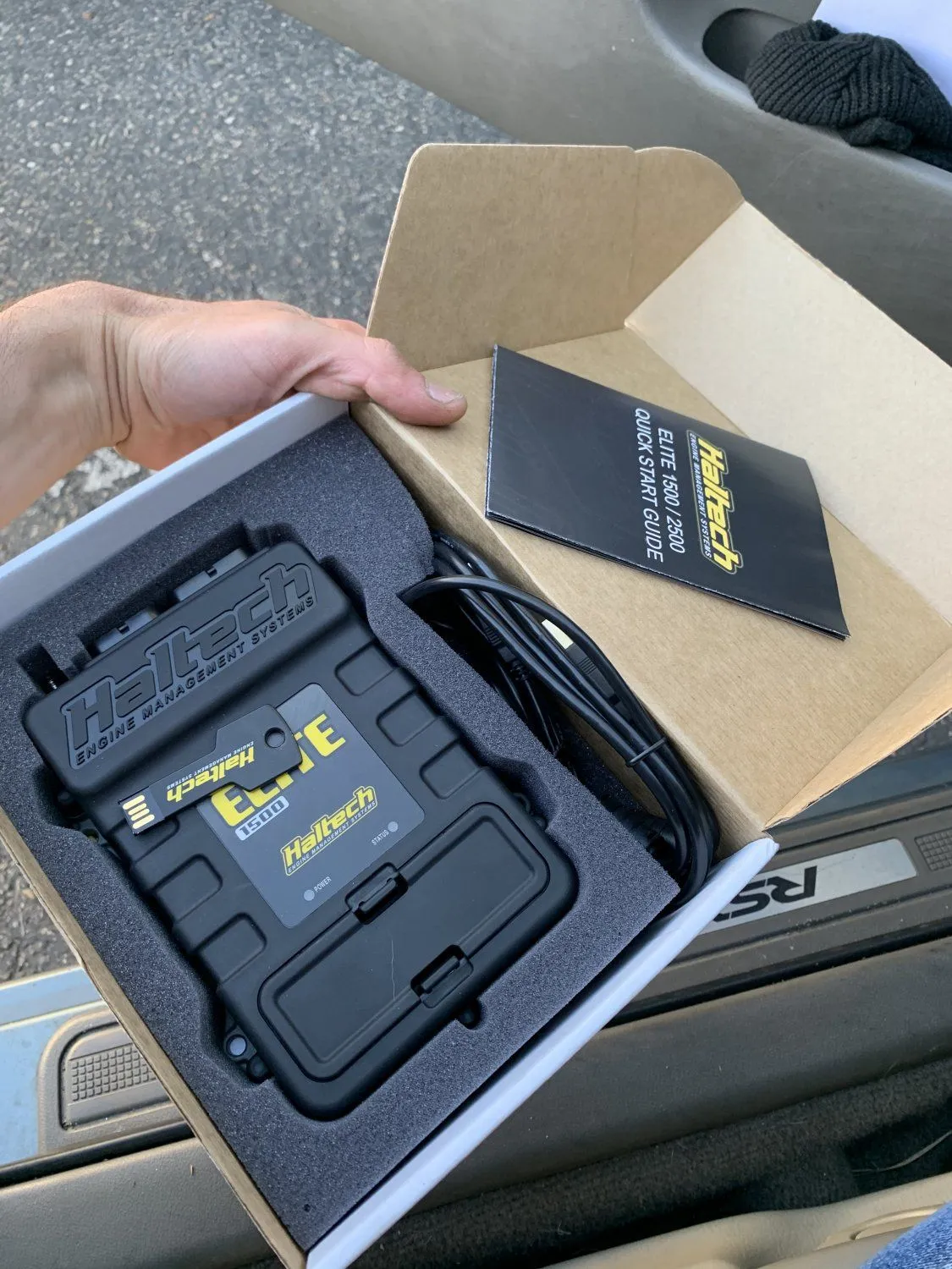

Haltech elite 1500 with a universal harness. I’m still debating if I will go full standalone or I may purchase the harnessed performance plug and play harness. The plug and play kit runs the elite and factory ecu parallel.
