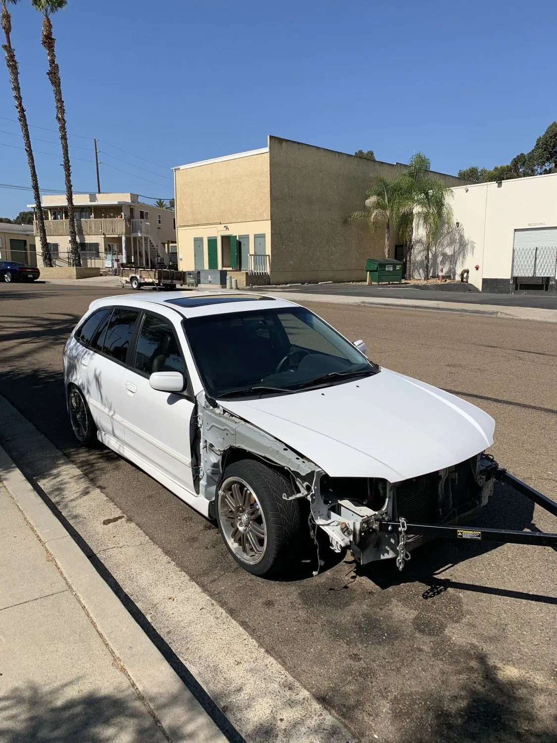

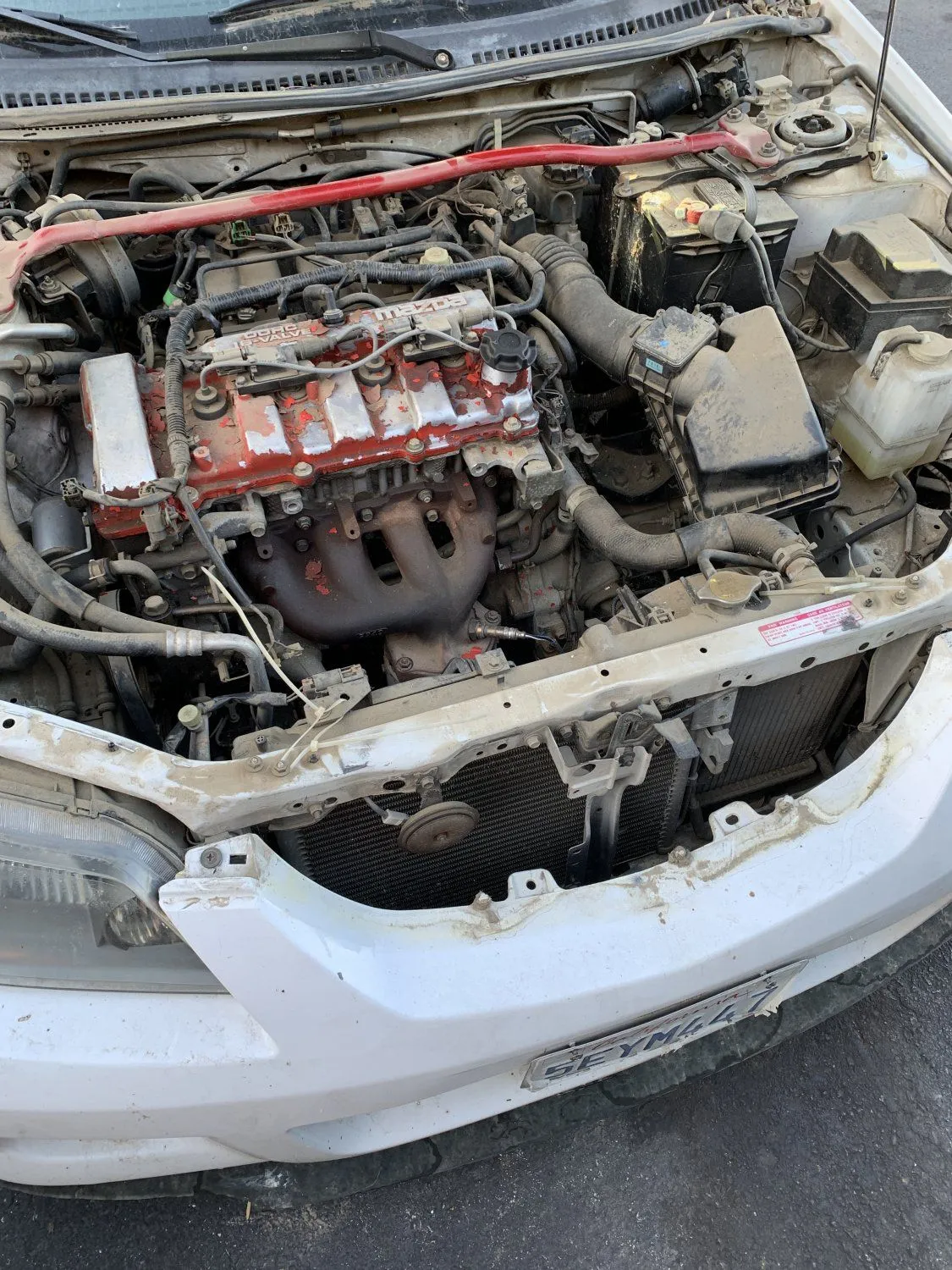

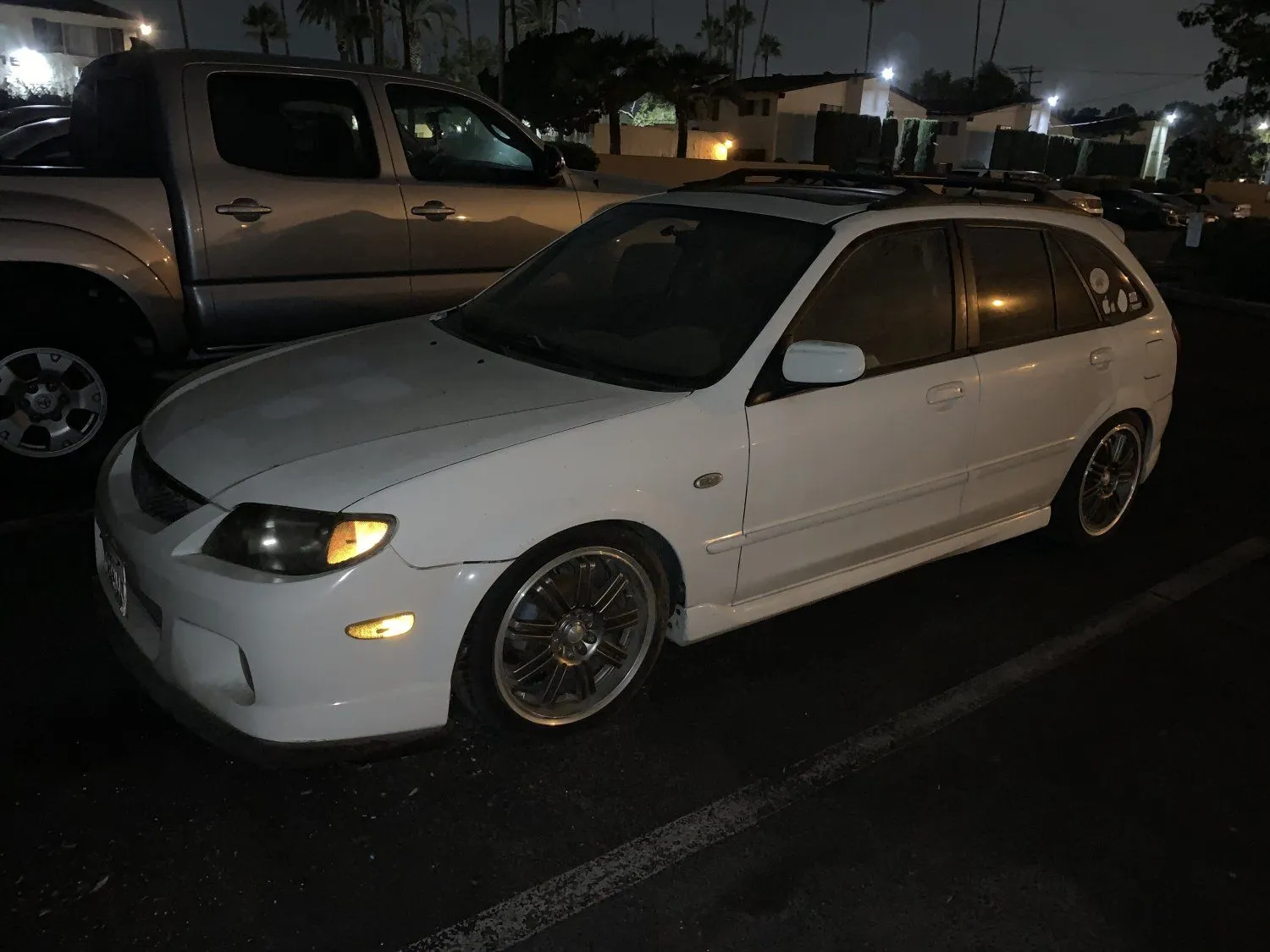

Making a build thread to help me keep track on my mods. Bought the car in beginning of 2019. Mainly was looking for a shell and this one was pretty clean. Before I bought the shell I was already collecting parts and working on some.
:cool: If something listed has this emoji. It’s something I modified or built

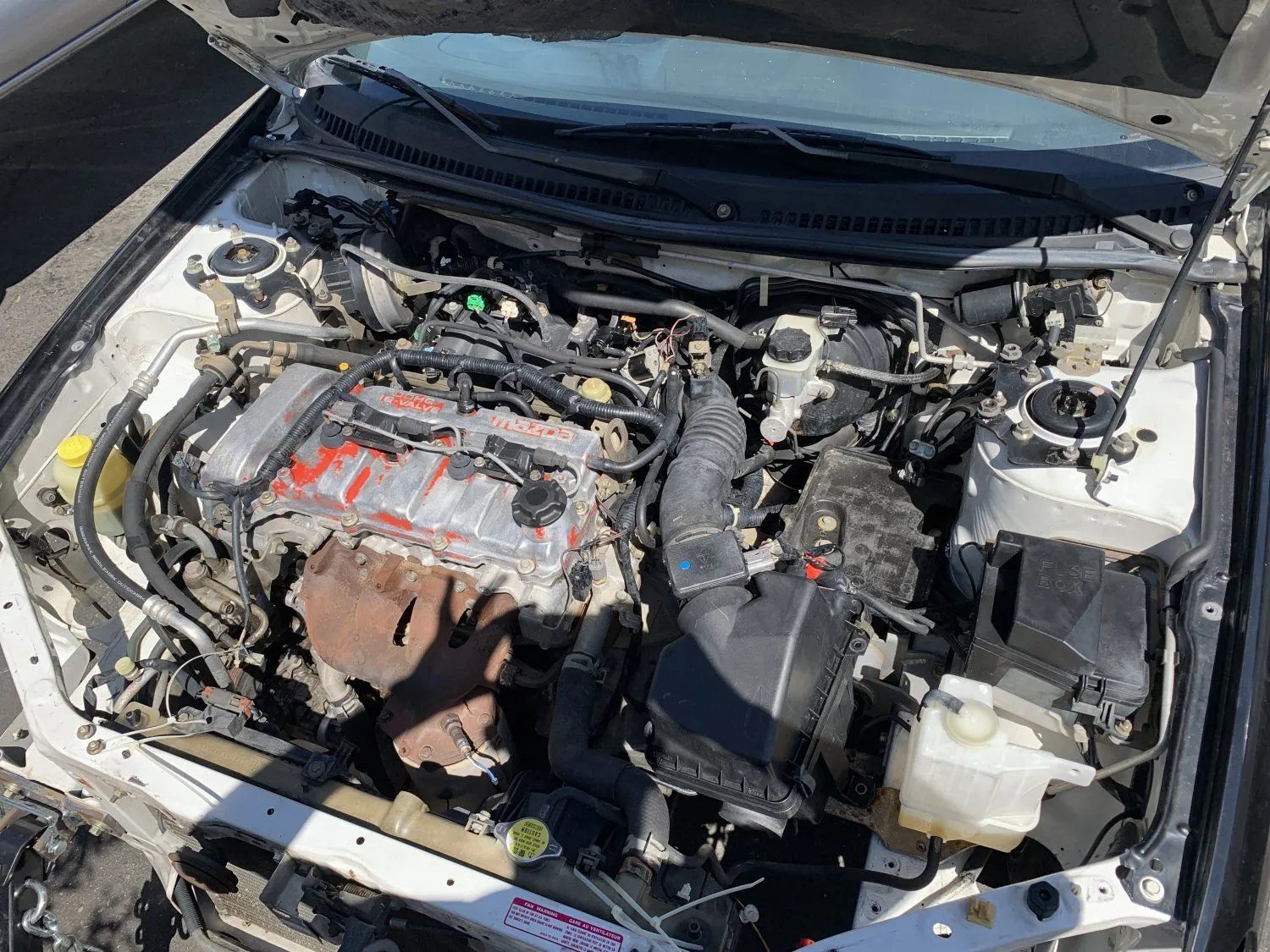

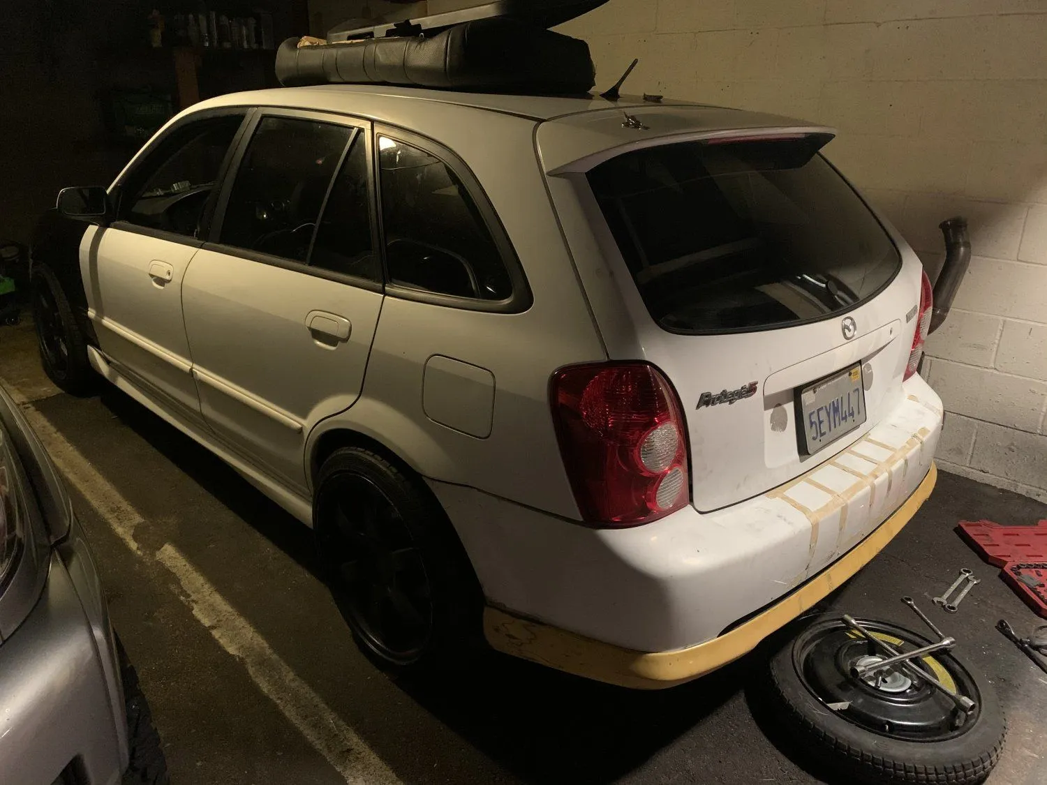

2003 Protege5. Brought it home, got it started and moving. Next day, straight to the car wash. The modding began...
Started with dissembling the car. Removed anything I didn’t plan to use or had plan to replace

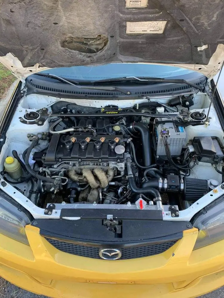

  • Stock FSDE

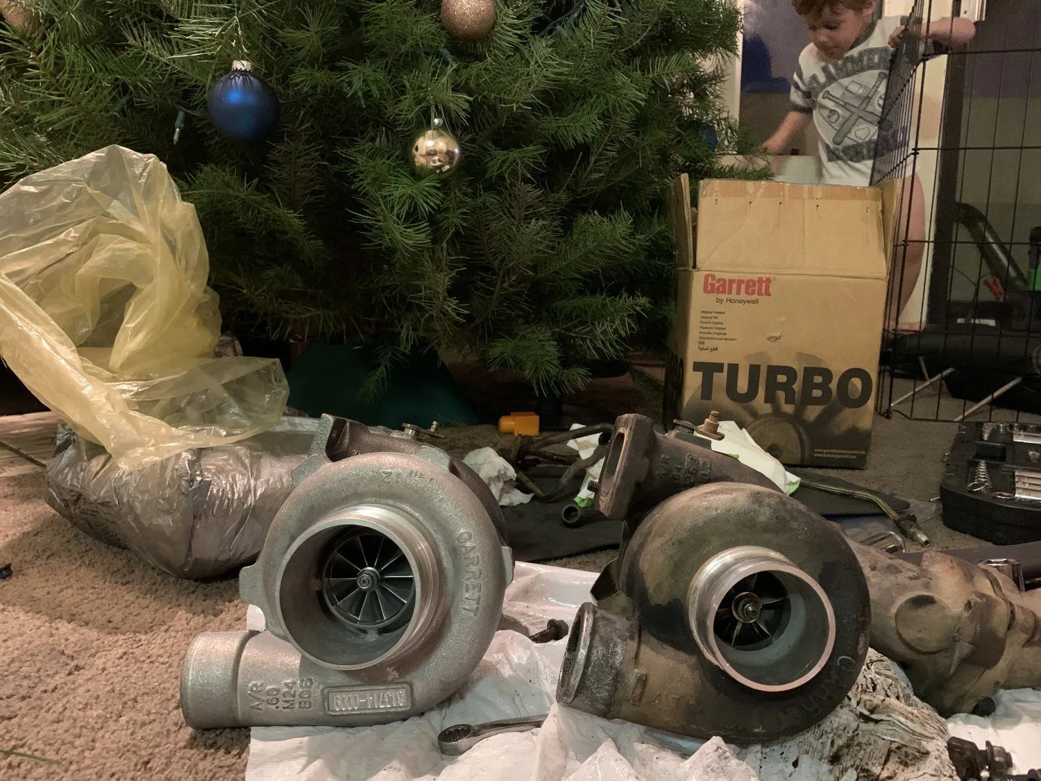

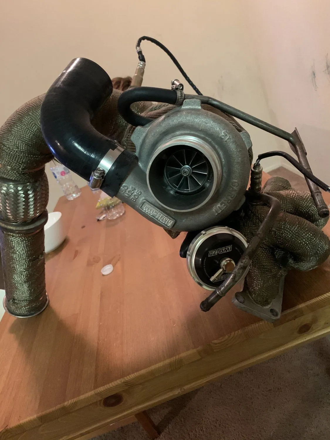

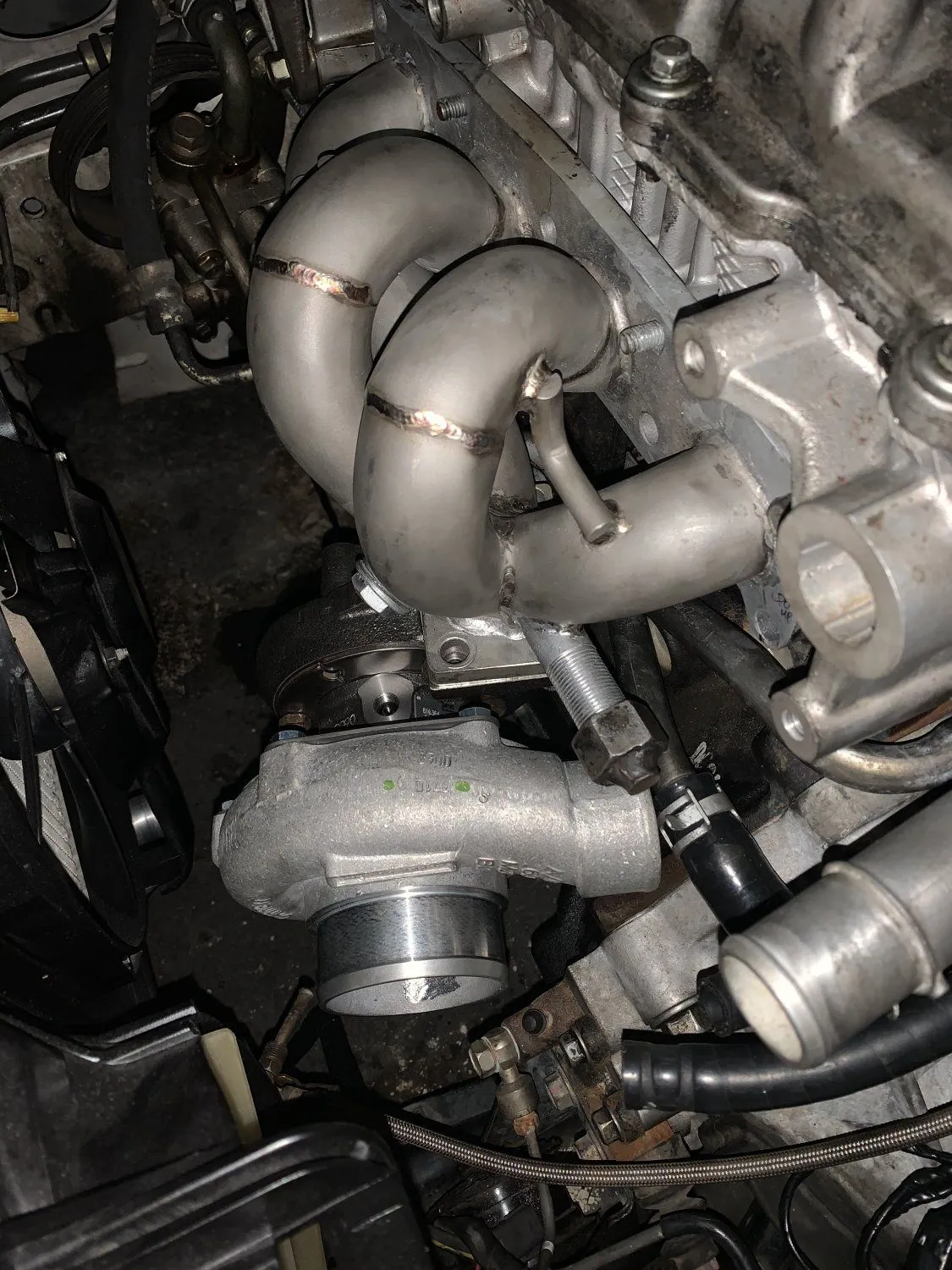

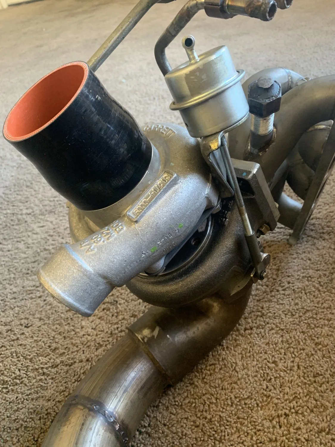

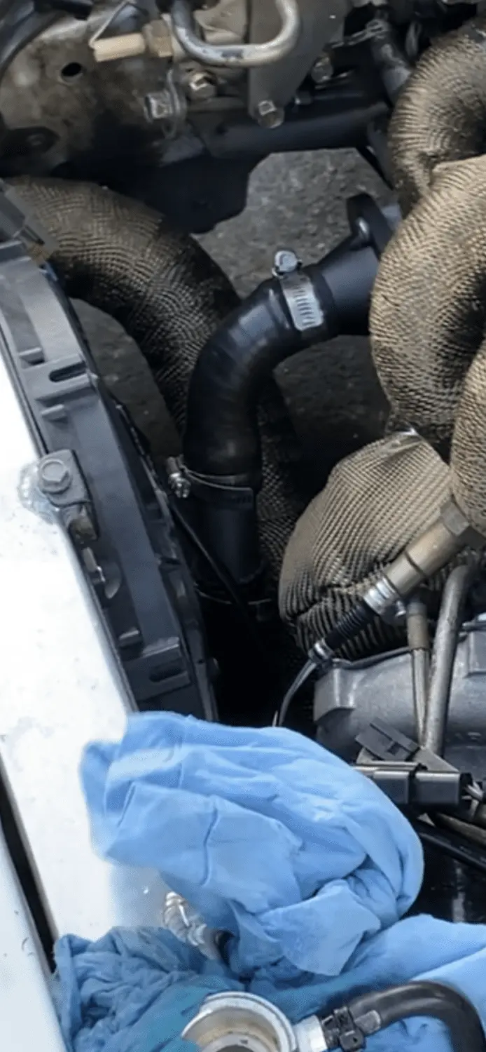

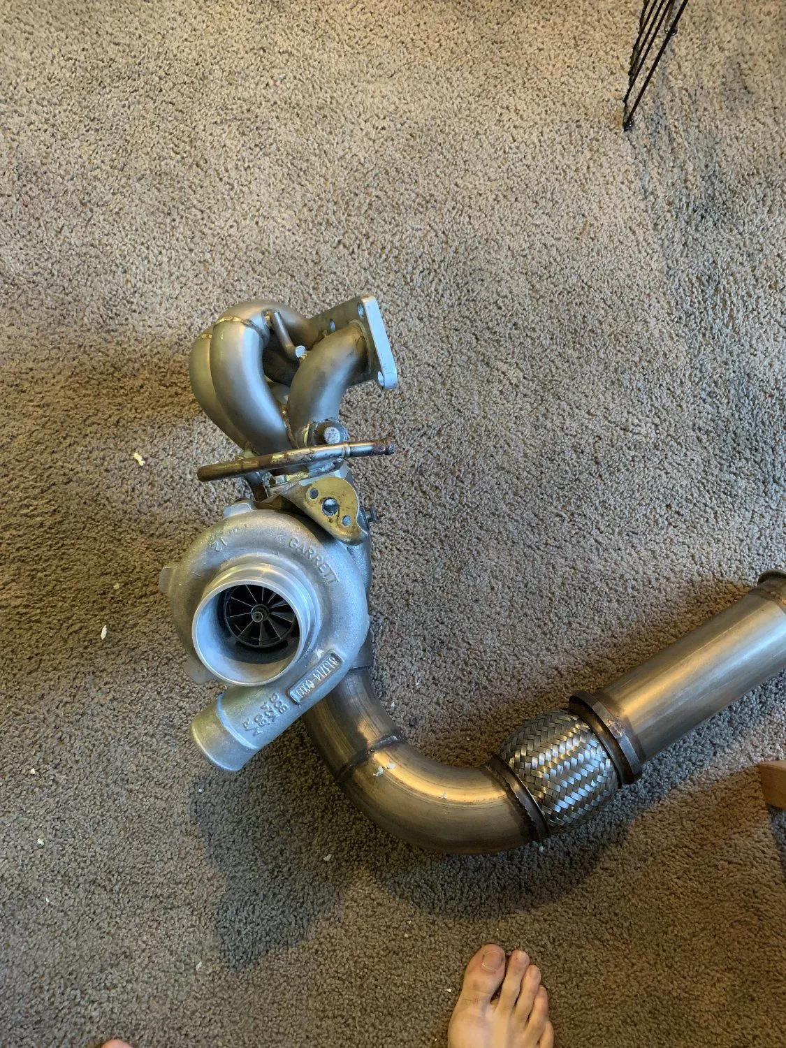

:cool:Garrett GTX2867r, T2 exhaust housing ga, comp housing rotated down​

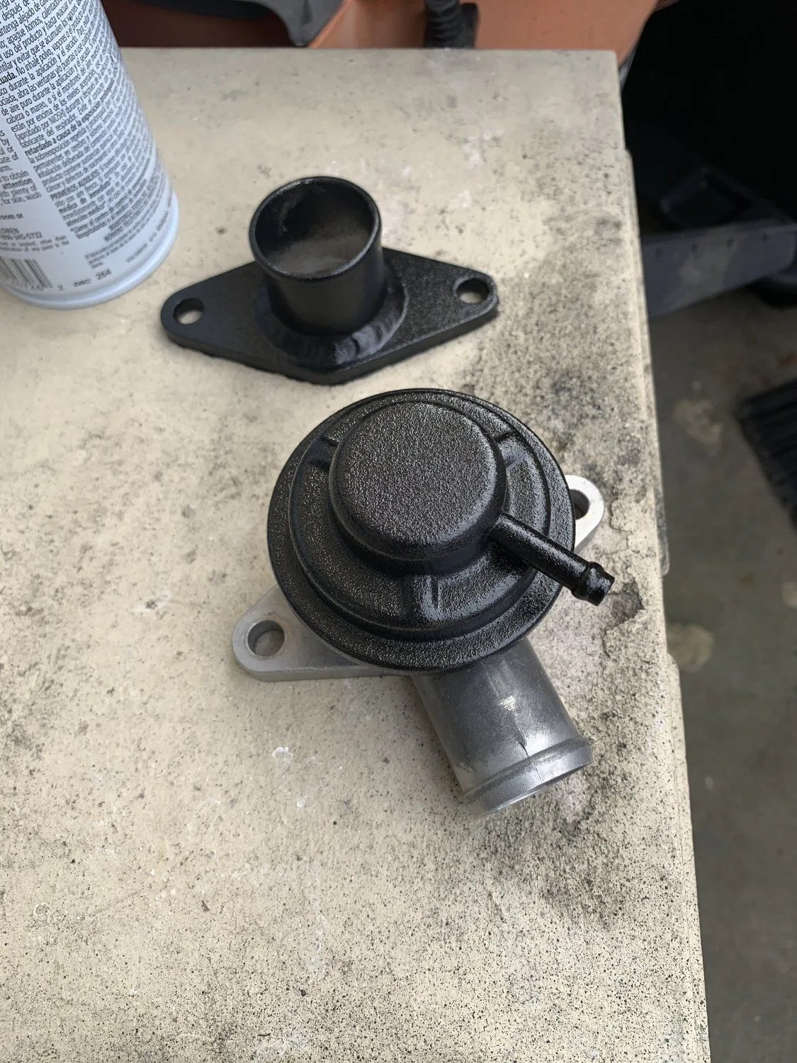

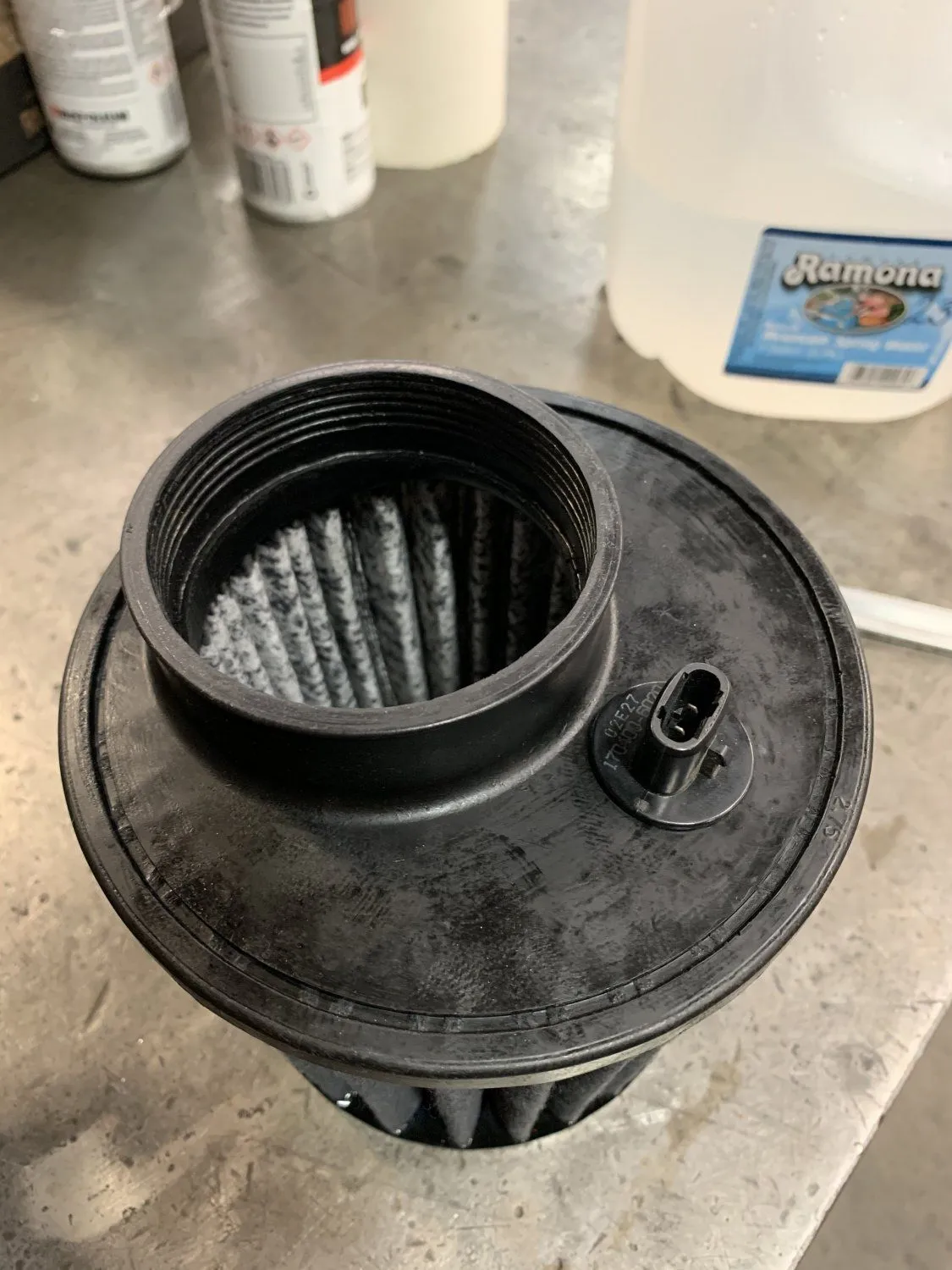

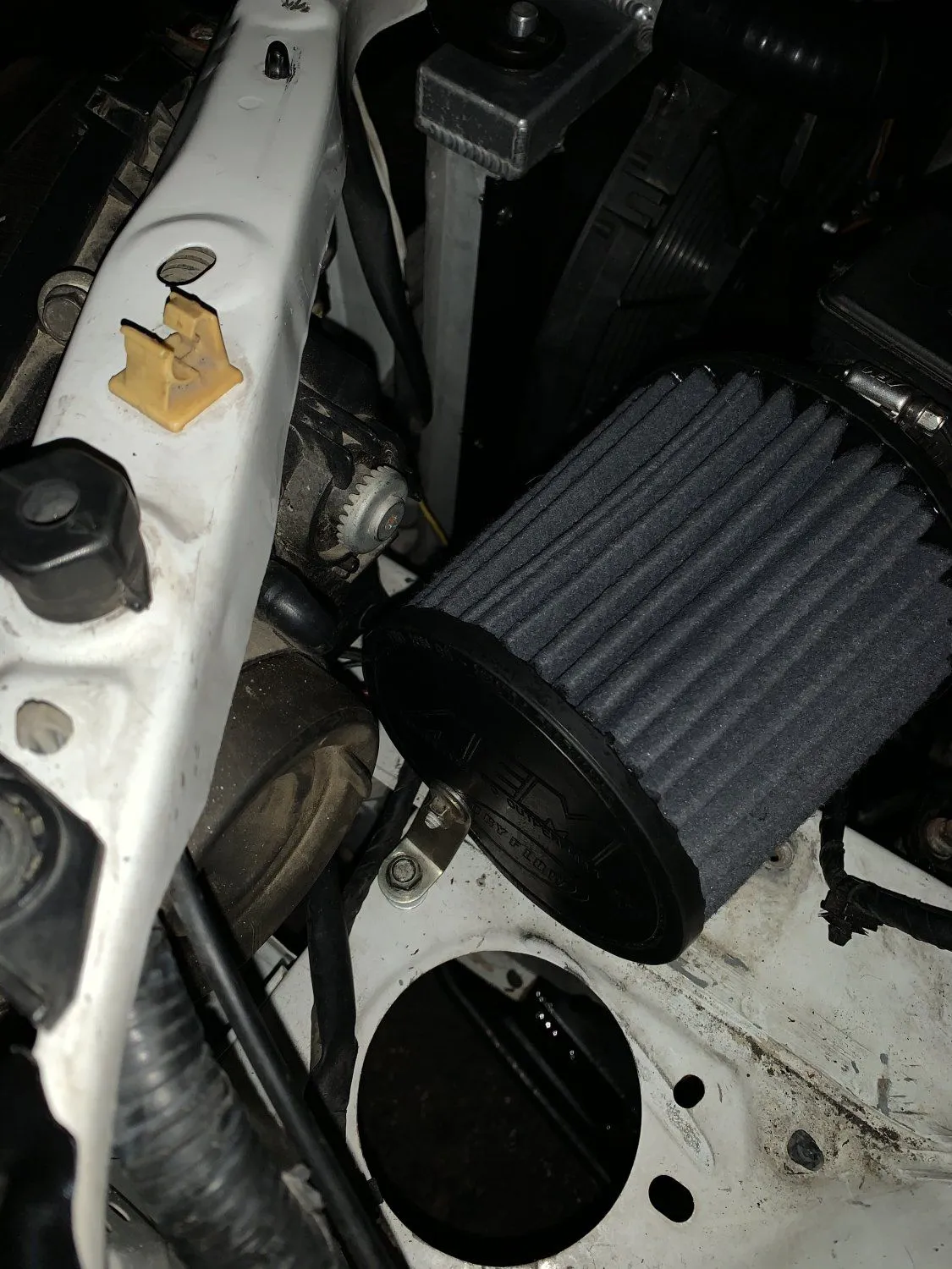

:cool:Aem intake, 2.75 to 3 coupler, bypass valve inlet modified to 1.25” w/Aem dry flow offset filter, hole added for intake temp sensor​

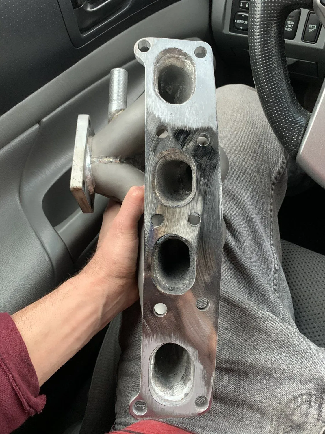

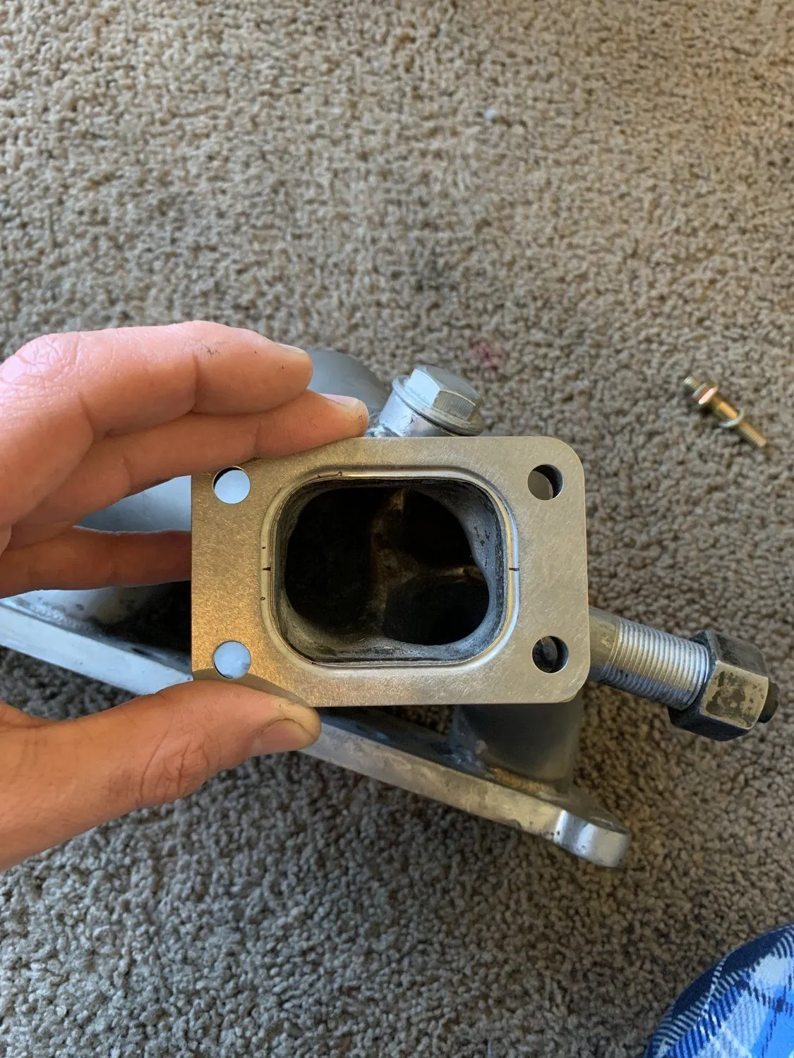

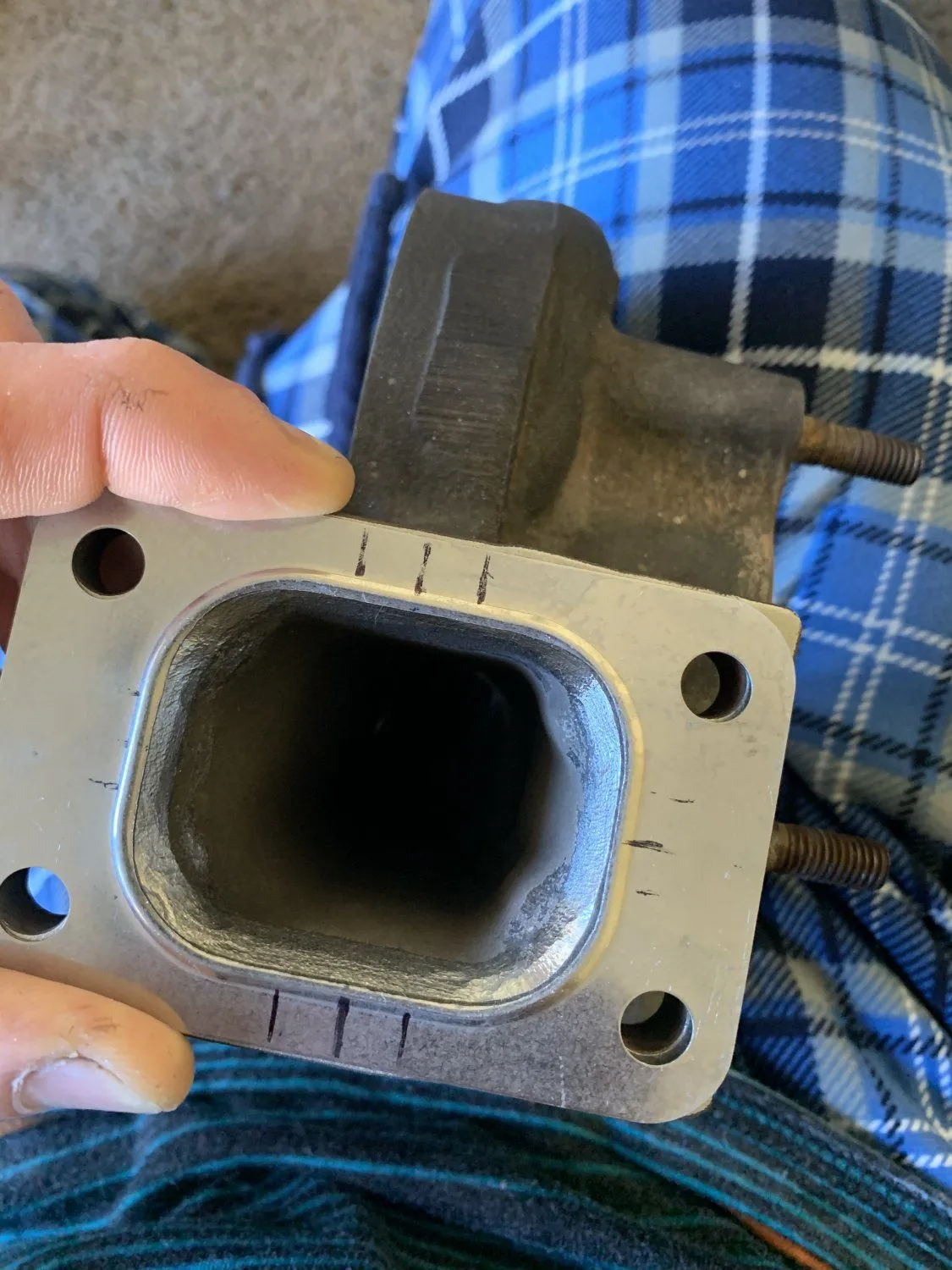

:cool:Thunders style turbo manifold port and gasket matched​

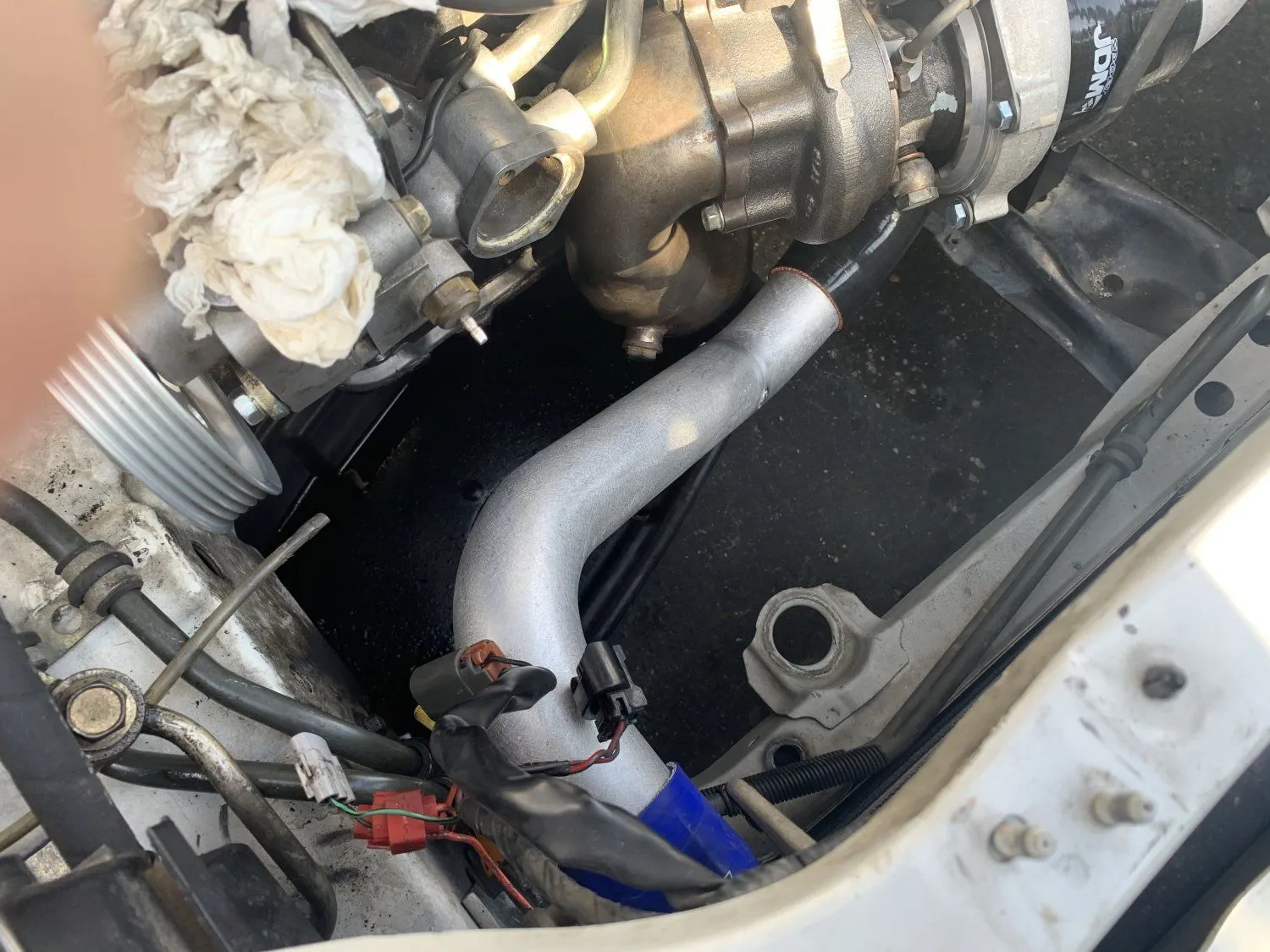

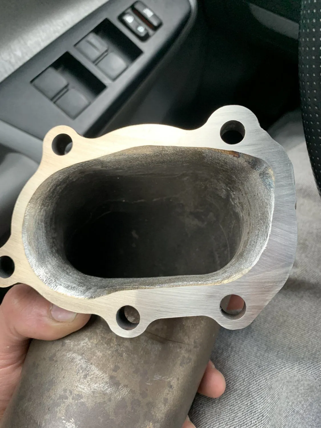

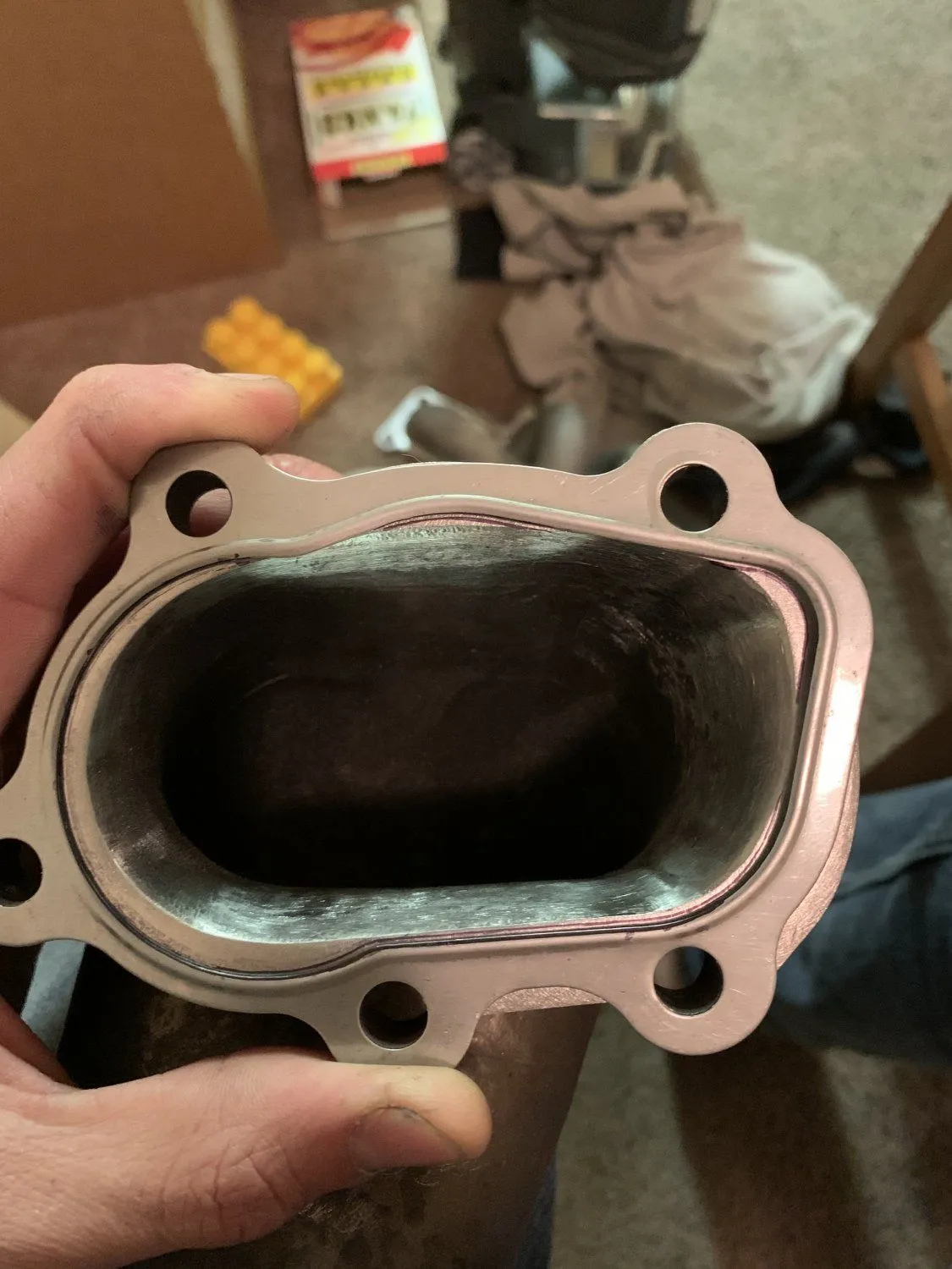

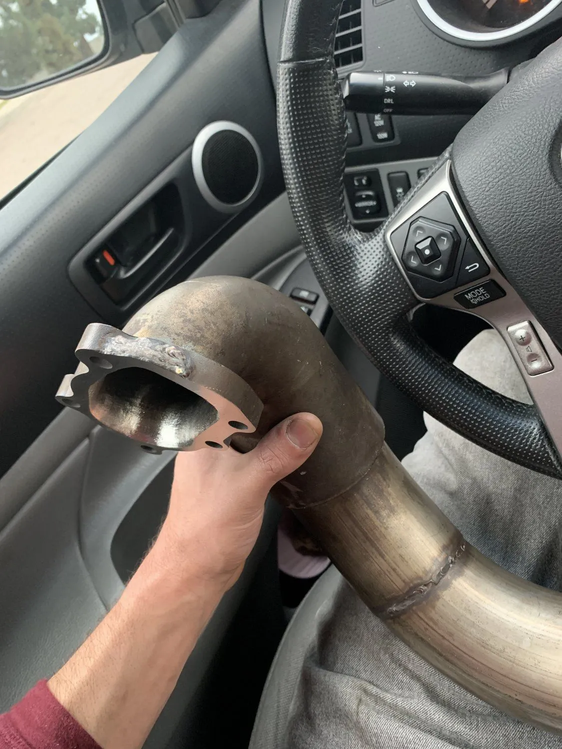

:cool:Pope fully ported downpipe w/ flexband, wideband o2 bung​

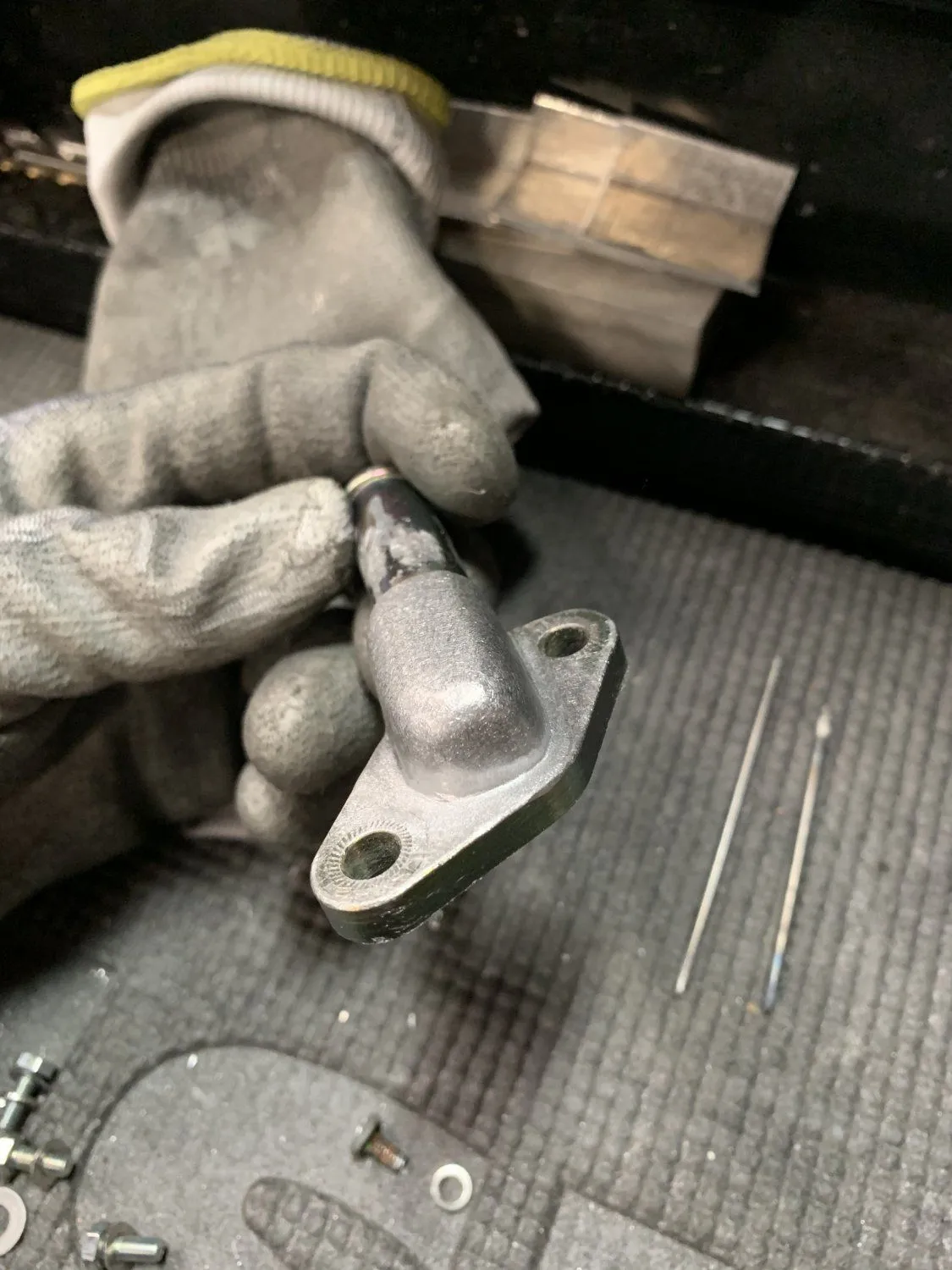

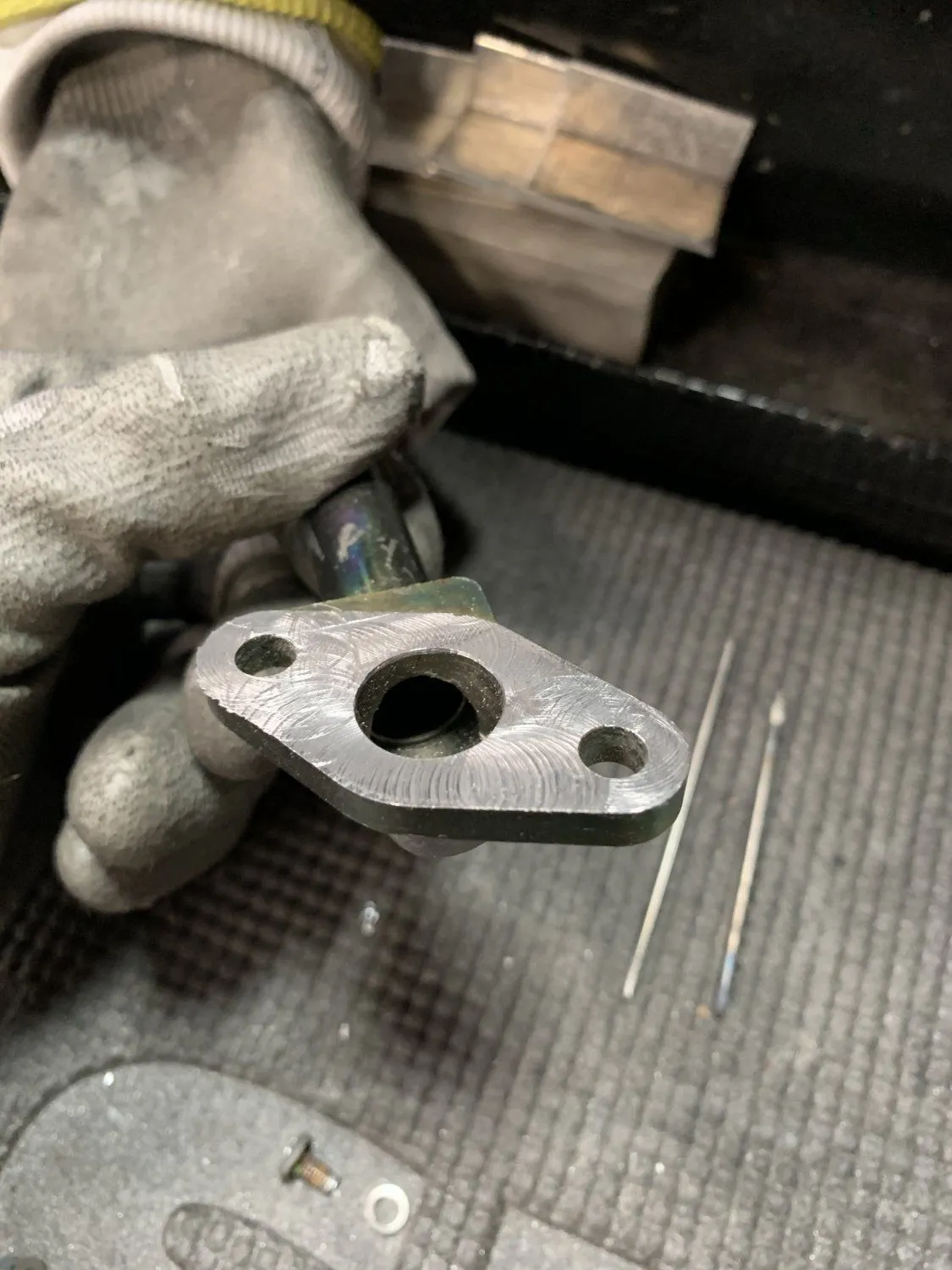

:cool:Factory oil dump modified to clear downpipe​
  • Agana Metal Fab - downpipe back 3” piping, v-band clamps w/ Greddy sp2

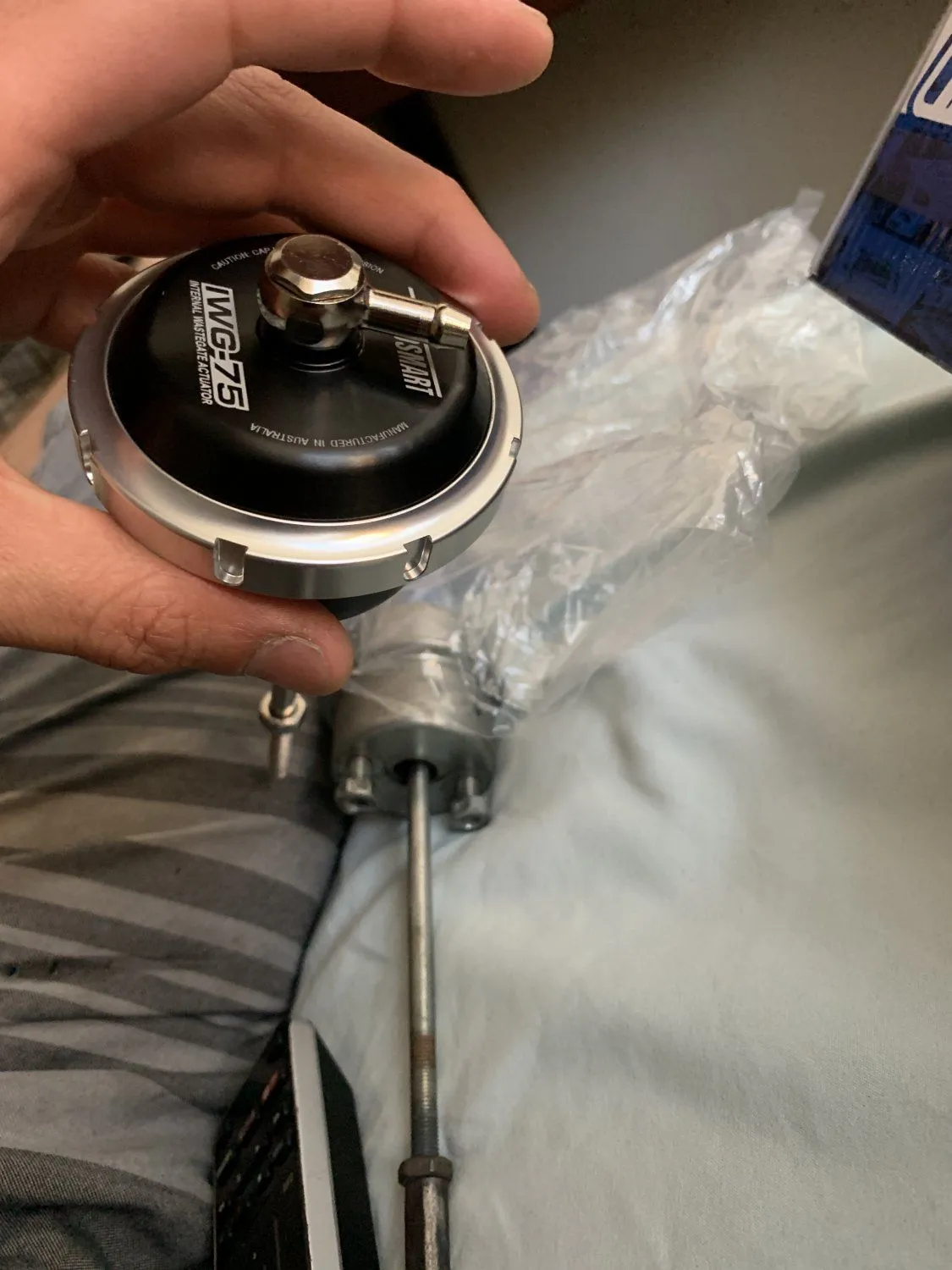

  • Turbosmart 7 psi wastegate
  • Greddy type a bov

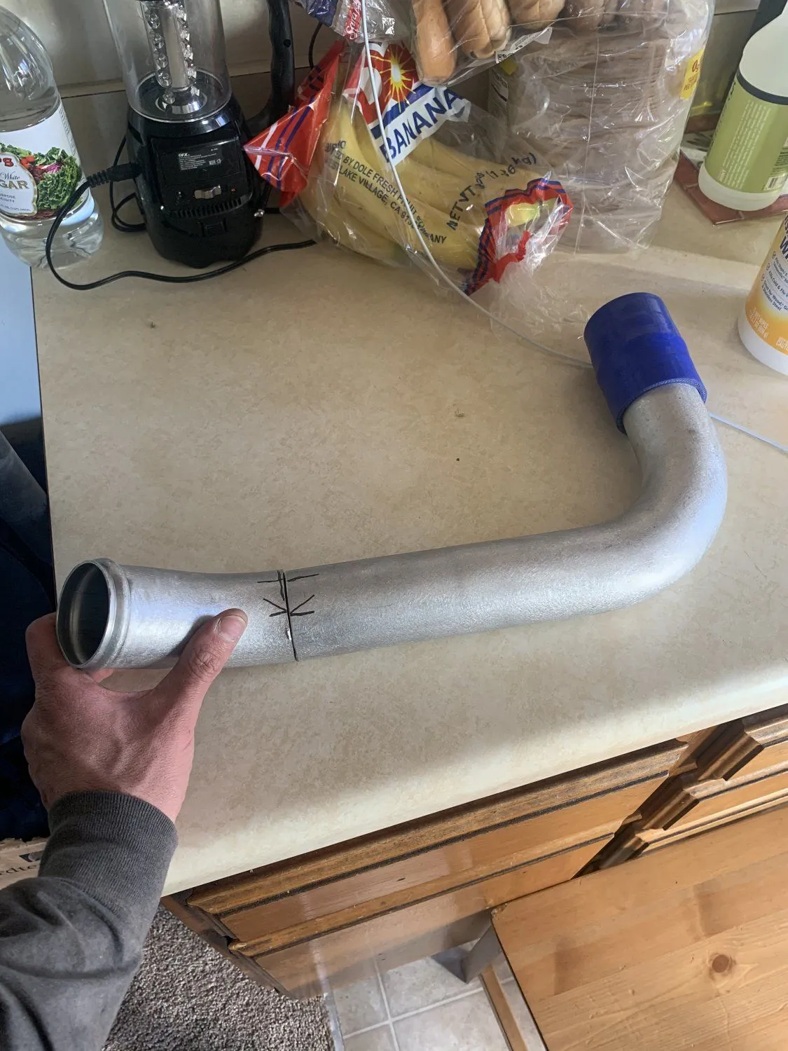

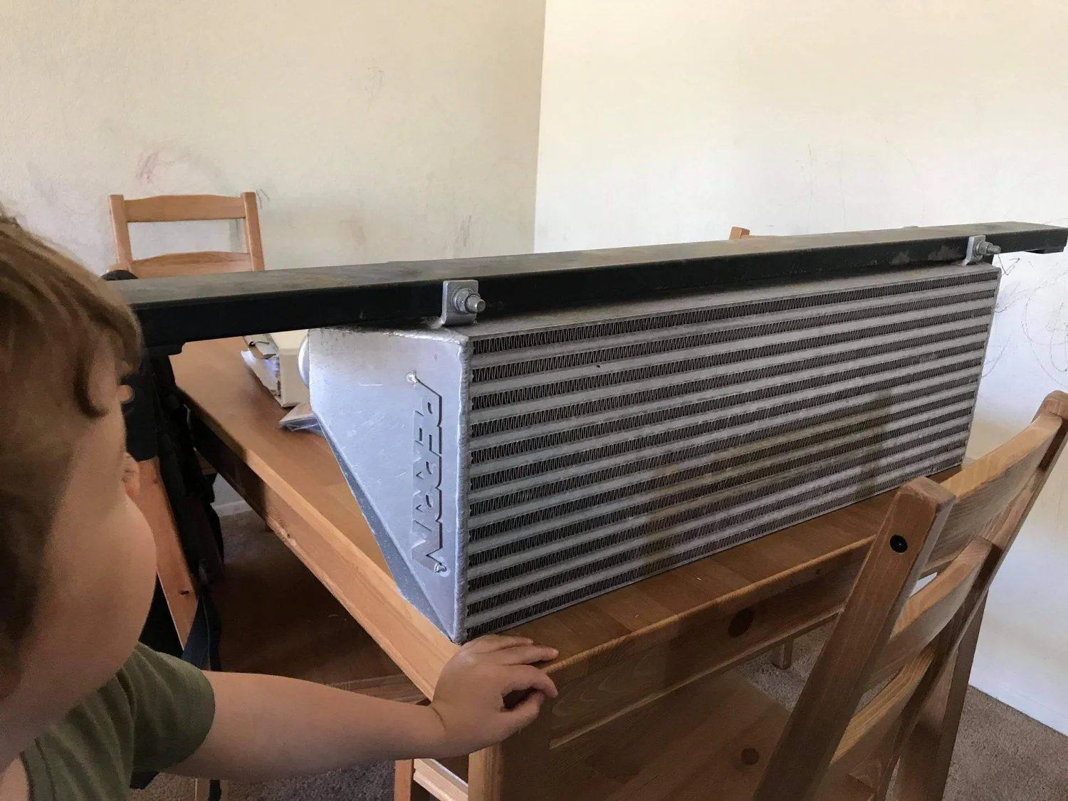

:cool:Perrin fmic hot pipe modified for rotated turbo, recirculating tube for bov​

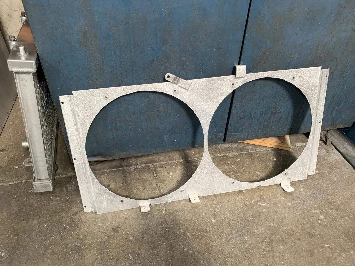

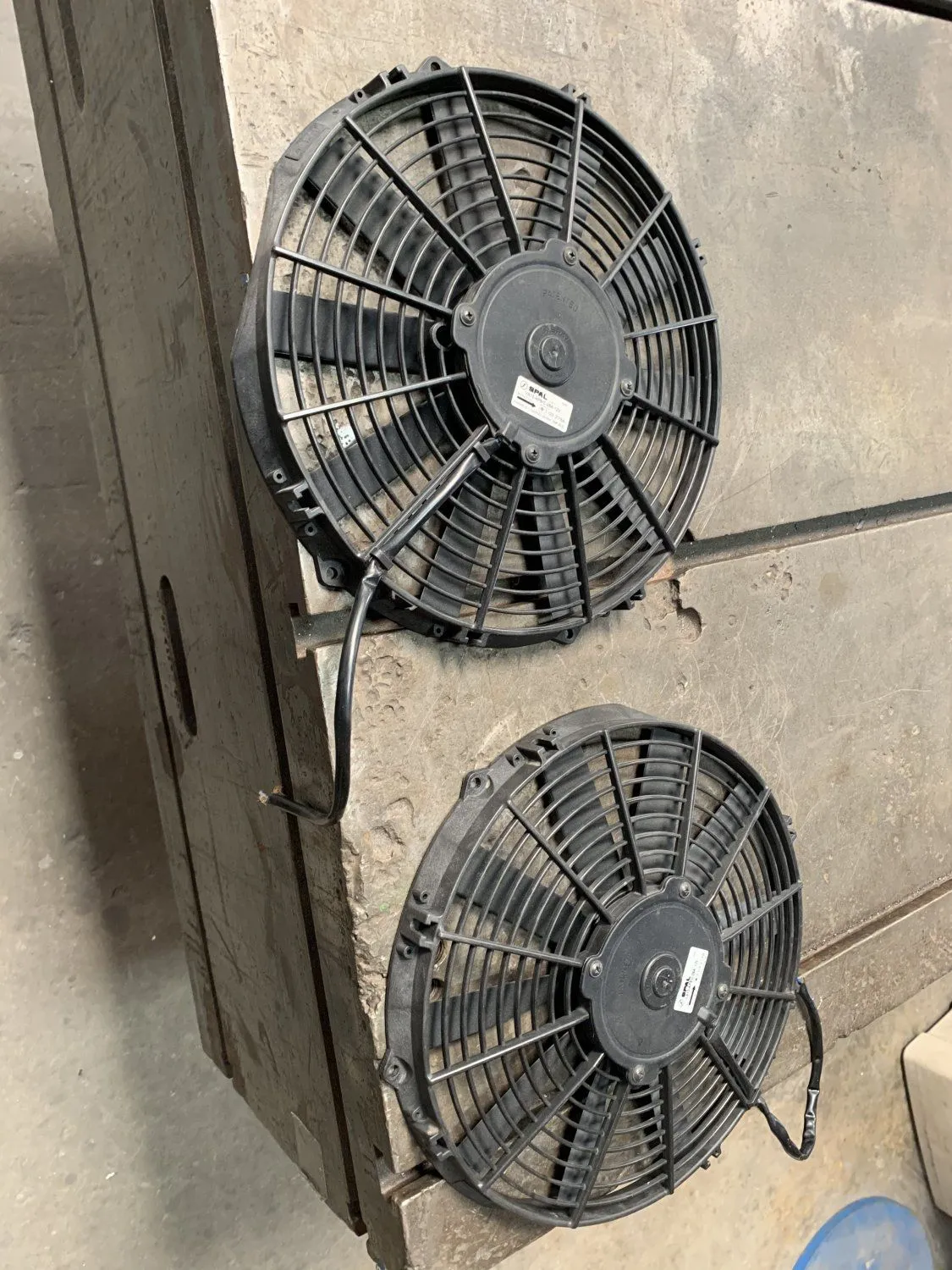

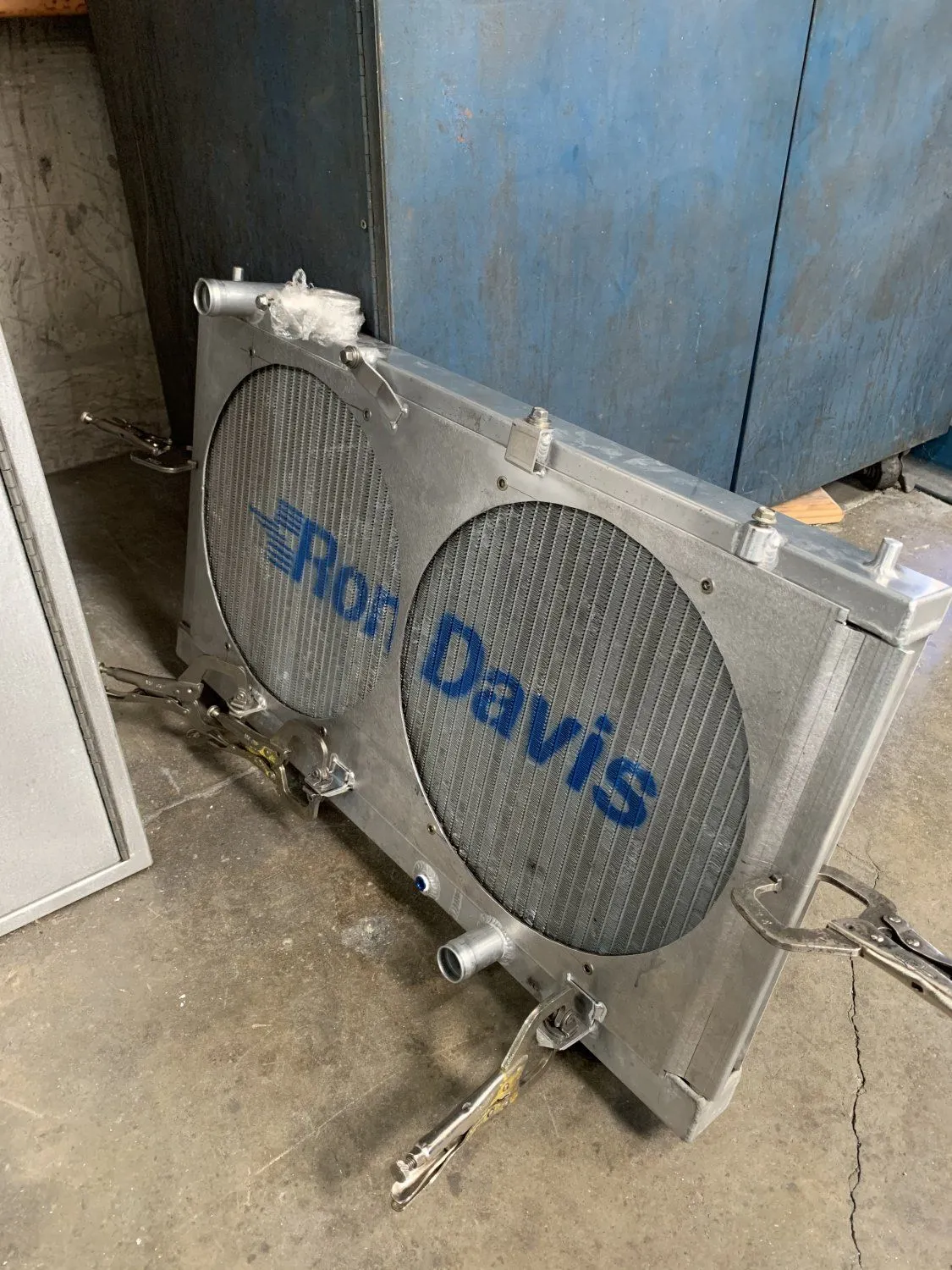

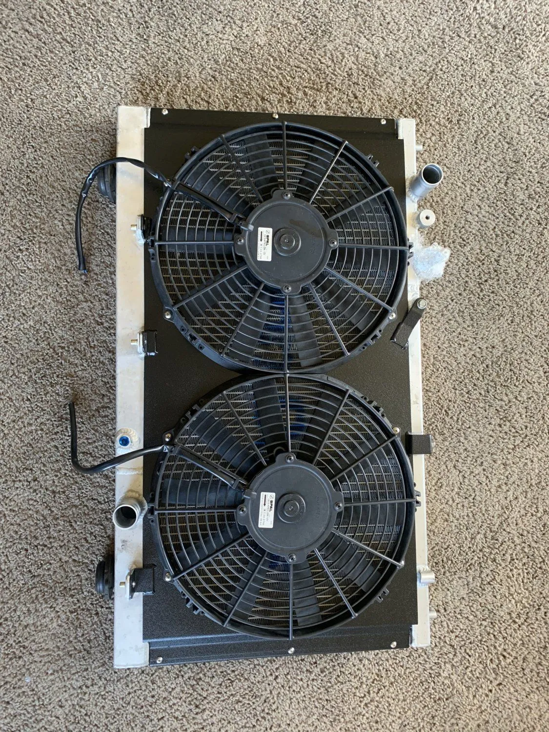

:cool:Ron Davis full size rad, spal fans, custom fan shroud​
😎Aluminum coolant overflow​

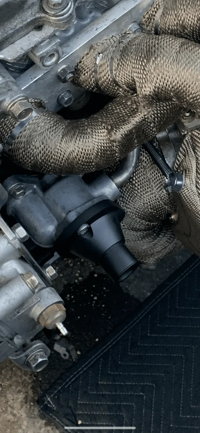

:cool:Lower rad hose, Hydra straight neck w/
Jdm low temp thermostat

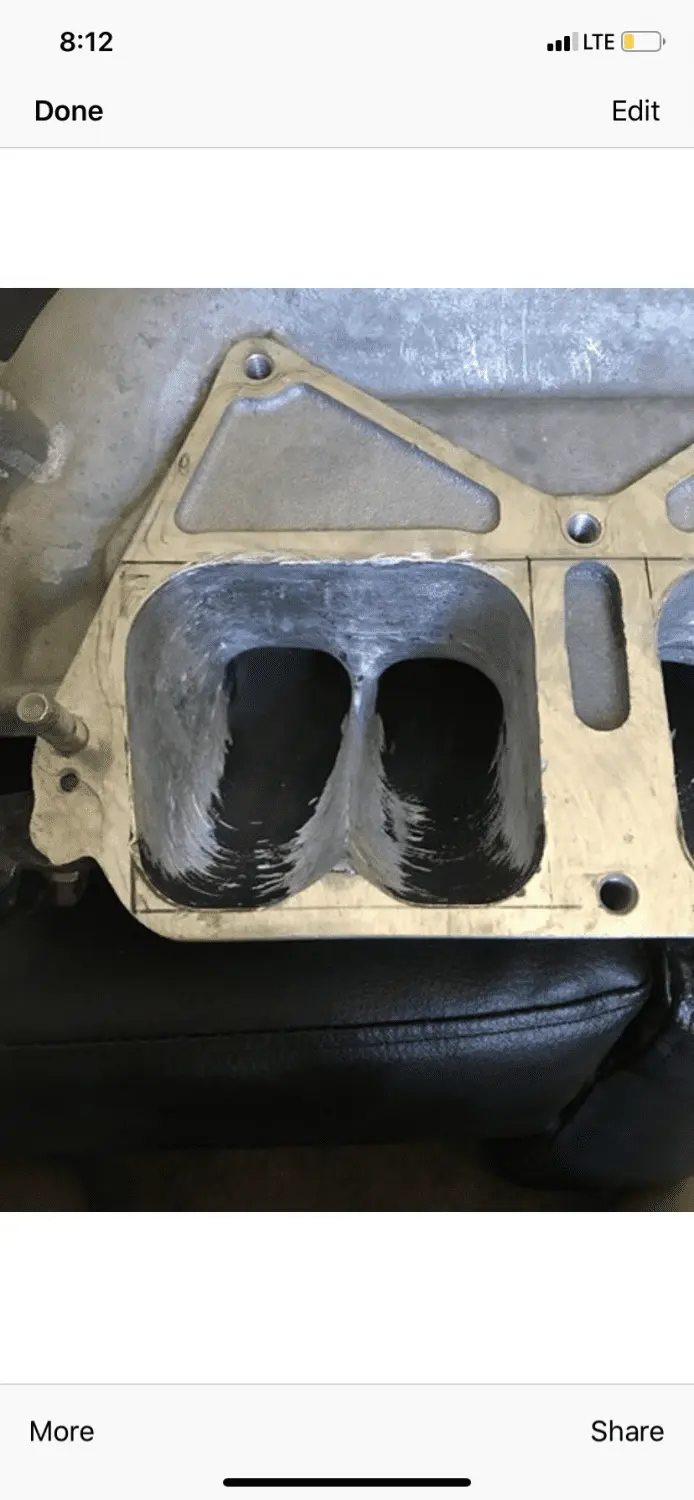

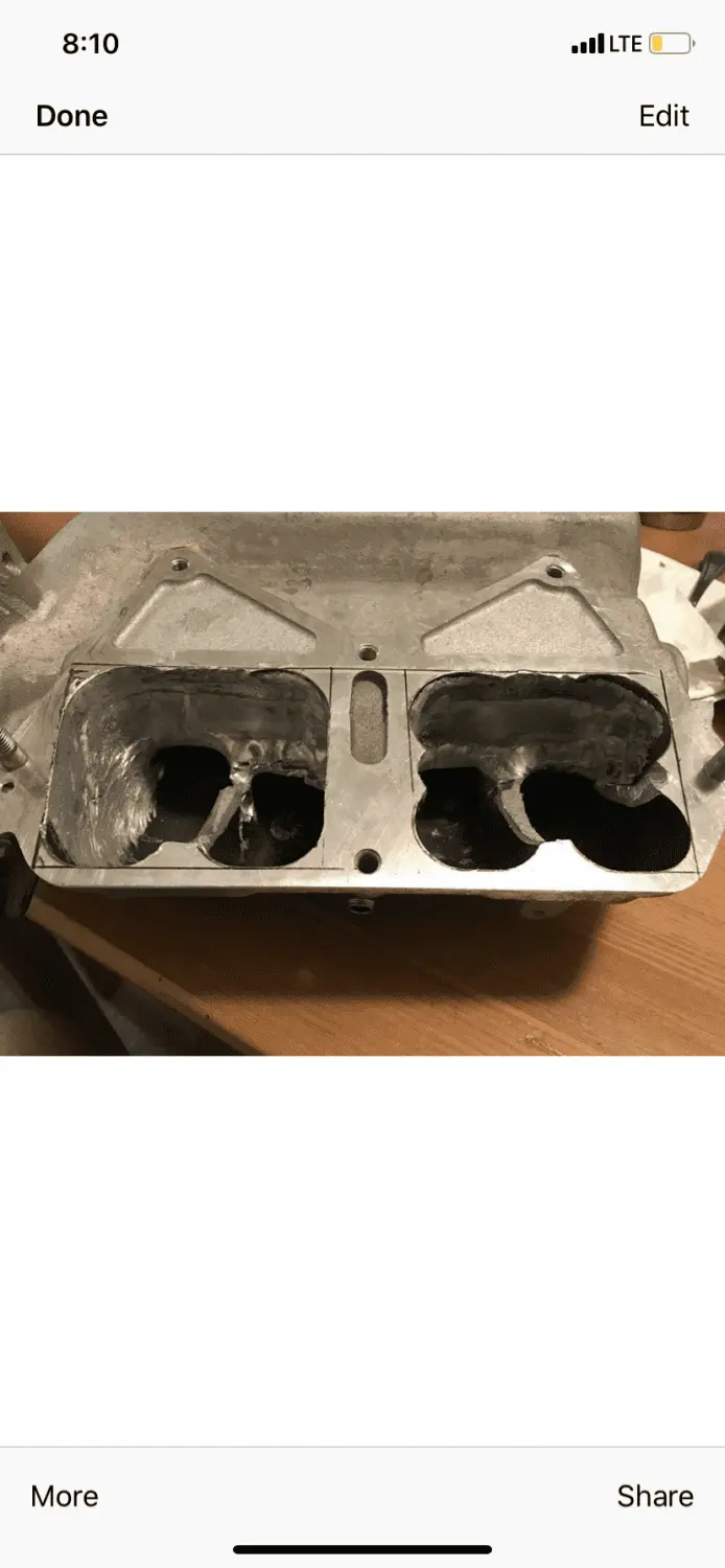

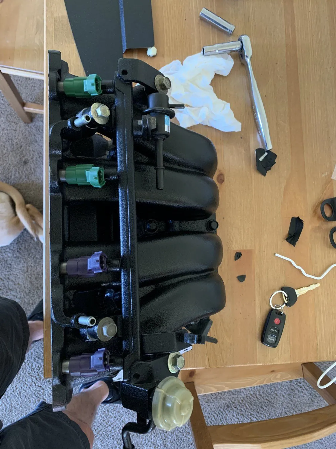

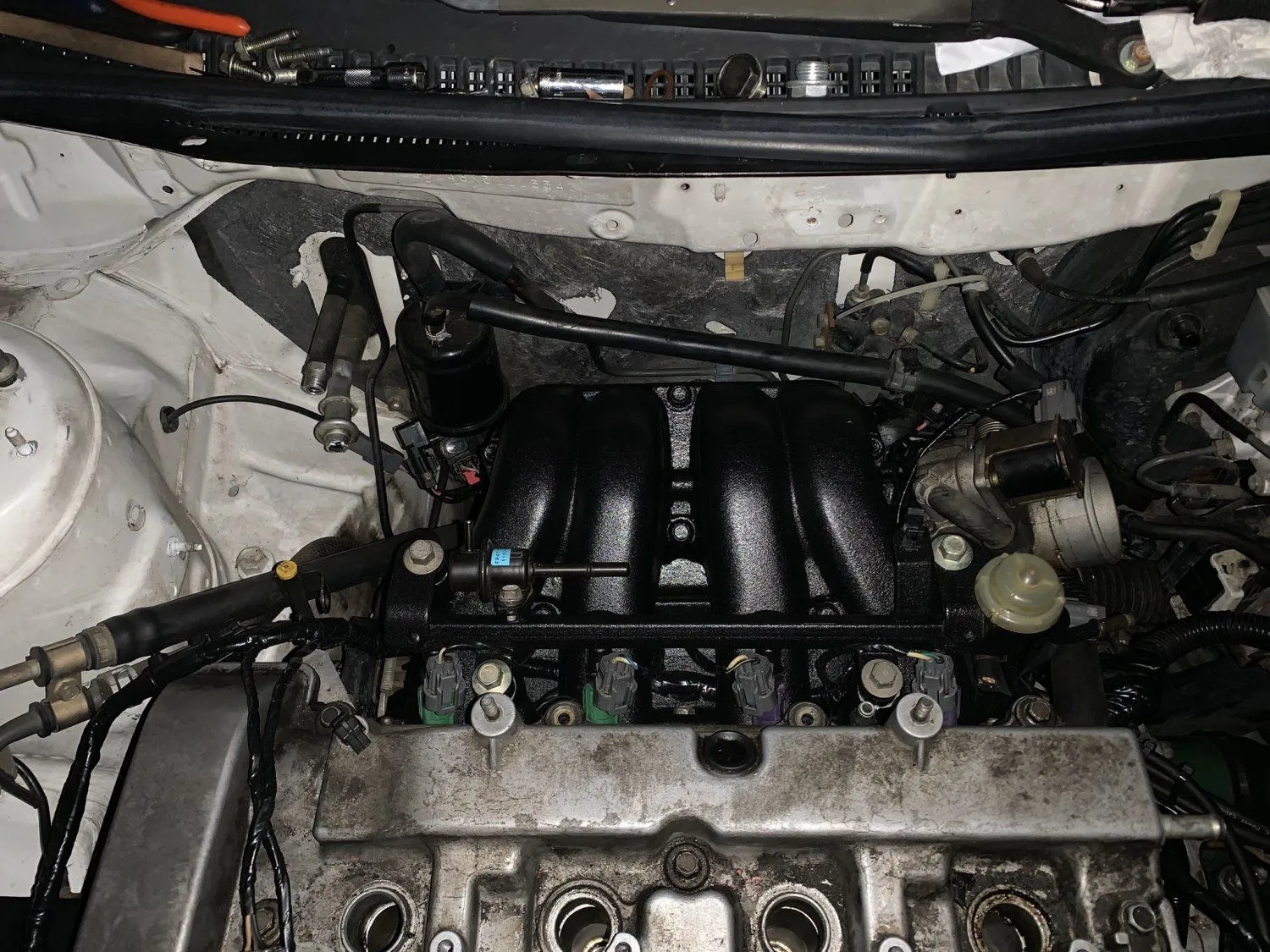

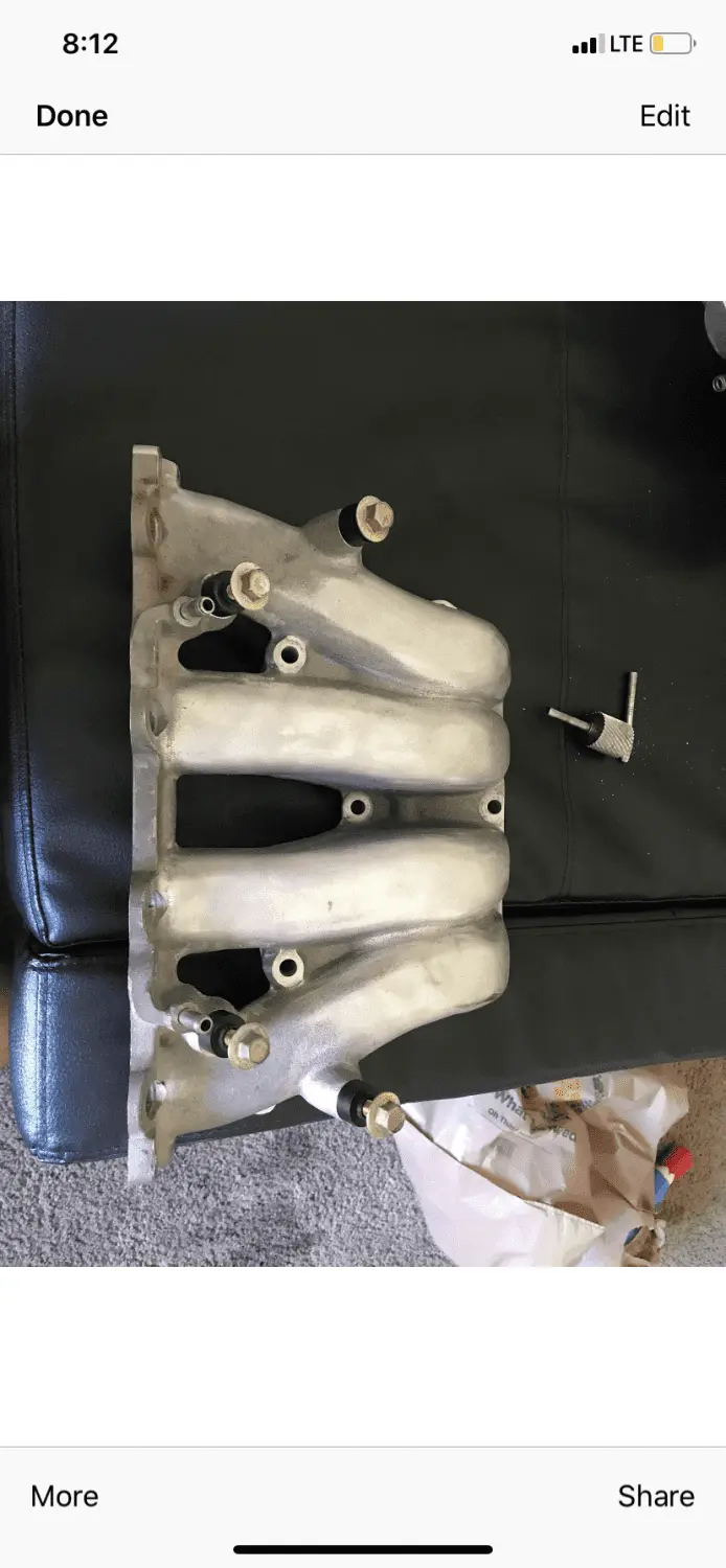

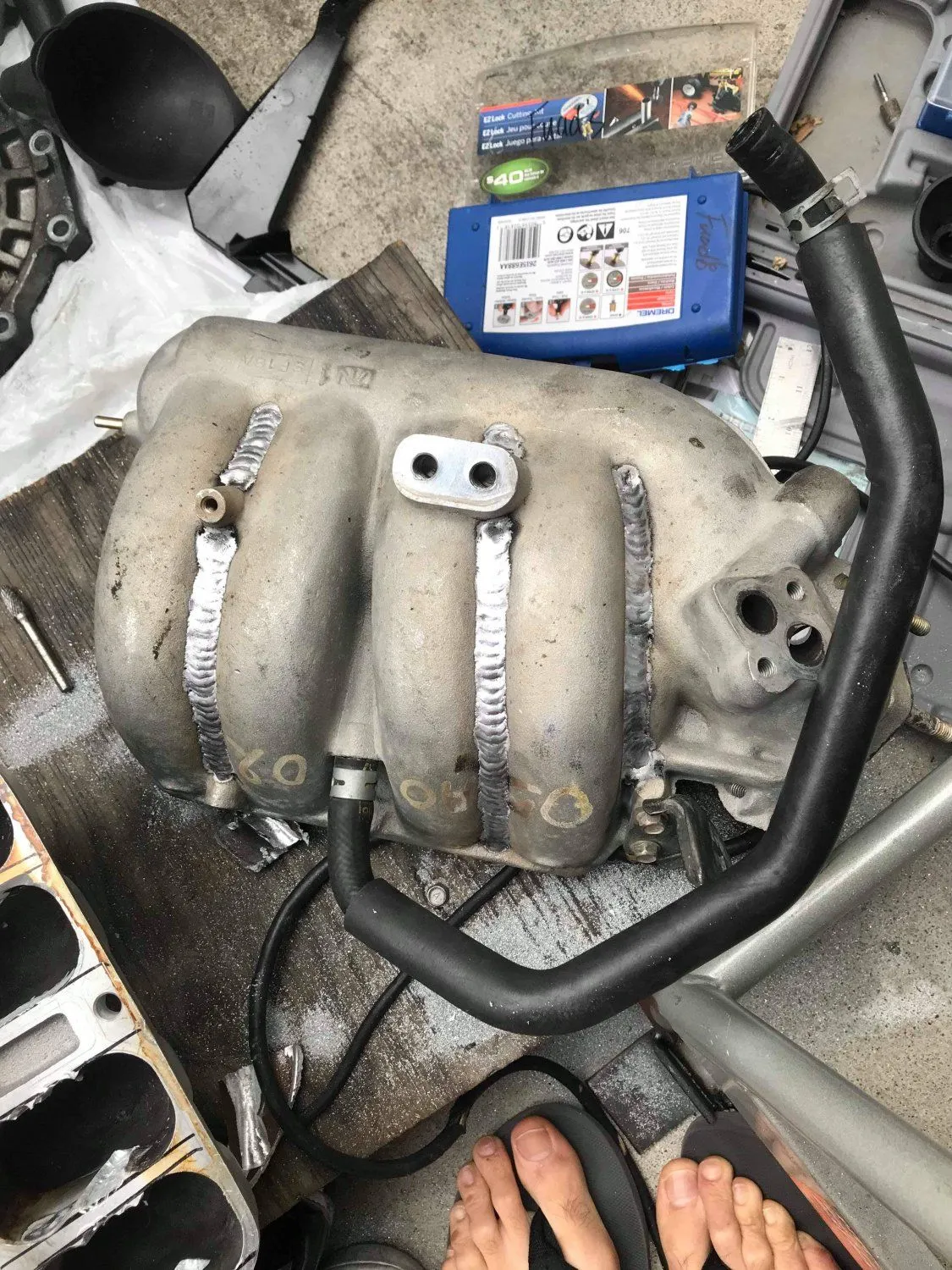

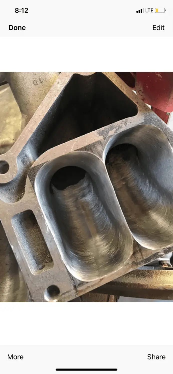

:cool:Oem intake manifold fully ported, shaved and welded​

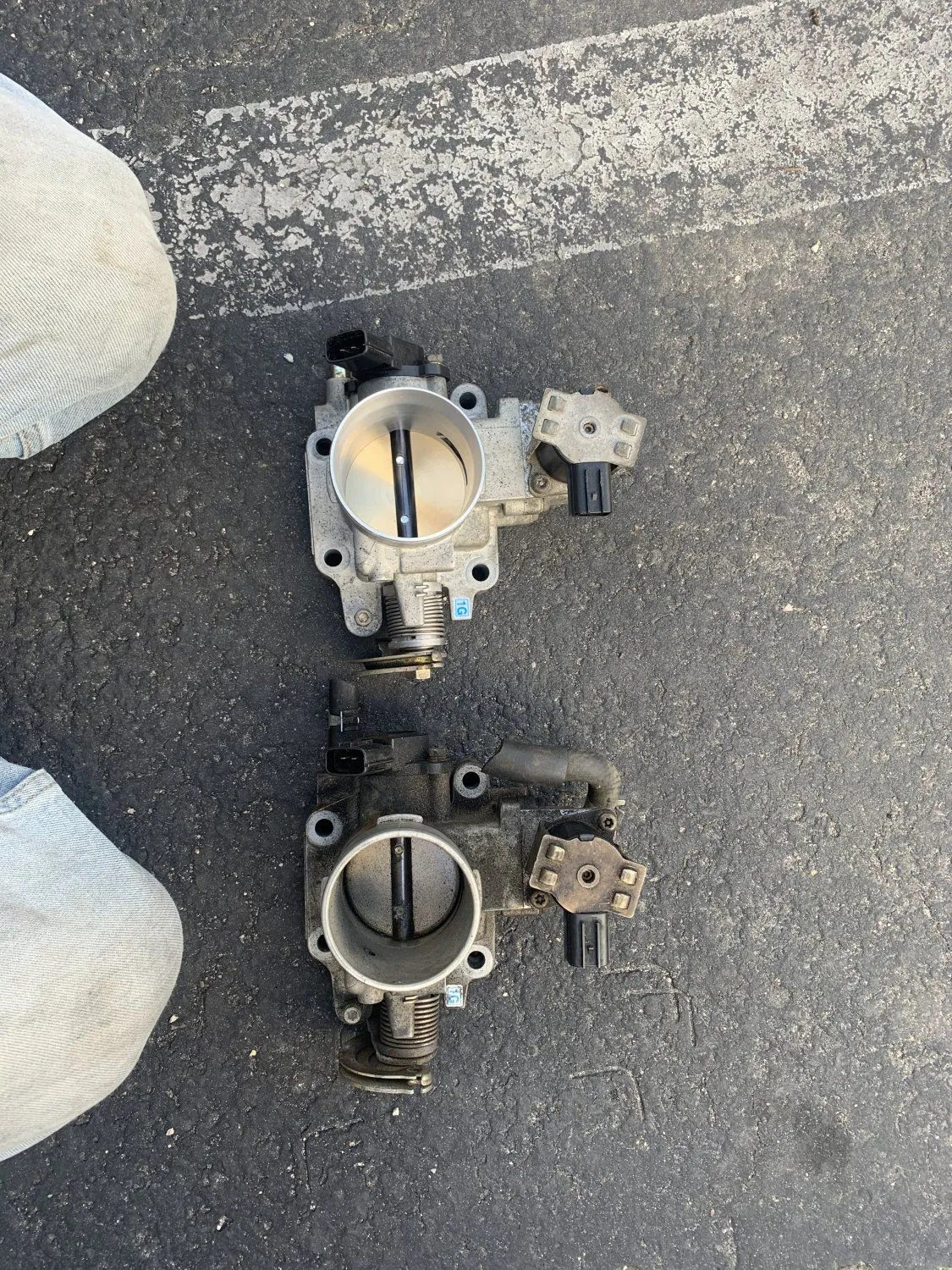

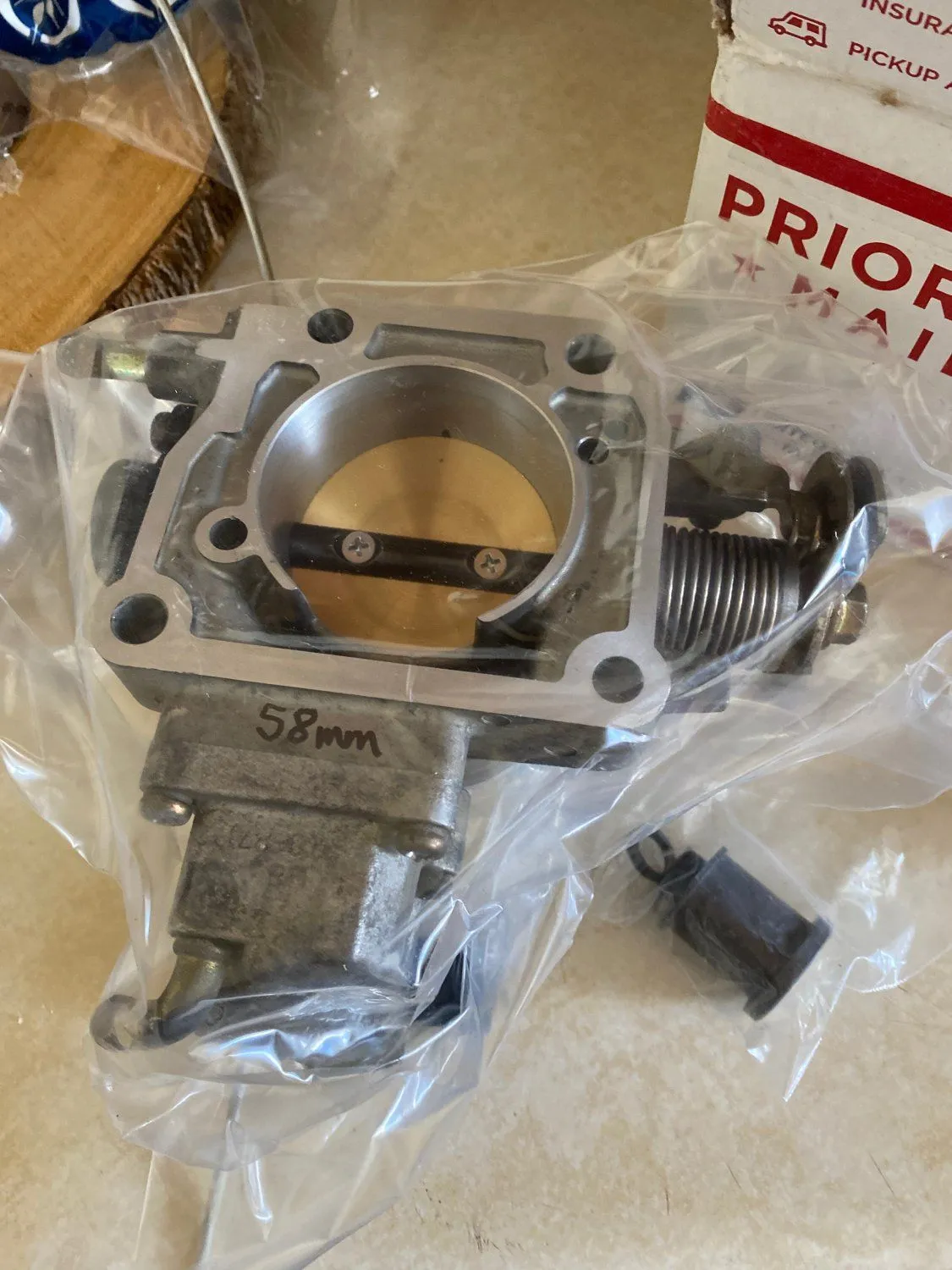

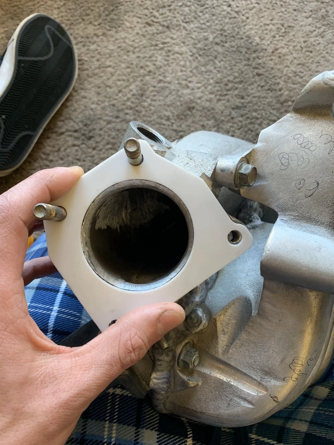

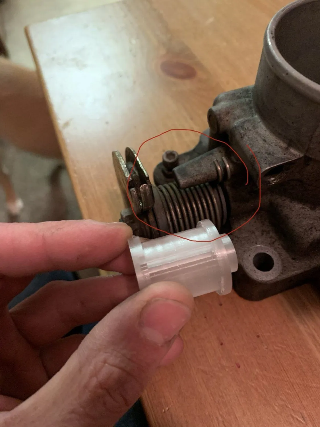

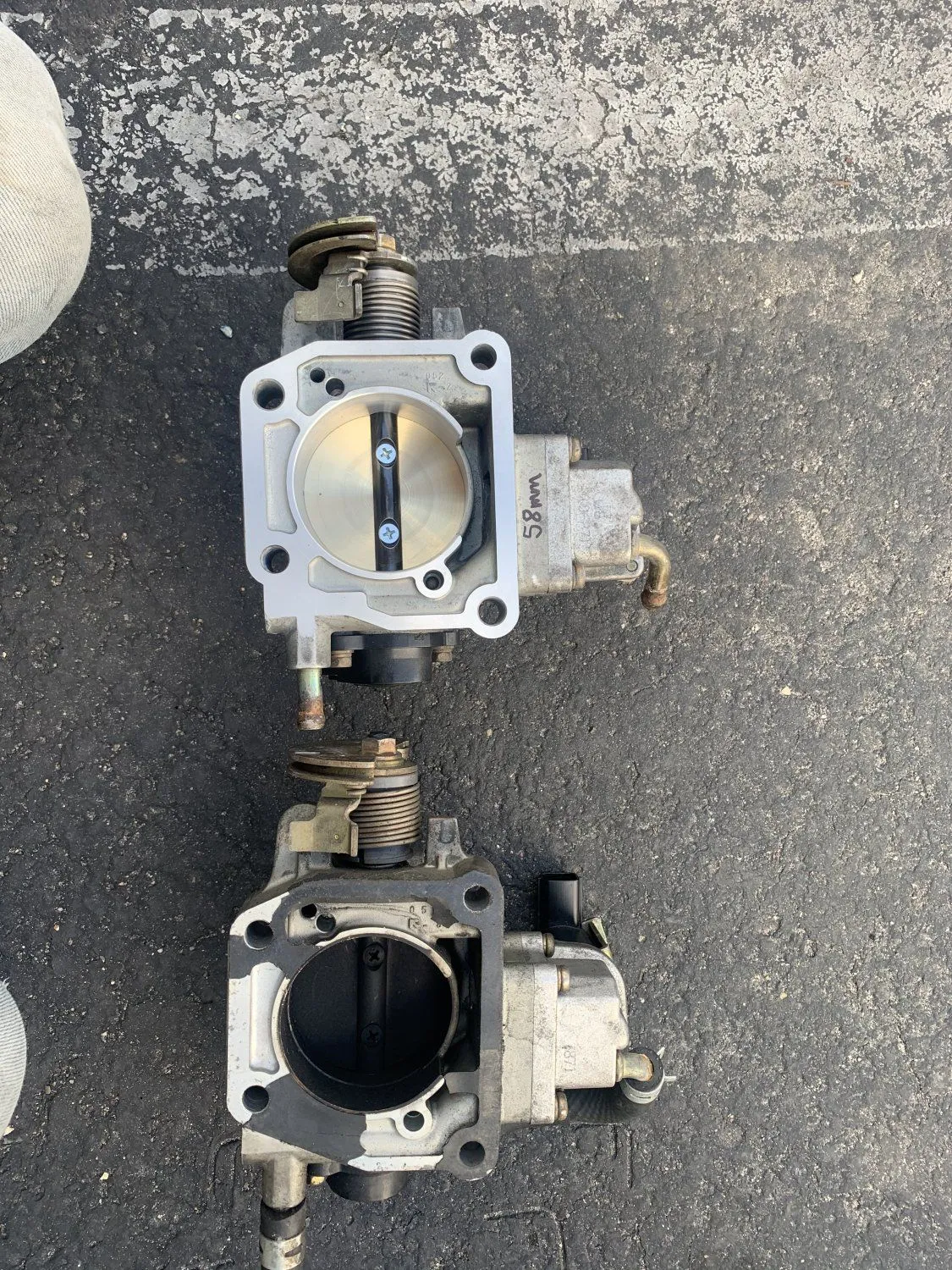

  • OEM throttle body ported by maxbore w/ Rev.13 throttle body gaskets
  • Hydra thermal spacers

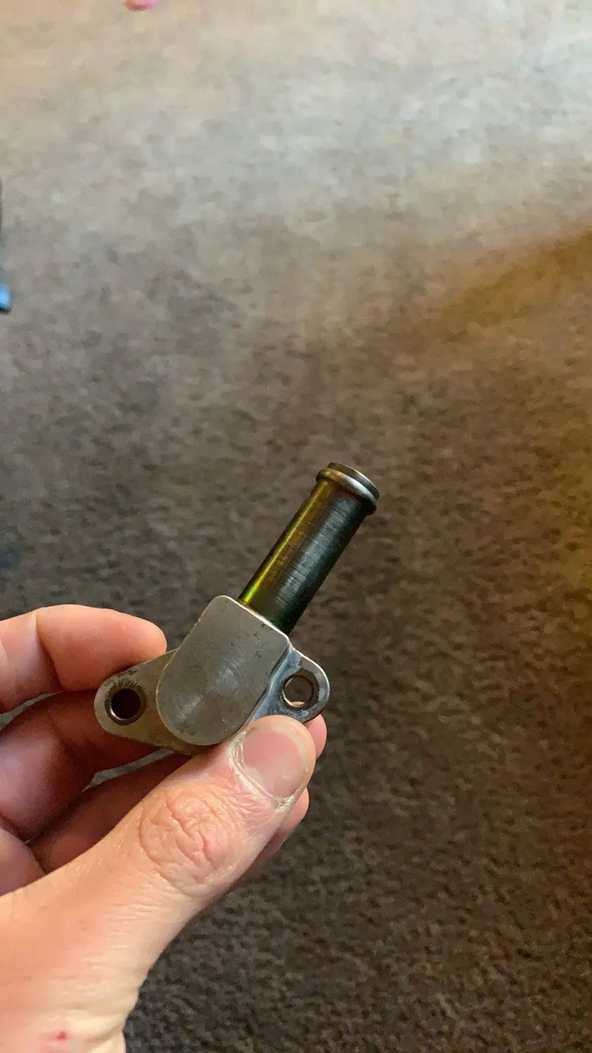

:cool:Throttle body coolant line delete and shaved​
  • 626 injector seal bushing, new o-rings, new filters
:cool:Big three​
  • Sr Motorsports alternators pulley & water pump pulley
  • Medieval v3 power steering pulley
  • Hydra crank pulley
  • NGK wires and one step colder plugs
  • Mazda millennia type s pvc
  • Medieval air diversion panel
  • Hydra battery tie down
  • Full race vacuum block
  • Carbon Miata oil cap
:cool:626 valve cover, Toyota coil on plug conversion, drilled out, baffled, with -8 an fittings, cam sensor clocked, shaved​
  • Harnessed performance coil on plug harness
  • Haltech elite 1500 (waiting to be installed)

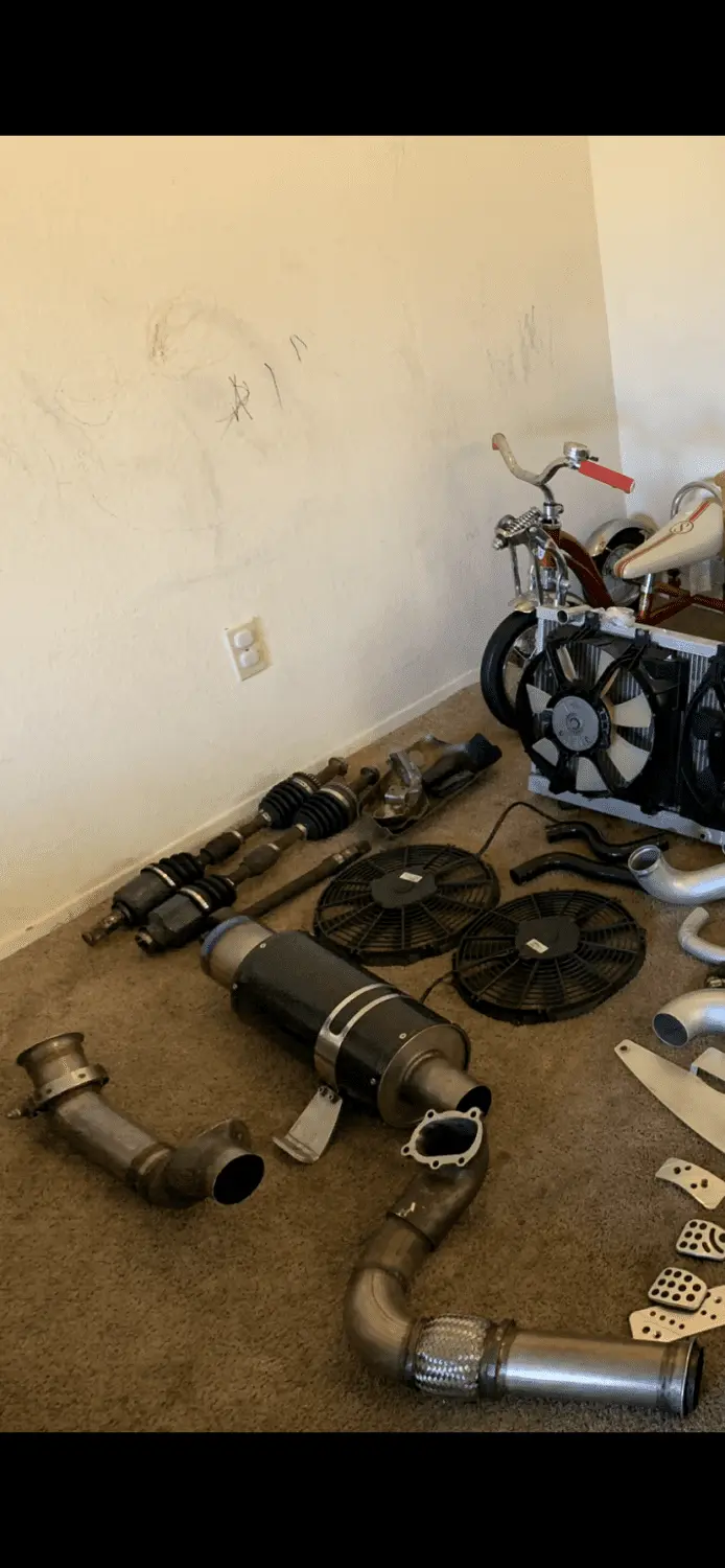

Parts I plan to fab or buy
:cool:Battery tray/oil catch can, Northstar Amg battery​
:cool: New turbo manifold, downpipe, intercooler, rad​
:cool:Coolant overflow​
  • 505zoom v3 intake manifold

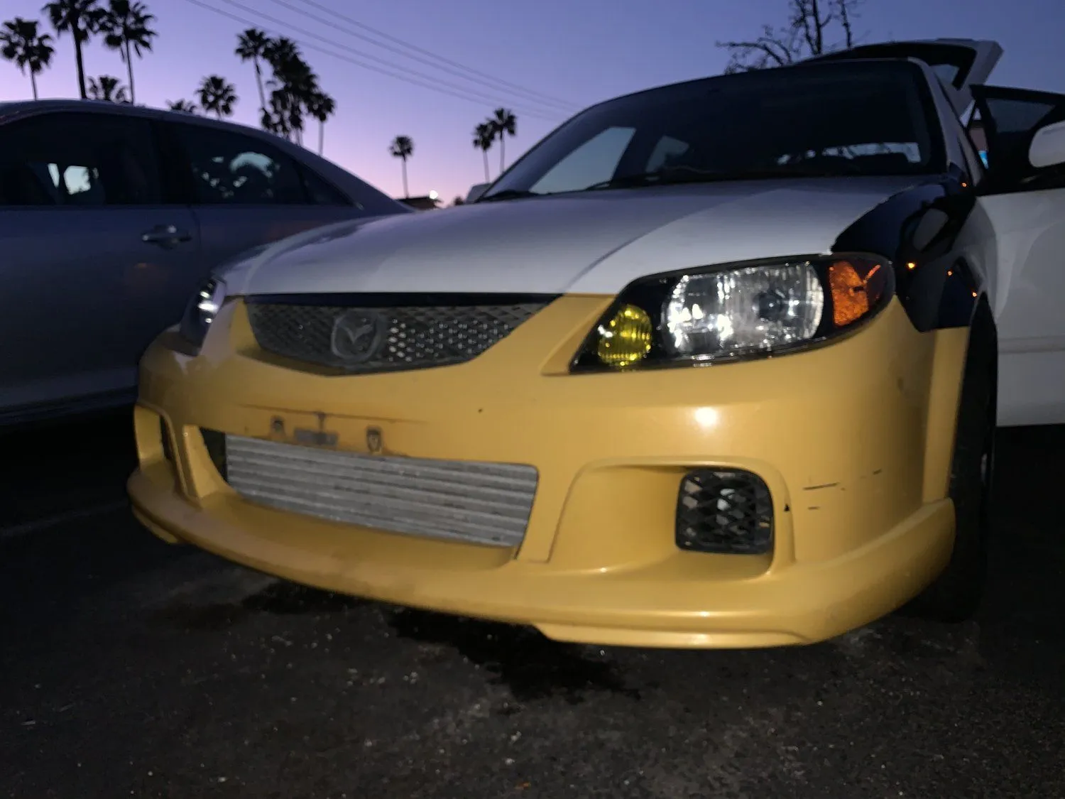

  • Mazdaspeed front bumper and Lip

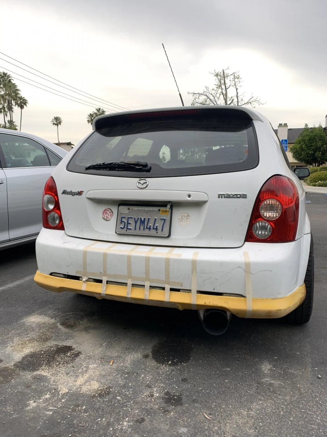

:cool:Trimmed rear bumper vent w/ 03.5 Msp lip (still work in progess)​

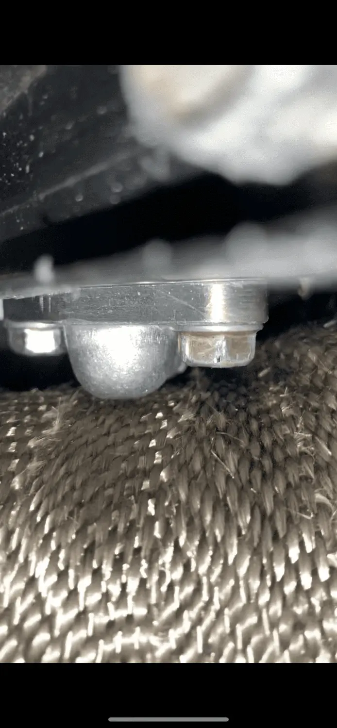

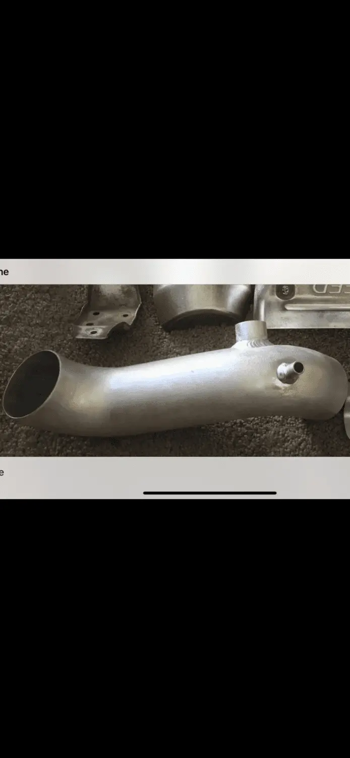

Oil dump return milled and shaved to clear dp
OH SO TIGHT!

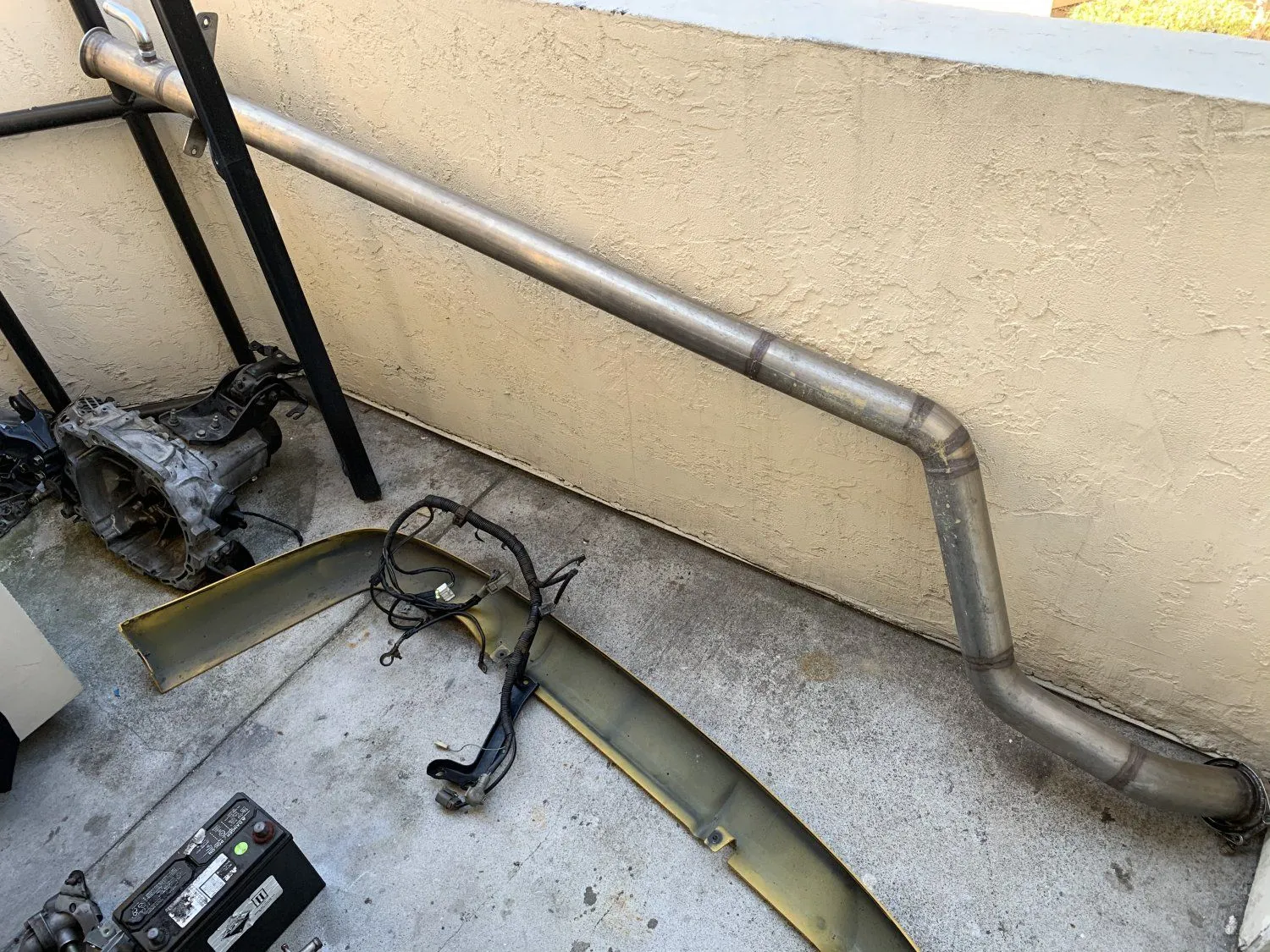

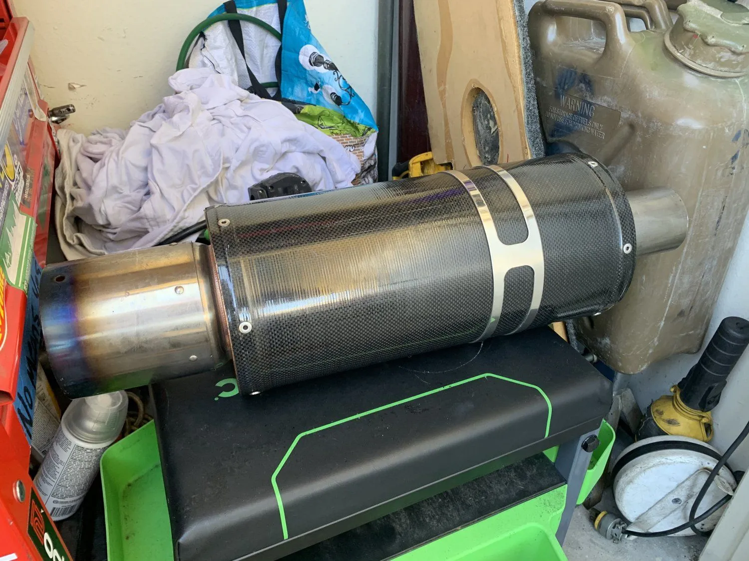

AMF custom 3” exhaust originally made for an Msp I had to refit the muffler. Stainless v-band clamps and the hks carbon ti
