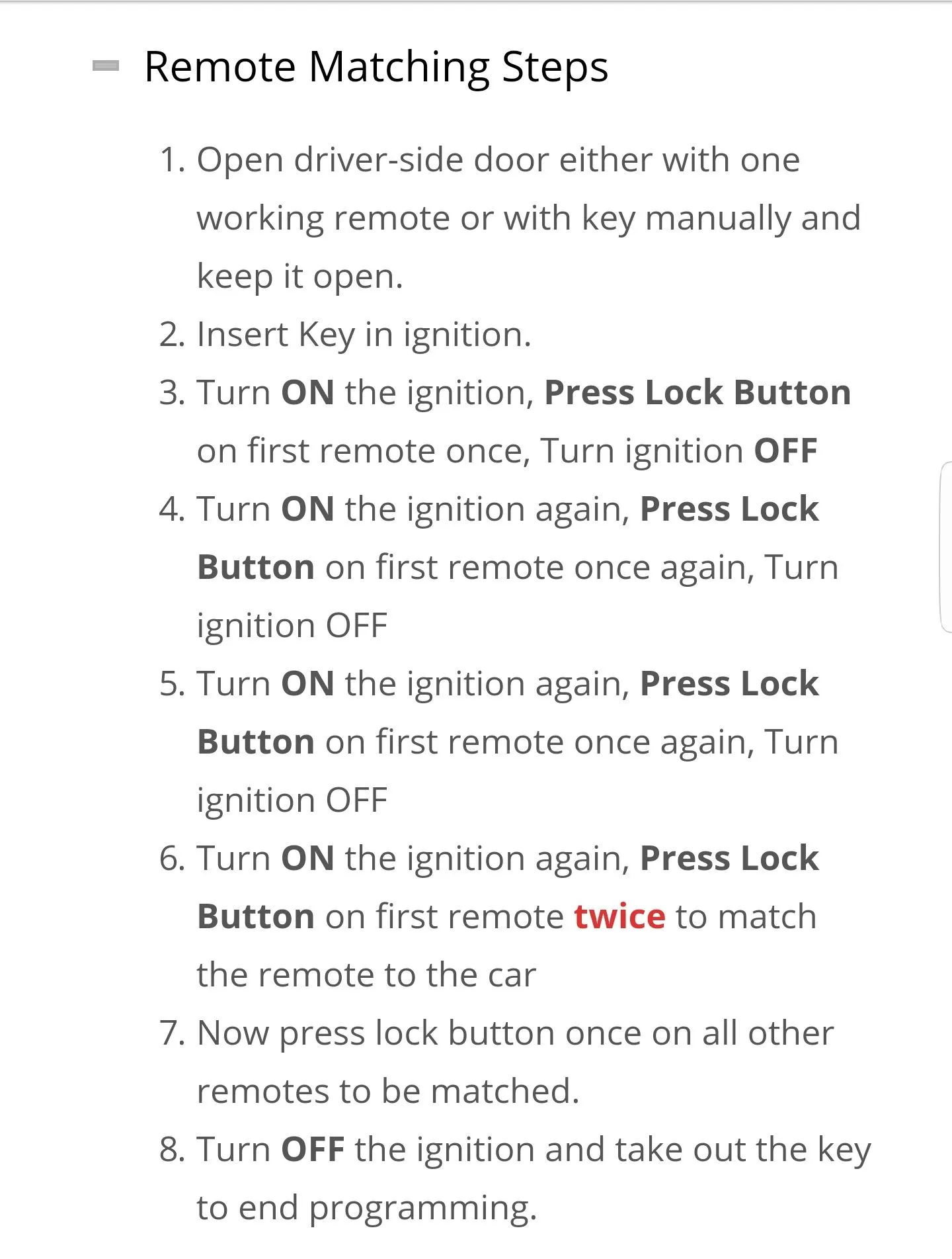

Hi Guys i have solution to your problem with Car Remote Programming , Got New Remote today and programmed it successfully please find attachments and follow the instruction to programm your new remote ,
Thanks
