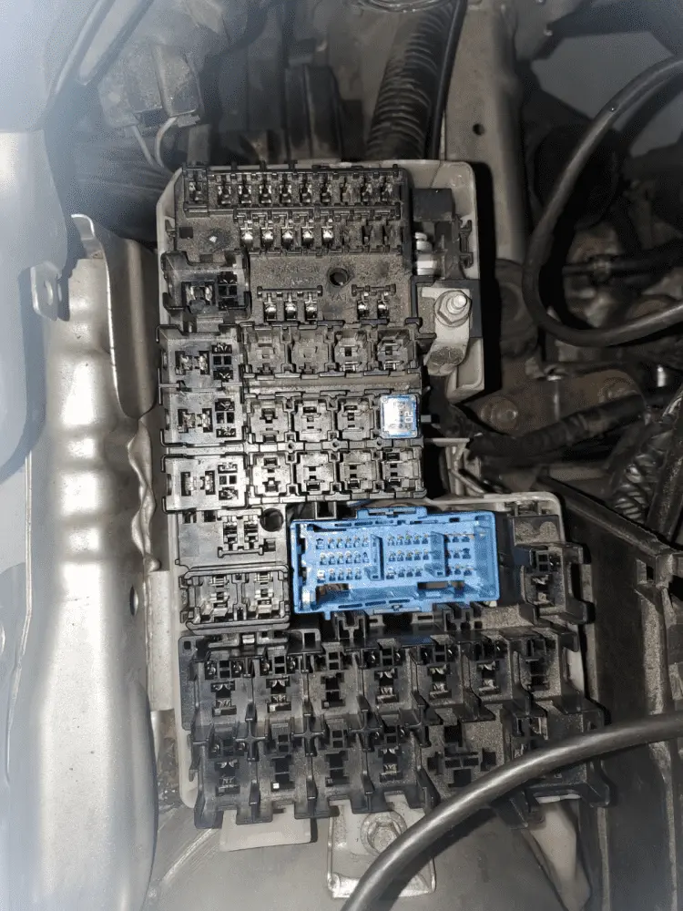

- But I decided to remove all the fuses under the hood, again, and the ABS-V give me a hint, the power is dropping when I disconnected it (I thought it didn't change anything the first time I did it but I might missed that)
Not sure what the net step is. :unsure:
Thanks
Weird. Next step would be to hook everything else up except for that ABS-V and see if the dash goes crazy again.
So I'm wondering if I don't have a spirit/ghost in this car...
I plugged back everything, also put back the ABS-V and ABS-P (both of them where dropping the voltage) as didn't really make sense...

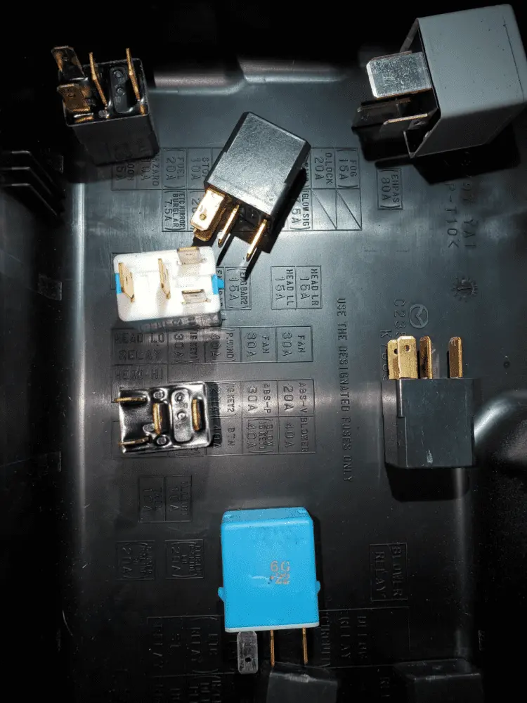

- I removed the a few relays and fuses and by just removing the Glow Ig Key1 40Amp (not sure exactly what is it), the car stop flickering, but I couldn't start.
